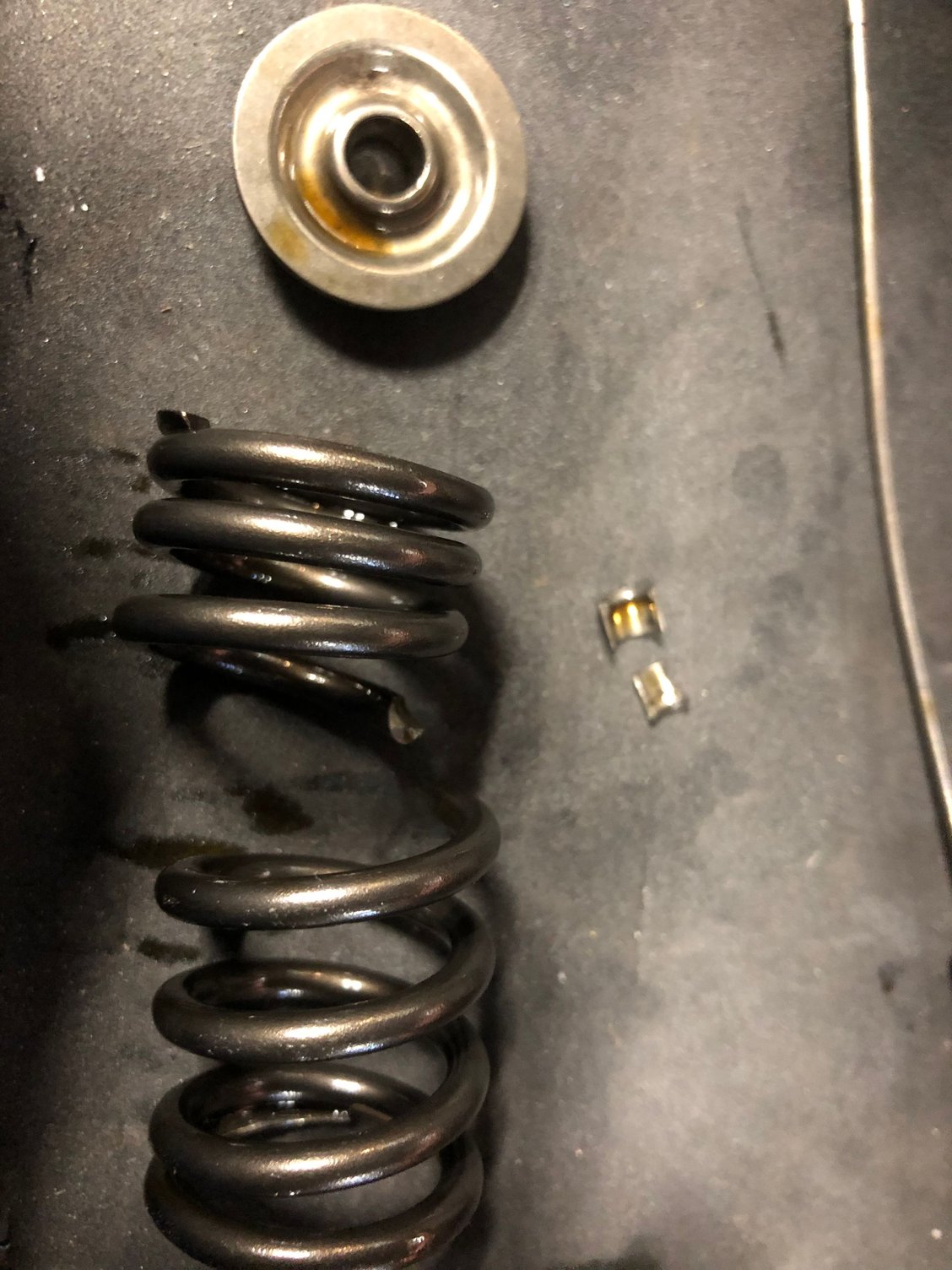

Valve spring
Hello, coincidentally, we are just working on the same problem, ticking sound in cylinder head. Found out it was a broken Valve spring.if it’s the exhaust side you can replace it from above (without taken the engine out) . Just by putting. Air pressure on the cylinder. Check valve clearance!
valve spring Costa less than $20. The sound in The video makes it look like more broken valve springs.
see picture off the valve spring. Also the dealer in Europe didn’t see it. This engine had the same Noice.
Dealers are smart and they have resources. If it was a broken valve spring they would know. It’s not that difficult to diagnose. In that case they would fix it and price the vehicle accordingly.
As others have said, if you purchase this car be prepared for and engine out rebuild.
