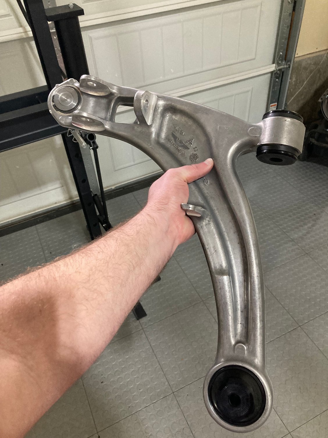

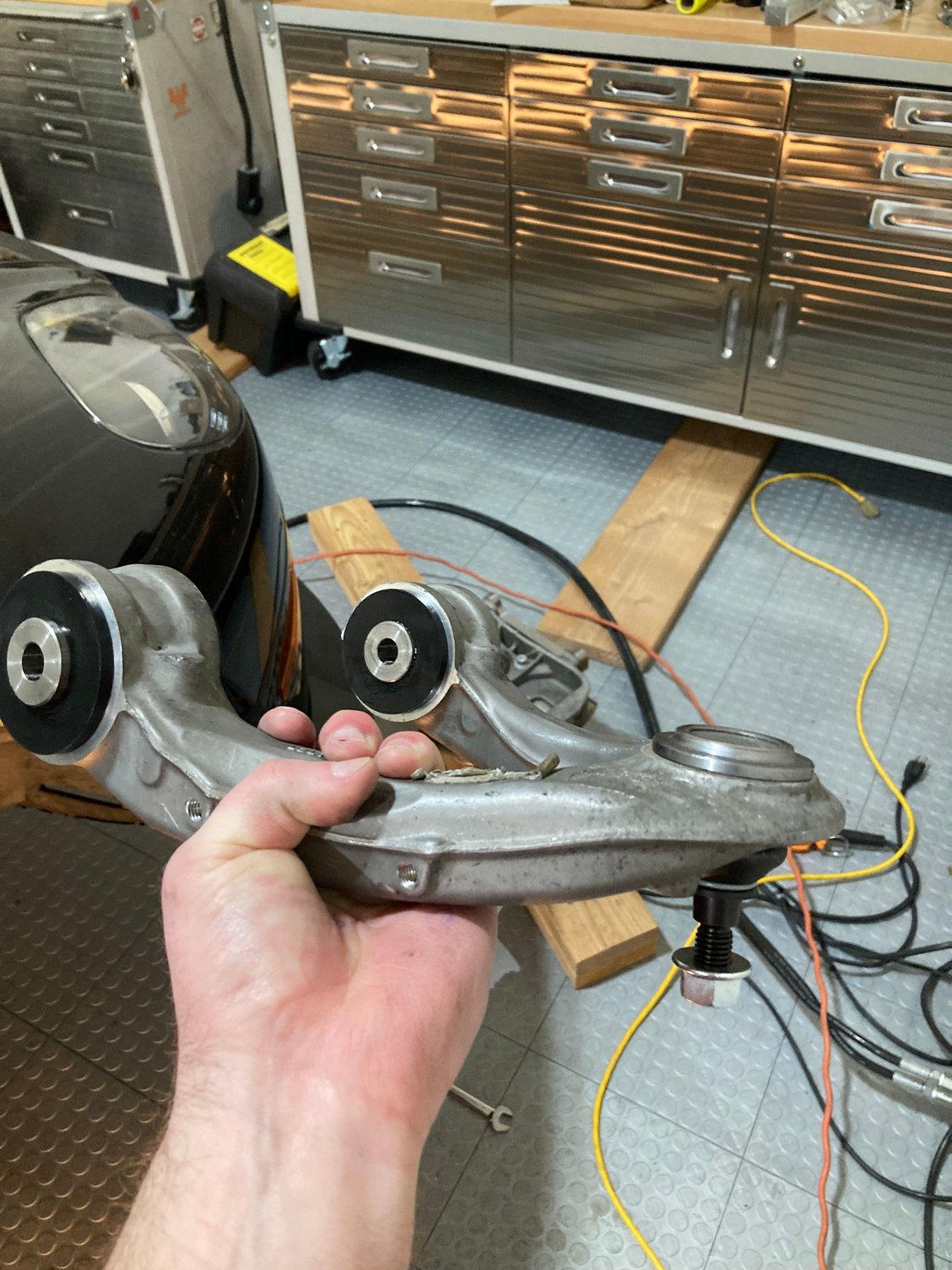

The only issue I came into on the install was getting the lower ball joints out of the knuckles...I've changed several ball joints in the past but these were extremely stuck, a sledge hammer would probably have broken them free but I didn't want to risk damaging the knuckle so I resorted to cutting them off. After making this commitment I decided to do a full rebuild of the front suspension, all new polyurethane bushings in the control arms/swaybar and new ball joints.

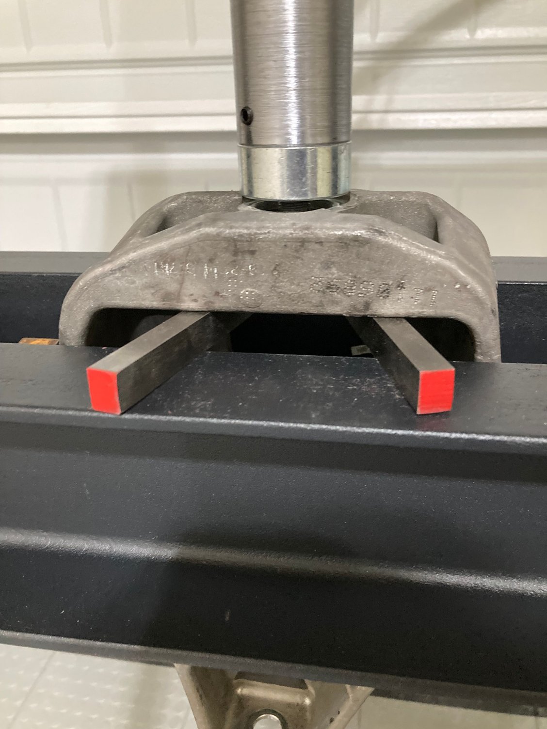

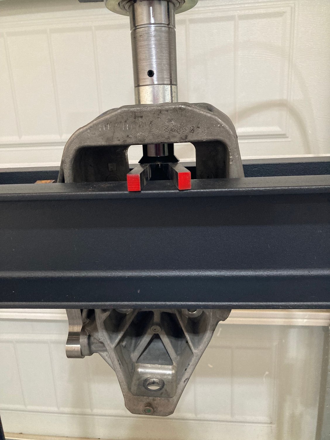

To press out the old knuckle inserts I ended up getting a 12 ton press, made easy work of removing the old and installing the new inserts, also really handy for the control arm bushings. Here are some pics from the install, minus the stuck ball joints it's really not that bad, aligning the car is daunting but this was my second time doing an alignment and it's definitely easier the second time.
Pressing out the old bushing using the stuck portion of the ball joint

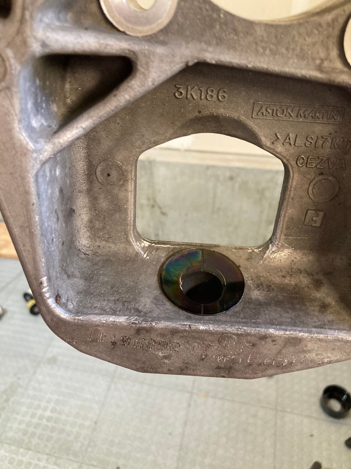

Pressing in the new bushing
New bushing installed, make sure the hole is to the inboard side of the knuckle to enable max camber gain
Upper control arm rebuilt
Lower control arm rebuilt

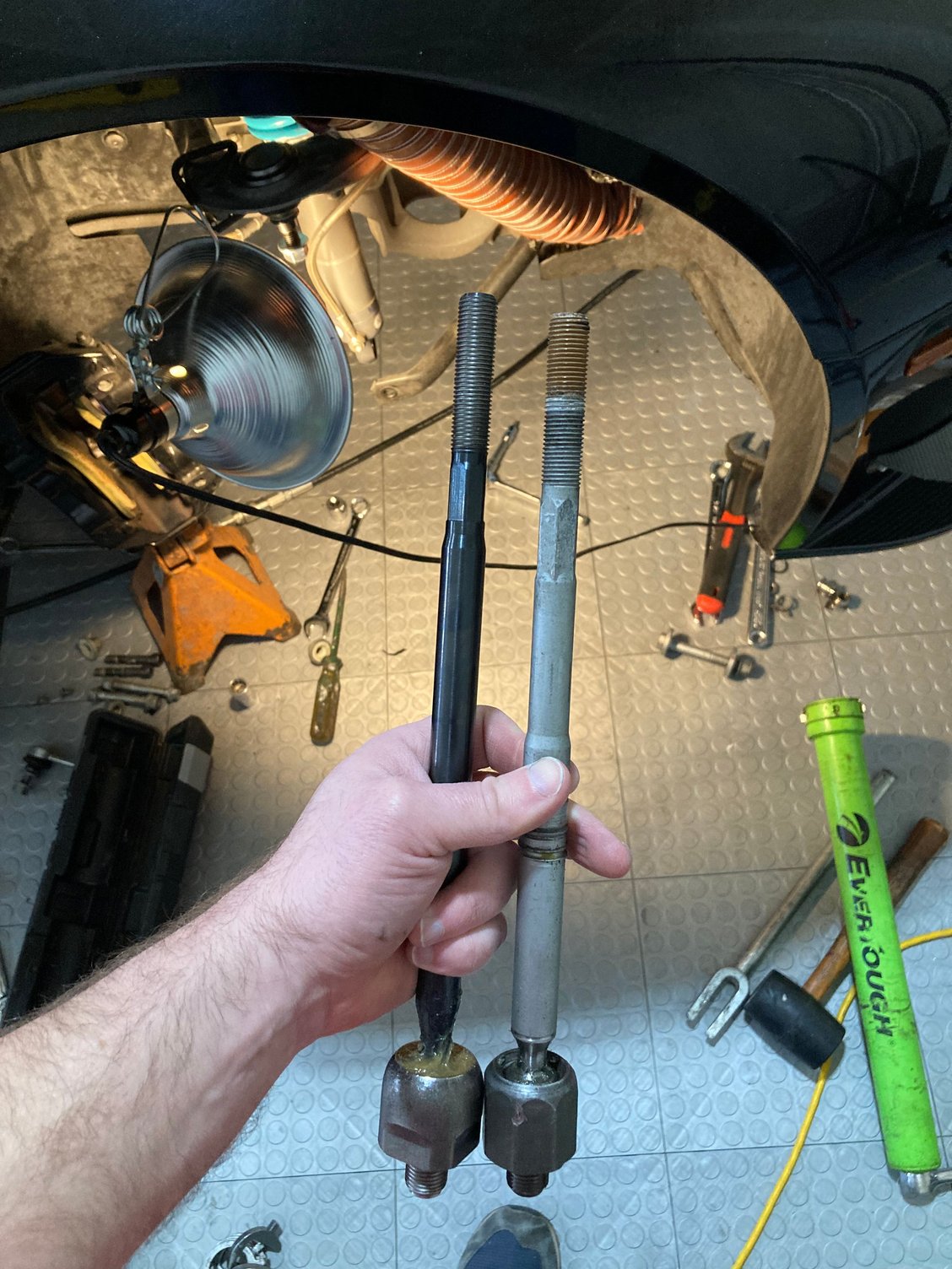

Extended inner tie rod to account for extra camber

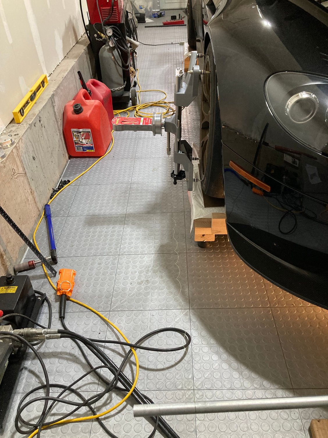

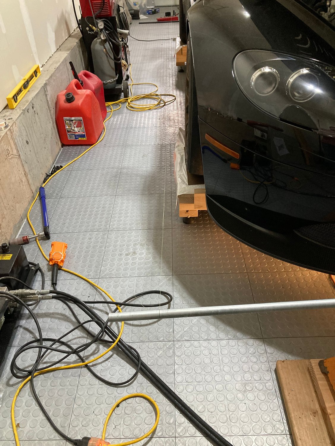

My garage has a slope to the floor so I built some leveling stands using slick melamine shelving, melamine board, lots of 2x4s, and leveling feet.

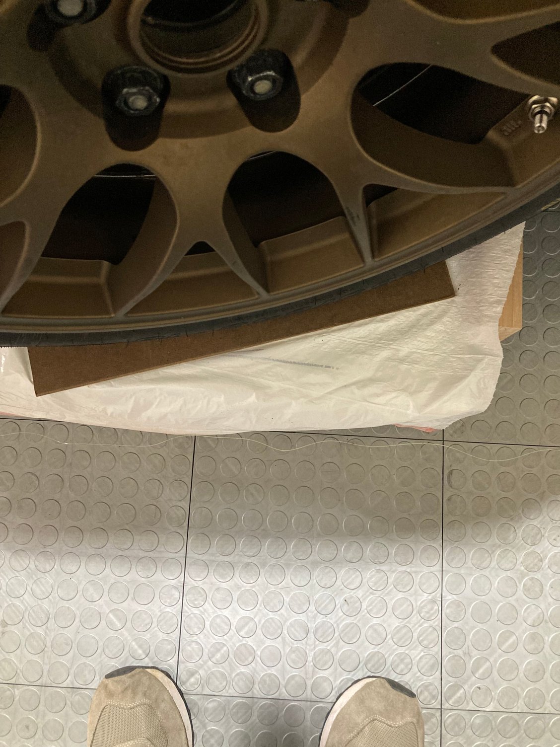

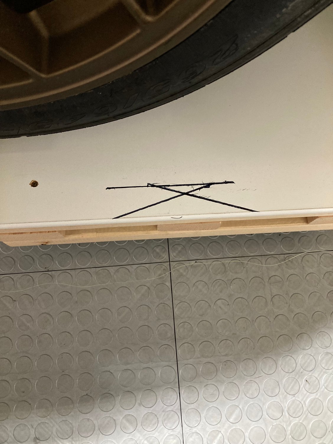

I was able to rig a makeshift turn table using a thin piece of melamine board, under the tire there's anti-slip strips adhered to the board to keep the tire from slipping when turning the wheels to get caster. I had to add a trash bag between the "turn plate" and stands because the shelving material wasn't slick enough to allow easy steering rotation.
Measuring caster was a little tricky because I have steering stops that prevent a full 20deg turn angle. Marking the edge of the plate at each steering maximum it looks like I have about 14deg of rotation in each direction so 28deg in all. There's a cool SAE paper that shows relations between camber and caster, by just measuring camber at each steering extreme you can calculate caster. My calcs came out to about +7.4deg of caster which should be good for stability.
Dialed the camber into -3deg on each side
And lastly got the toe in line using the string method, I shot for about 2mm of toe out.

were the inner tie rods custom made or a generic match.

I’m not sure, they were supplied by Valiant Ecosse. For the tie rod ends, an Opel Frontera matches so I picked up a set of those while I was at it.

were there any part numbers on the inner tie rod shaft. as you know ,those things are not available on there own under the AM part number
and the ones you have probably could be used in normal replacement also. as opposed to the other method of having the ball refurbished $$$$$

I didn’t see any part numbers on the old or new ones unfortunately. However, I bet if you took one to a decent part store they could find a replacement that would work or just find one with similar measurements online. So long as the threads match, there is a little bit of wiggle room on overall length.
