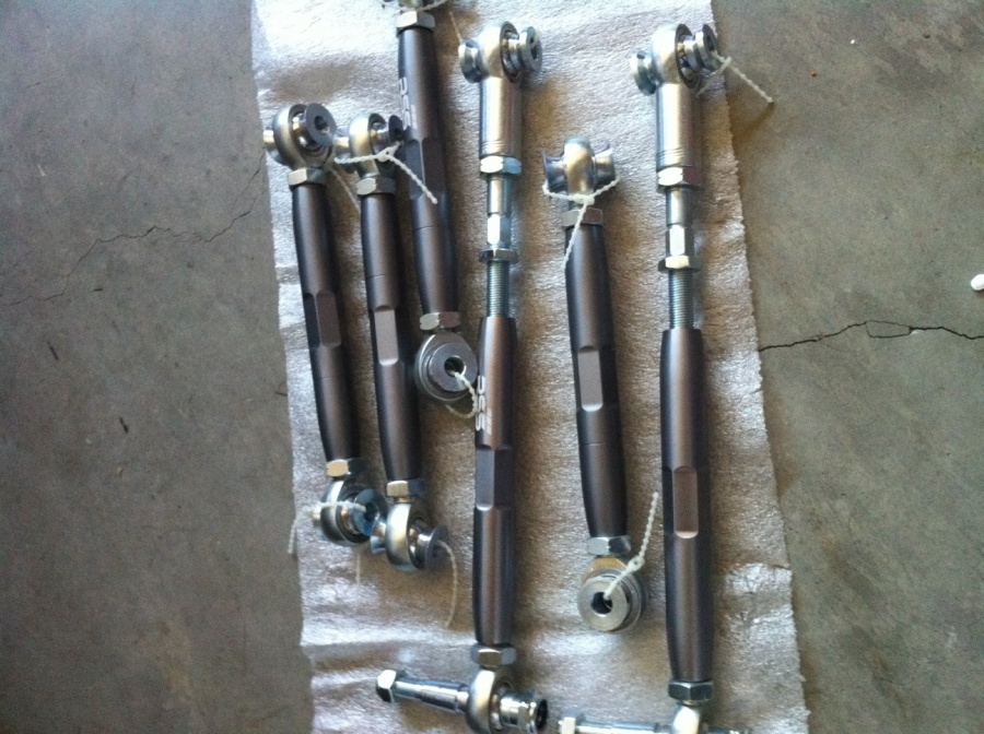

Installed some RSS Upper Control Arms and Lower Toe Arms

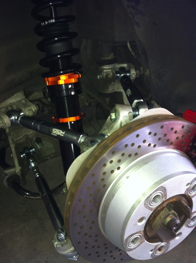

I put my k-sport coil overs in and got it aligned and corner weighted. Inevitably the rear camber was unable to get with in spec and sat at about -2.4 degrees or so (mainly due to the ride height I chose)
I decided to put in RSS kit to solve the problem. Install was simple and a breeze - 30-45 min start to finish. I have the rear re-aligned and it came within spec no problem and they were even able to do kinematic toe adjustment with this setup which is nice.
Looks, fit and finish are excellent. Ride is a little stiffer in the rear - little more road feel with the hard mounts now - but with that it give a more confidence feel in the car and the rear end.
And even better I wont be eating through rear tires in under 5K and get some more life out of them since I can run literally any camber spec - I ran stock for now.
Couple of hints for install (to keep it as close to its current alignment before going to get it aligned)
- Once you remove upper control arms, make the RSS arms the EXACT same length hole center to hole center (just slide bolts through then tighten them down then pop them in the car
- do the same for the lower control arm to get the ~length the same. Also mark a rough setting for your alignment bolt on the lower arm to keep it "as close" to where it currently sits.
- dropping the sway bar U bracket on each side helps get access and allows you to pull the lower arm bolt out easy.
