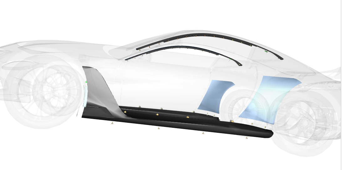

I found this online: https://lamin-x.com/aston-martin-van...ch-guards.html , and they said it’s about 22” by 21” which should cover the affected area perfect so for $89 less a 10% coupon I’m giving it a shot first!
laminx also sells sheets of ppf I can try to cutout my own desired area…not sure I have the skills for that and the precut ones should fit the area I need perfect. Now, whenever my z06 comes which will be mostly track use and I am sure the ppf bros want $10k to do a whole car ppf, maybe I’ll look at those rolls again…

The laminx rear wheel arches ppf pieces look perfect for what I’m looking for. They come with a spray bottle and squeege and instructions and will fit and over the entire rear wheel arch panel from the side sill up to the body line above the top of the arches is where they are cut. I think this will be great coverage for the rock chips and blend in just fine (unless you are the type of person seeing a ppf line is going to ruin the beauty of the car and need it wrapped under panels and seemless — which in this case probably requires a full car ppf wrap for $7k).
I’ll share a pic when I get them installed in a few days after I have time to do a little more dr color chip.
This is by far the most affordable/easiest solution to this problem. I was told $500 to add on the rear wheel arches by a ppf shop only after (as a special price) I paid $3250 for full front bumper and hood and pillar/mirror coverage. These were $80 with a 10% off code!
eta: I cut the one on the left out to roughly what the ppf piece looks like to see how they would fit — this is obviously precut by them and you just peel it off the big backer sheet, spray both sides with dawn/water and apply

Took 10 minutes to put the first piece on having never done this before. Process:
1: spray dawn + water (shake first) in the provided bottle on the adhesive side, slide it to place
2. When in place spray outside of ppf (so squeege slides nice) and use provided squeegee to push fluid out from under starting at middle of piece. if something gets messed up just spray it more.
3. When you get to an overhang piece for the edges, use a hair dryer to heat it up and wrap it around until it sticks. Not sure why this part was not mentioned in provided instructions and it does overhand by 1/4” by rear tire to nicely wrap it around.
4. the bottom right was the only part that didn’t instantly stick well. Required a very little hair dryer and to push to the right while also squeegee down.
it looks fantastic, you cannot see the cut line alone the crease above the tire from 3ft away at all. For $80 and 20 minutes this is a no brainer fix. it’s too bad lamin x doesn’t have these cutouts for more cars, but perhaps I’ll diy an expel ppf when my z06 comes (track use lots of rocks from sticky tires) which will be like $1250 in ppf materials vs $4k at a shop (expel does sell the ppf kits online).
