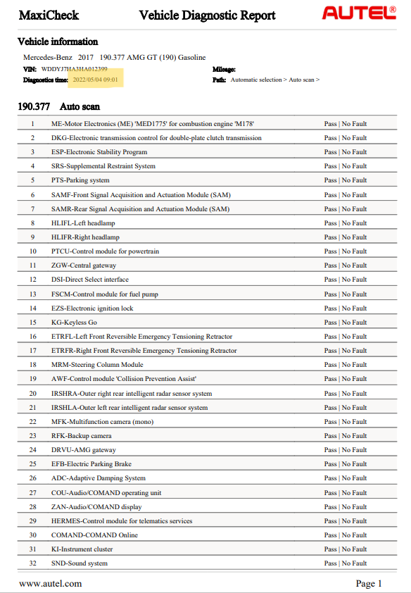

Yes, one of my favorite tools is an Autel Mx808. I used it extensively on my AMG GTS. it read every module and I could reset many functions.
If I had the V8 I would try using the MB settings but NOT try reading the VIN. Just go directly to diagnosis.
Here is a typical printout of a deep scan on the GTS
