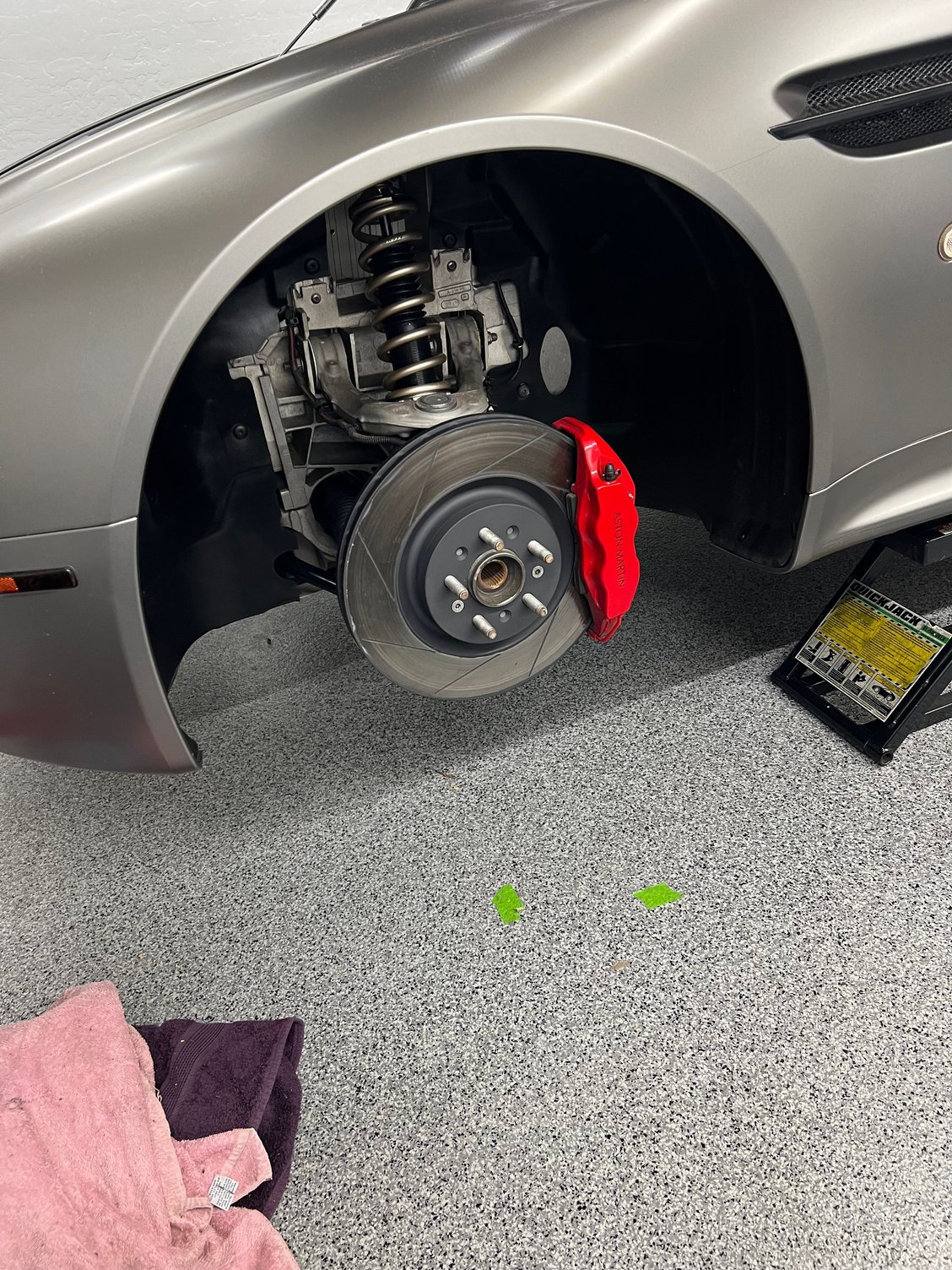

Yep. I installed the BCRacing with Swift springs setup a couple months ago. Allows you to be at any height and the damper setting is changeable by jacking up a side with wheel still on and turning the **** at the top.
It took me a week and removing the wheels maybe 20 times to get the height exactly where I wanted it.

fantastic with the $300 swift upgrade. 30 settings from hard to soft. I’ve tried 10 to hardest and now am on 10 to softest. Will go in middle next to see what I like.
height is simple as removing wheel, loosening lock and turning the body of the coil over with a rubber grip.

Google rubber strap wrench. This is because the suspension gets in the way of the wrenches to turn the coil over. I marked the body with a piece of tape and turned with the rubber wrench. Super easy and after doing 20 times to get the height perfect you’ll be very good at it.
whatever you do though, do no break loose the collars under the springs. This is the preload. There are some videos that will explain it better.

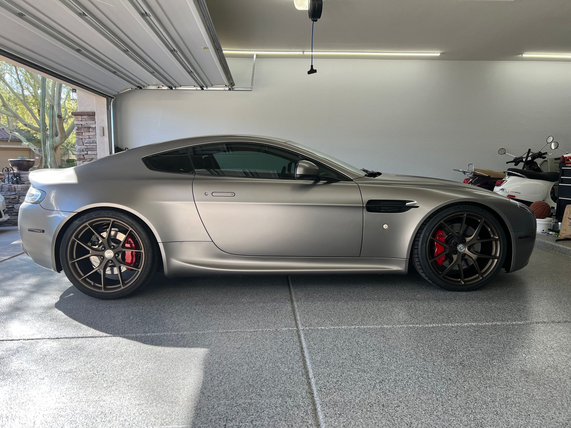

Yeah that’s true with any coil over and aftermarket wheels as I have. The manufacturers will set them at factory height but then it depends on how picky you are to get them to your taste.
wheels look great. specs?
