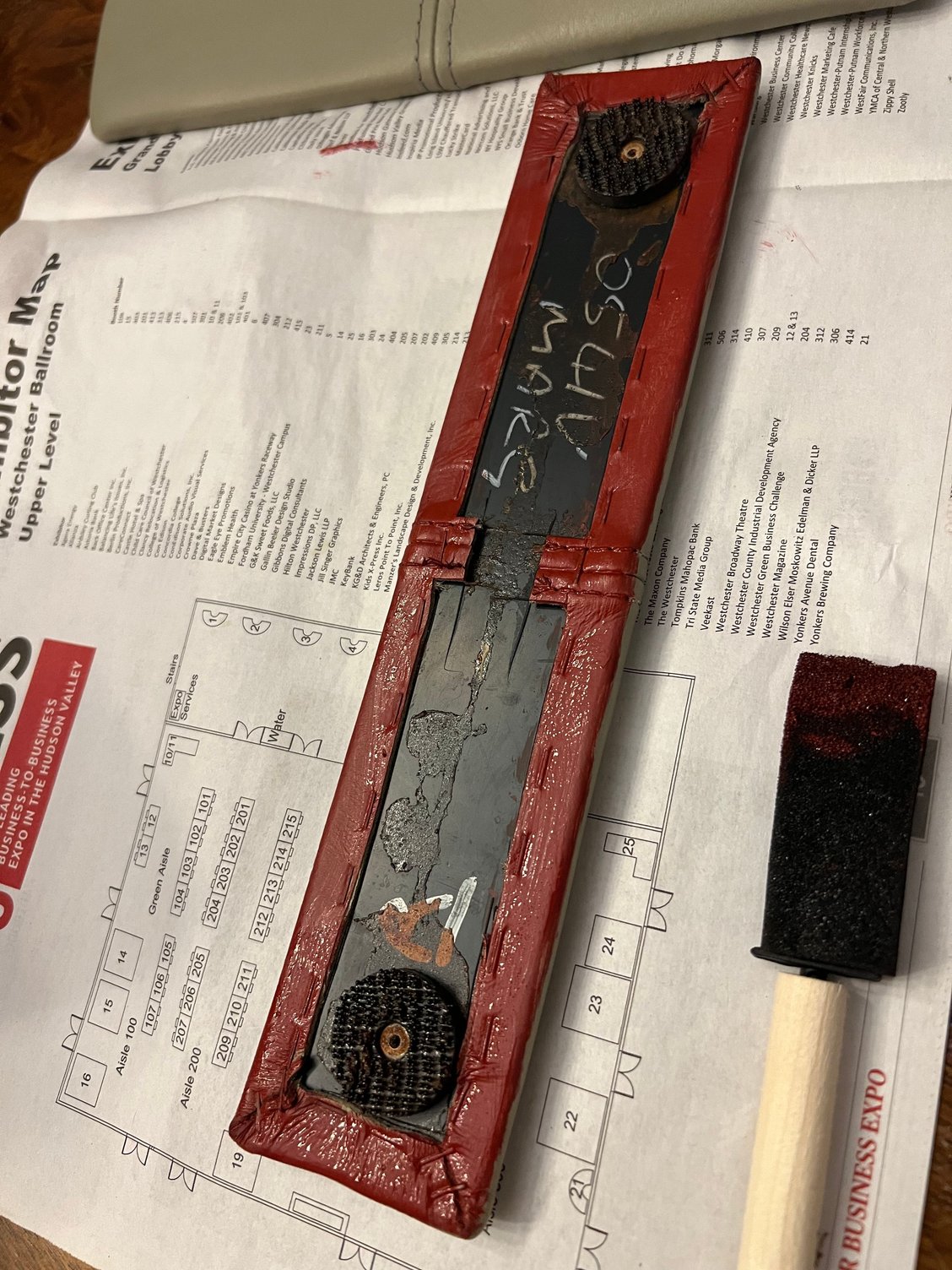

Couldn’t wait. Had to test a small area after getting some inspiration

looks pretty good. what are your doing for the stitching?
on larger pieces will you mix bottles together?

For these small pieces. I did a really good cleaning with dawn and warm water. Then used a scuff pad. Very happy with the results. I have a liter of color. Which is their largest size. It took 3 thin coats to get good coverage. But does not seem to be a lot of usage. According to their site it is enough to do an entire interior. So I was not planning on having to order more let alone mix.
We’ll see how that goes. As I am working from rear to front

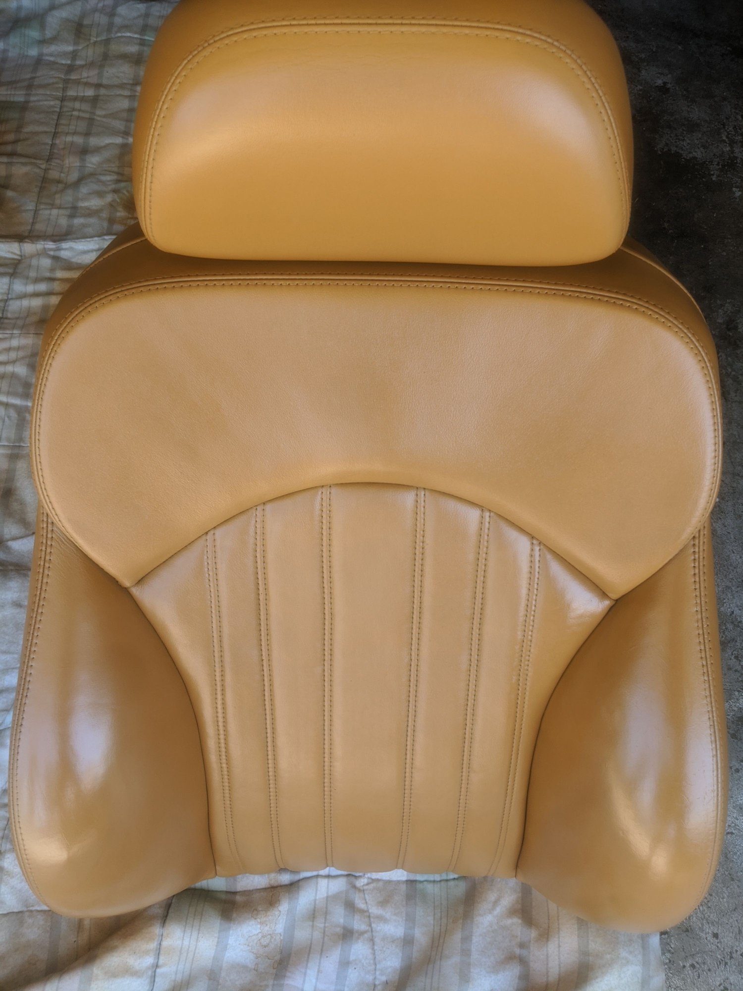

Great work. On my M5 I did something similar to restore the interior. I didn't do a color change (I should have once I found out how simple the process is). I used acetone to strip the dye, then used an air brush to redye the seats and finally used a clear coat. I used dye from furniture clinic. One thing that helped was once I had the process down and bought enough dye to do the entire interior at once to make sure there were no color differences if I bought the dye in separate batches. Aston leather is different but at the end of the day it's just leather. Just take your time and it will turn out fine. For inspiration lookup how people redye leather shoes, handbags and car interiors on YouTube.
Before:
After (Clearcoat was still wet):
Hope this helps!

That actually looks great!!!! Looks so even in the pics - is the coverage even in real life??
Will you be finishing it with something or is a dye job all you need?

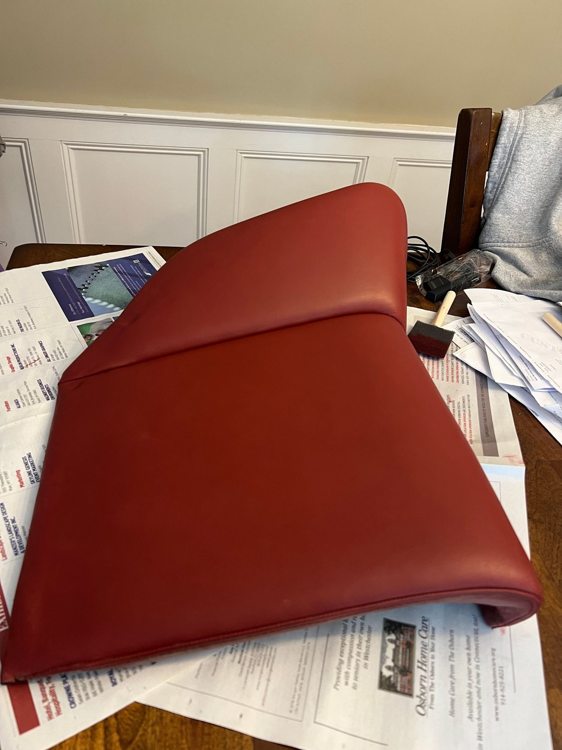

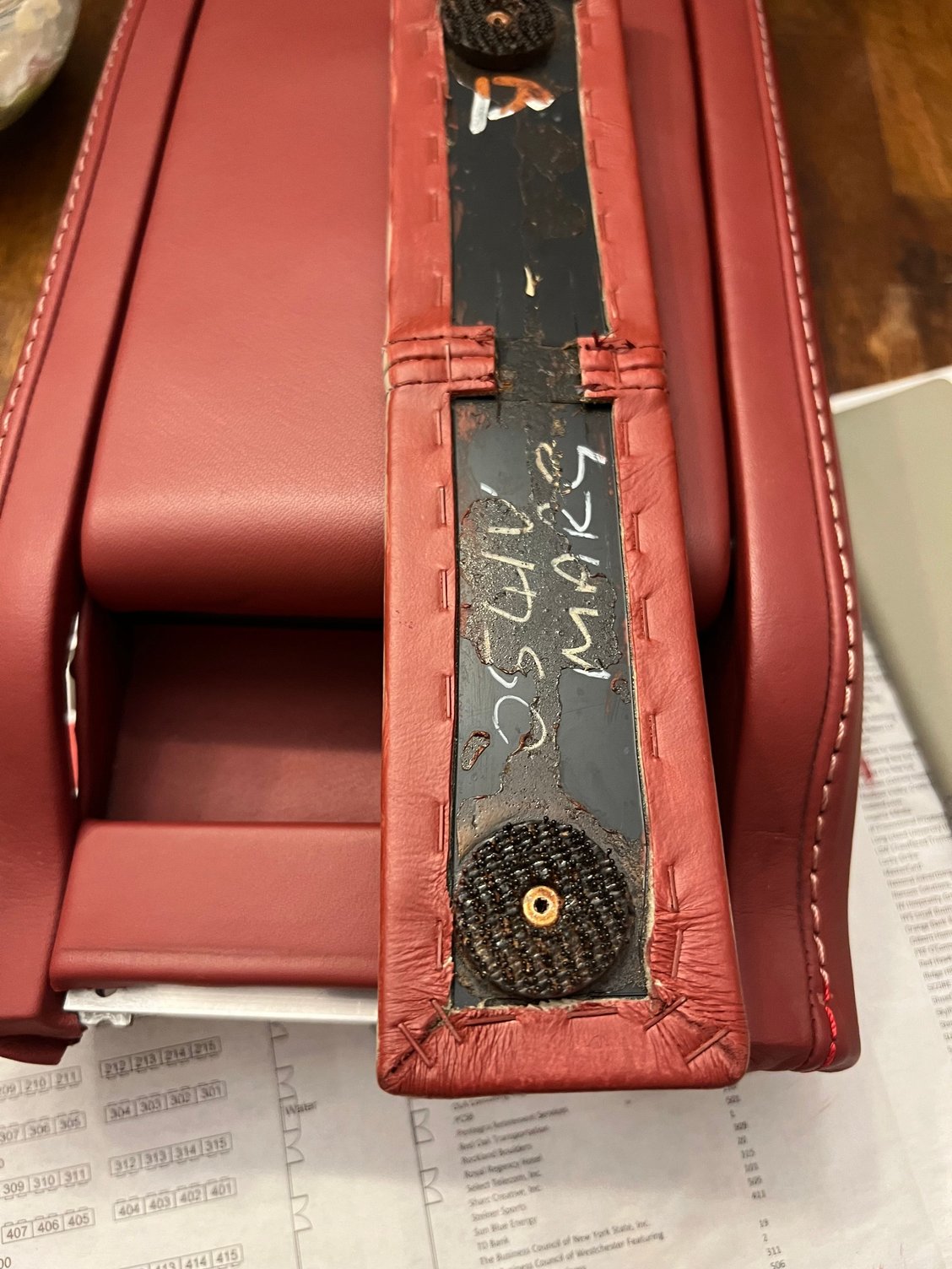

Yea the coverage is even in real life. Really pleased with this product. I have been using the supplied sponge to “blot” the dye. Then a blow dryer to dry between coats as recommended. But after dyeing a the bottom of the rear seat I feel it’s better to use an air sprayer to really get that professional finish. So I will work on complete removal of all the interior and prep so I can spray it on. But I’m very ecstatic 🤩 about the finished product!
800 grit scuff pad
Side by side
Looks and feels so supple
