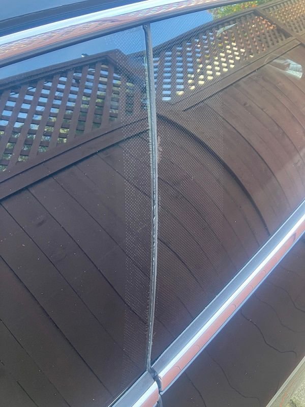

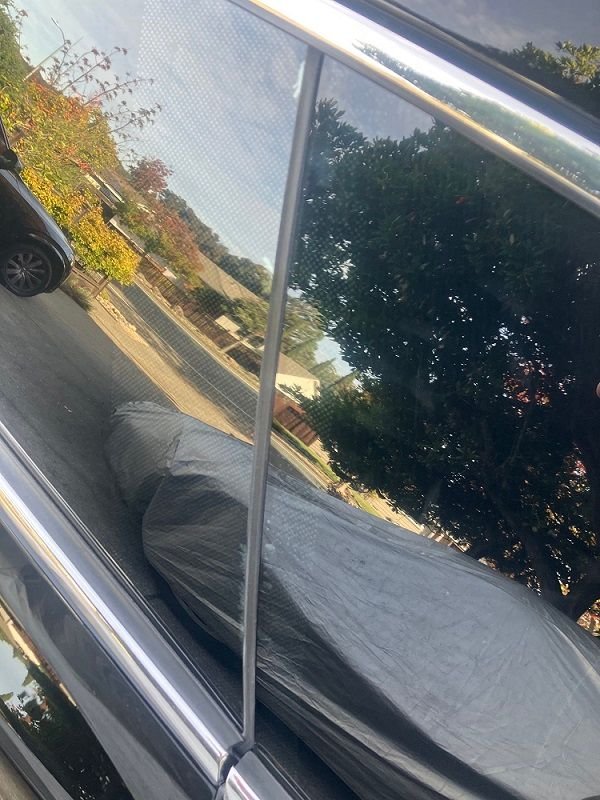

Good afternoon, has anybody ever replaced the rear window seal on their Rapide? See bad seal VS good seal pictures.
Mine needs to be replaced/fixed, and the dealer is telling me I need a whole new window...
The problem is it creates wind noises as soon as I hit 50/60 mph...
Is there an alternative fix?
Thanks in advance!
Bad seal:
Good seal:

Unfortunately the window seal is not sold separately and the dealer is right that you need to buy the entire window assembly...
You may be able to find a spare window at a yard and peel off the weatherstrip and use it

I’m prob wrong…but sure looks like a window miss alignment issue rather than a seal…could just be the pics…

I was hoping to find just that seal (even an aftermarket one or any kind of automotive trim) and install in place of the worn one.
I like your "find a used window" idea though.
What makes you say that? I can have a look at it, for sure.

It’s odd..but in the first pic..it doesn’t look like the two windows are in perfect alignment..could be a trick of the camera..looks off towards the top of the right hand glass…

are you sure it wasnt forced, like someone tried to open the door using a metal cable? you didnt got my message , didnt want respond?

The seller finally could provide where the seal goes and I think it's the same. The one that is normally bonded to the window is well available alone.

Just received the spare seal today.
So far it's looking good!
Now the main question is: What is the best way to bond the seal to the glass? Some kind of windshield sealant? Or what do you guys recommend?
