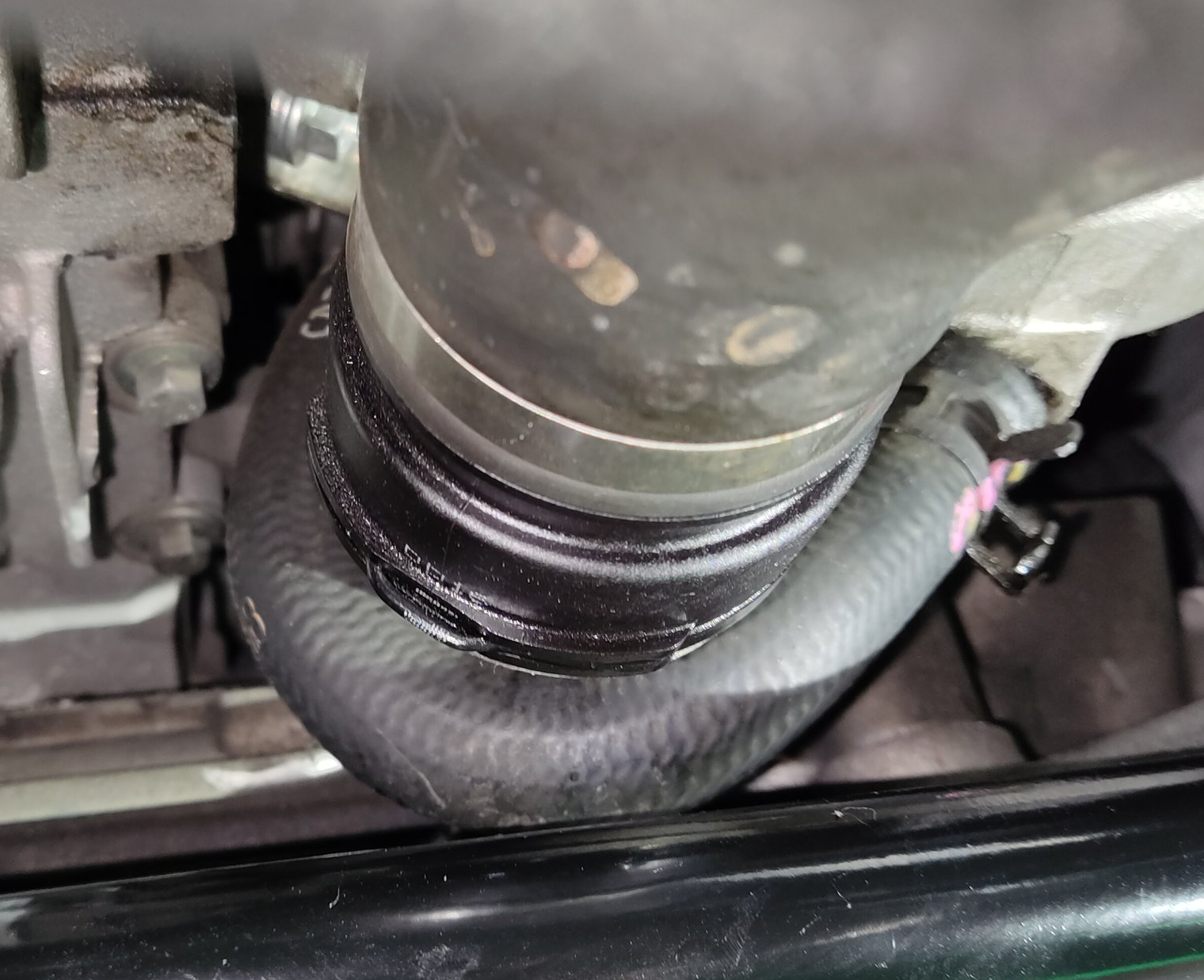

As I mentioned, my radiator doesn't have a drain valve, and also, there are no hose connectors at the lower end. However, the hose connects to the engine / water pump at a low point, so draining the engine by gravity is quite easy.
The hoses on my 2017 use push-install plastic surfaces with a metal locking wire, similar to BMW fittings.

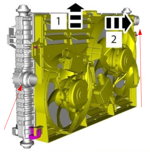

As you can see, on my 2017 the left side of the radiator where the return hose is located is 1/2 way up the side:
However, the left side hose connects quite low and so the block and 1/2 the rad drains out easily:

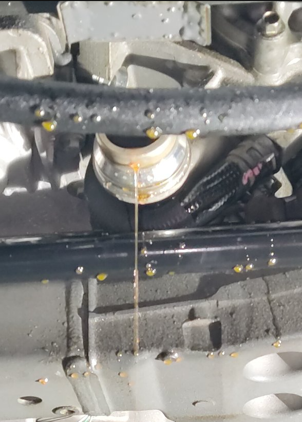

I evacuated the radiator through the top hose connector. Hose is easy to disconnect with the push-install and metal wire lock
The flushed coolant had quite a bit of aluminum (machining and radiator filings) and noticeable black rubber bits:

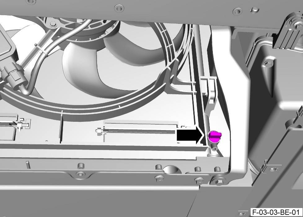

Good pics. I did my '17 V12V last year and it does have the drain valve on the passenger side rad. Will post a pic when I find it.

Mine must be hidden there then. The service manual shows it exists for the older model, but when it comes to my year, that step is skipped, so I assumed it was removed.

Takes a while to locate but mine has a yellow pen mark on it. Still a messy drain.
TBH, I was worried that the valve wouldn't seal properly. The lock was just a click. So far so good.
edit: just realized yours is a '17 Rapide S. Tagged the pic I posted for future reference.

Just curious for next time.
I just finished my coolant change and i didn't find that drain port.
Besides the belly pan did you have to remove other items for access?

Just the belly pan. I had to reach in a bit half an arm's length to turn the valve I reckon. The pic was probably taken with a bit of zoom.
