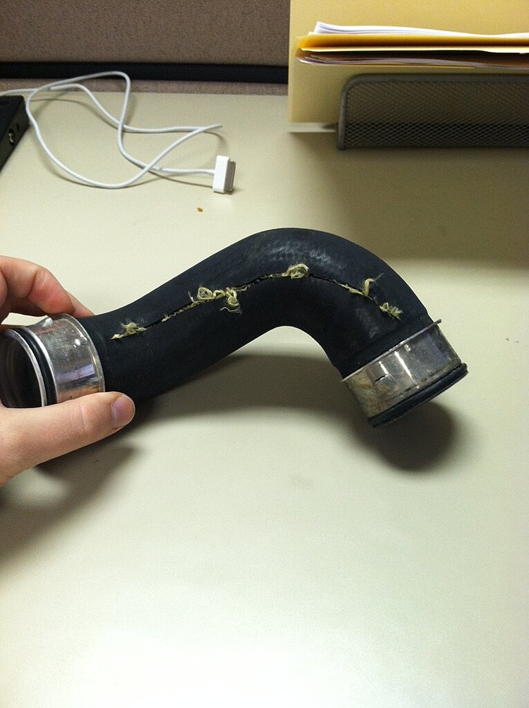

Not the end of the world, but a huge annoyance, nonetheless. I was driving around near my house about two hours ago and I floored it from a stoplight, only to look in my rear-view mirror and see a trail of coolant and steam. I immediately pulled into a community and turned off the car, as it was very apparent that I had a major coolant leak. Steam was billowing up from the rear of the car... not from an overheated motor (thank God), but from coolant contacting hot engine parts. I made sure that the coolant needle never went into the danger zone. I called my buddy and he came and investigated with me. We determined that the main coolant hose on the passenger side of the motor had ripped down the length of the hose. We went to the store and purchased some duct tape and distilled water. I filled her back up and taped up the tear, then limped her back (~1 mile) home.
Anyways, the up-side to this whole thing is that the hose is very accessible (after removing the airbox), so I'm going to knock this out myself and hopefully be back on the road soon.
Anyone else had something similar happen, or am I just awesomely unique?

I have heard that this hose and the companion on the driver's side should be replaced, along with the one that runs from the water pump to the coolant tank, at every 30k service as they are subject to high heat which can stress the rubber. I just replaced mine as preventative maintenance at 60k just to be safe.

Same failure here, at the track hose ripped all the way down underneath.
Age of the rubber? Drivers side look Ok when I replaced it at the same time.

2003 car... so ~8 yrs old.

One of these hoses has a new 997 part number that superseded the 996 P/N.
There's three hoses that were recommended to me to be replaced. I can get part numbers if interested.

These are the ones Kevin suggested I replace-
997.106.502.00 Drivers
996.106.501.76 Passenger
996.106.250.74 Water pump supply hose

Sadly this is not uncommon and you did the right thing. Might as well replace both sides while you're at it.

This appears to be common, I was at track when same thing happened to me. Than at track another time and hose to intercooler broke. I had all hoses upgraded and changed to a silicone kit. Woth it to do it so you wont every worry about again!

Should I go with the stock parts, or is there a suitable aftermarket silicone replacement so I won't have to deal with this failure again in the future?
