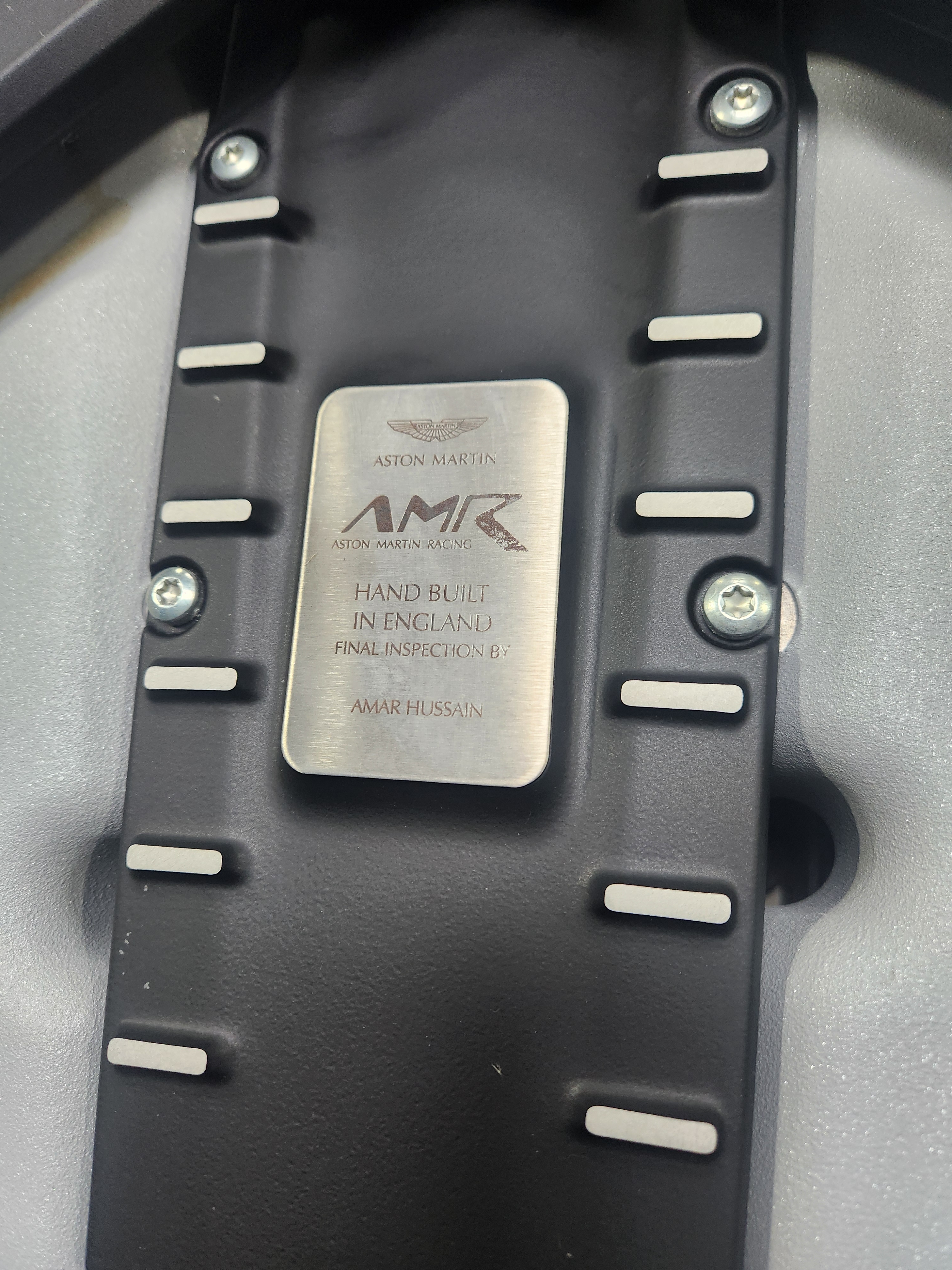

Yes, there are several ways you can tell. Below are the two most obvious/easiest.
If done properly, the badge plaque in the engine bay should have been replaced by one that reads ‘final inspection by AMR’ and not some random persons name.

The plaque comes with the software, it's on someone's toolbox.

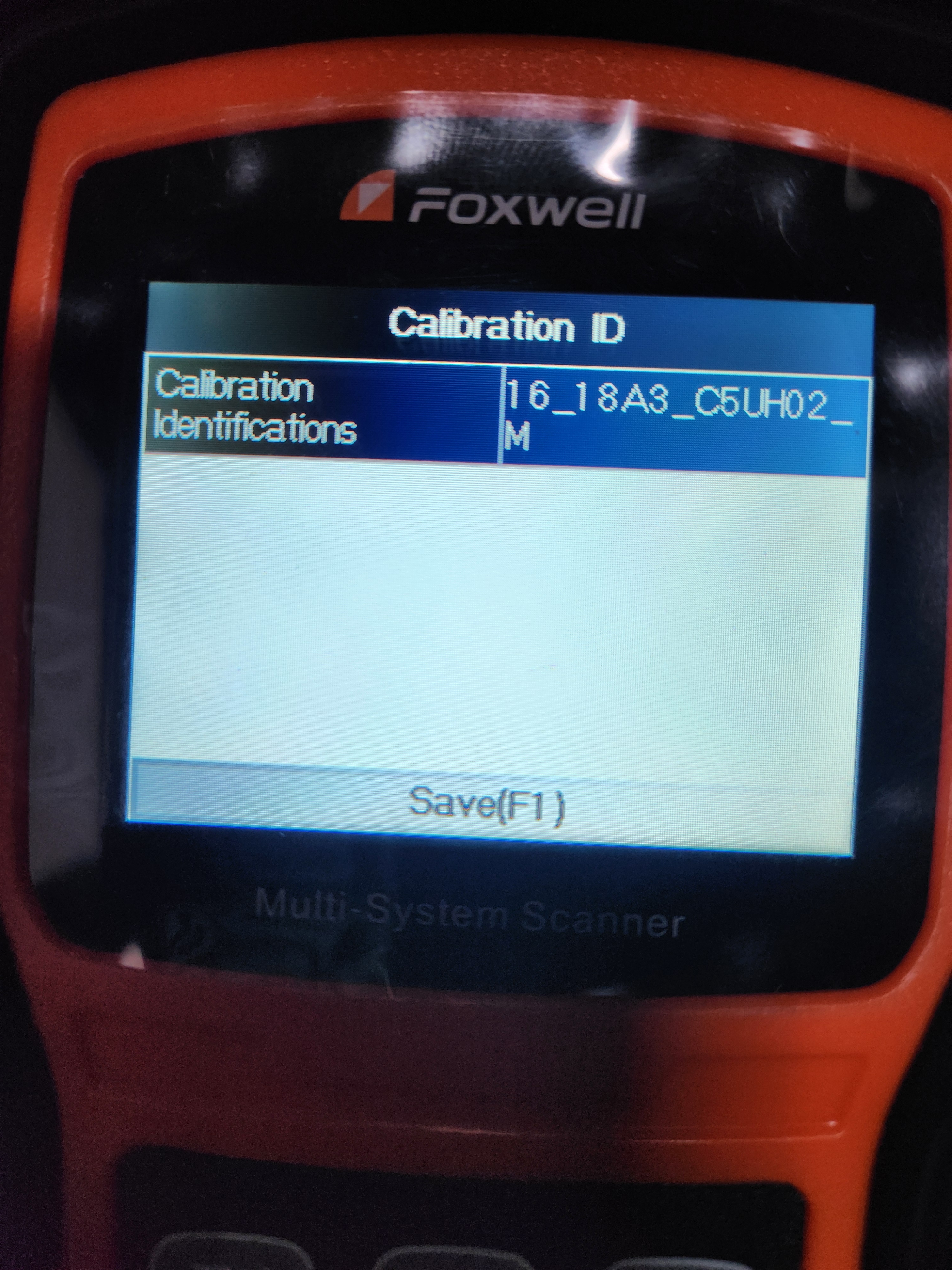

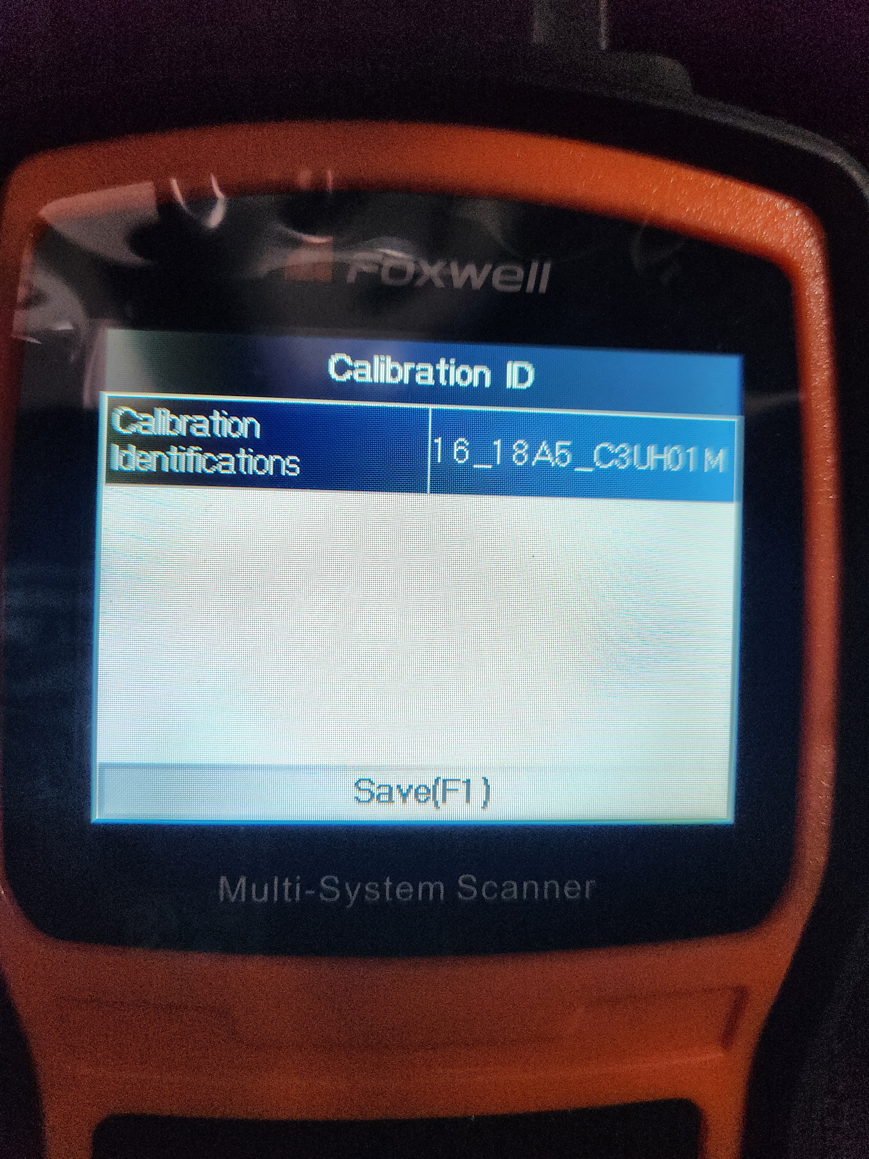

J doubleU Is a GOD !J doubleU Is a GOD !J doubleU Is a GOD !J doubleU Is a GOD !J doubleU Is a GOD !J doubleU Is a GOD !J doubleU Is a GOD !J doubleU Is a GOD !J doubleU Is a GOD !J doubleU Is a GOD !J doubleU Is a GOD !
Foxwell reading this 1st one is base tune, 2nd is AMR.
ID:	545089   Click image for larger version
