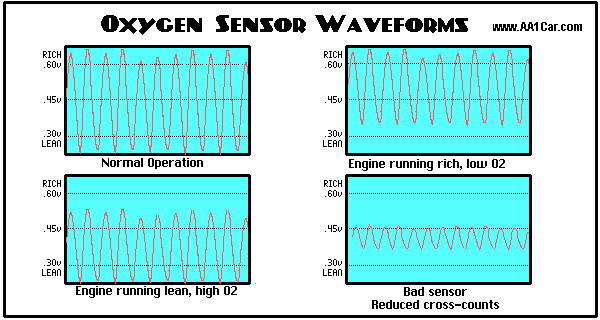

Yes, as V8VDrew suggests, the voltage pattern for the front sensors which control the fuel trims is an oscillating one traveling in the range of 0.1 to 1.0 volts, with .45v representing stoichiometric fueling (14.7:1).
One of the simplest charts I like to reference is this one. No O2 sensor will look like the suggested perfect pattern, but closest to it is a good sensor. Both engine and sensor must be up to operating temps.

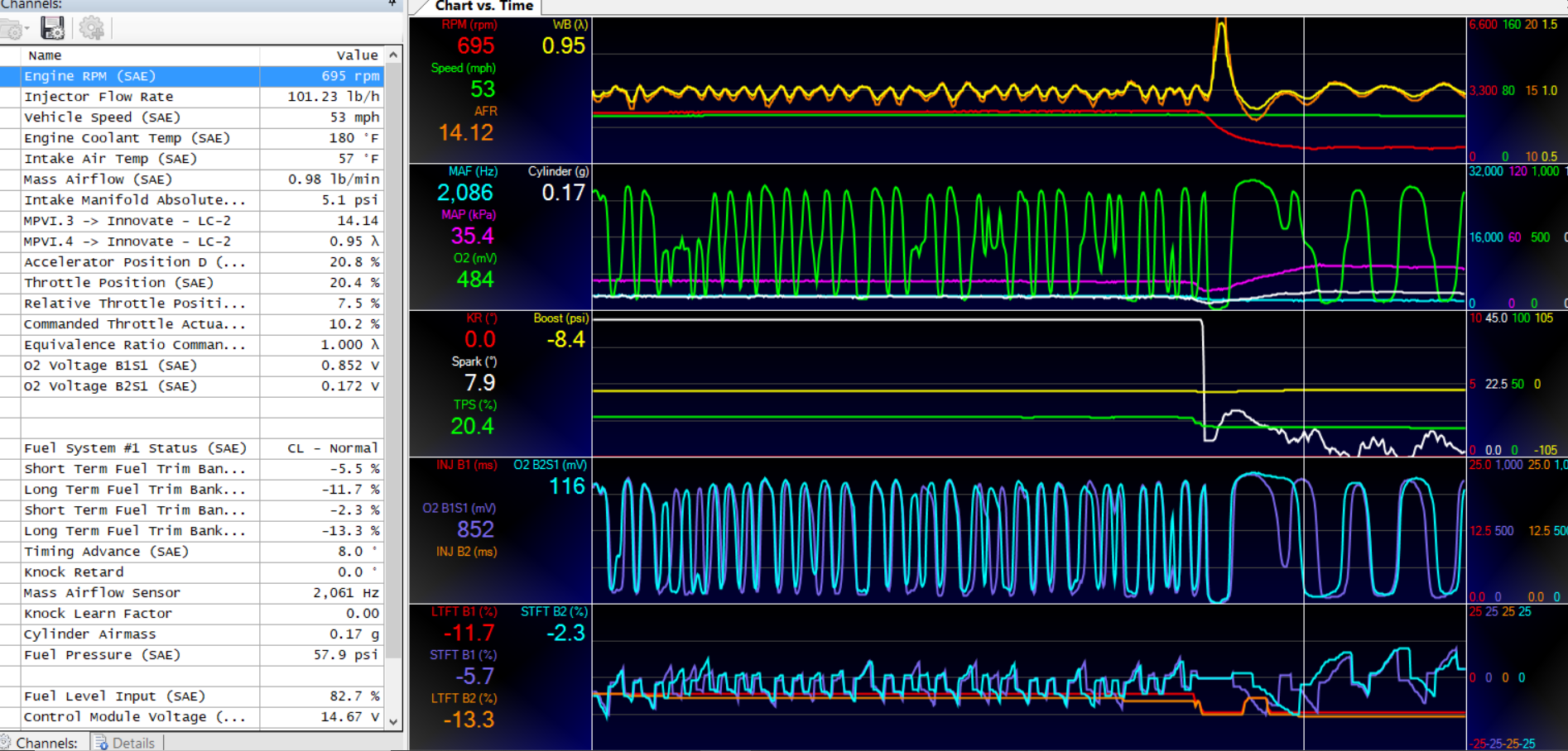

Here is a real example of the O2 front sensor outputs. This came from a car I was tuning. In this particular live data screen catch, engine was idling. The O2 sensor STFTs outputs are shown in the fourth row as light blue and purple. Here I have the scale set to %s and not actual voltages but the pattern is the same. This is a healthy O2 pattern.
