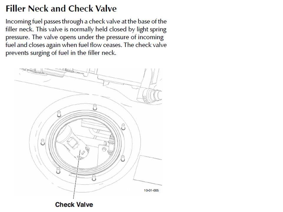

When I read the workshop manual, it says:
As I read that, the check valve should avoid any fuel sloshing back onto the filler cap.

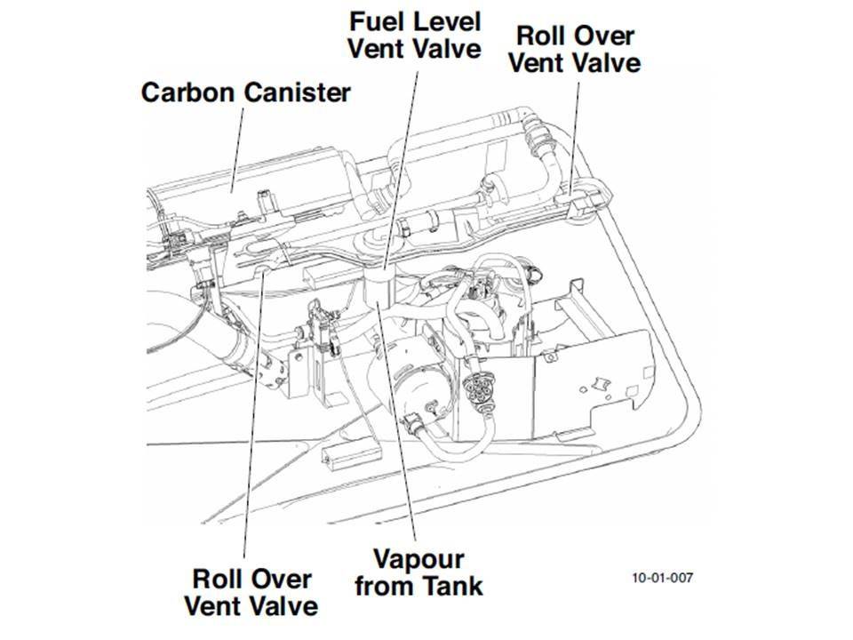

So my conclusion so far is:
- Check valve does not properly close
- fuel sloshes against filler cap inside and that fuel blocks internal vent
- vacuum build in the tank and prevents proper fuel delivery.

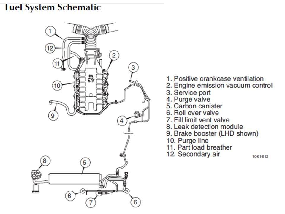

1st, the fuel cap does vent. You can check the spring movement to verify with a small screwdriver lightly insert in the center of cap an it should move a few mm.
2nd one thing that does occur with a full tank and turning is a vacuum vapor line that can split (inside the tank) that supplies fuel vapor to the purge valve. But if it's split it supplies fuel which is drawn into the intake manifold. Usually causes a stall condition but if you're in a higher RPM it's going to stumble with added fuel. Quickest way to check is to remove the supply line at the purge valve to check for raw fuel. This is of course when the symptoms are present.

Any hint on which line (in this snake's nest) is prone to splitting?
On second thought I guess nothing is wrong with my check-valve at the end of the filler tube.
The preload on that spring against the ball inside must be rather weak in order to let the fuel in.
That means the ball in the ckeckvalve can be forced to open during a hard left hand turn.
What is certainly not correct is the check-valve inside the filler cap, which seems to stuck closed for some reason.

and a plug for the line #10 entering the plenum to avoid flooding with fuel.

I checked the hose acc to Rich's manual, but that hose is intact/tight.
The check valve in the fuel filler was rather sticky and after initially opening it manually still required lots of vacuum (sucking) to open.
