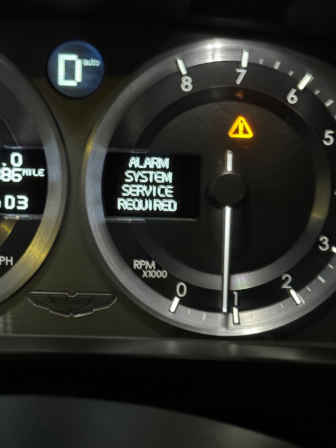

Hi all
I have a 2006 db9 in San Diego and wondering if anyone can guide me on a few issues or ideally recommend a shop to take it to as I’m not very car savy or have many tools
1. Alarm system service required error. Watched a you tube video // Seems like it could be the alarm battery which is located under the LH wheel arch.

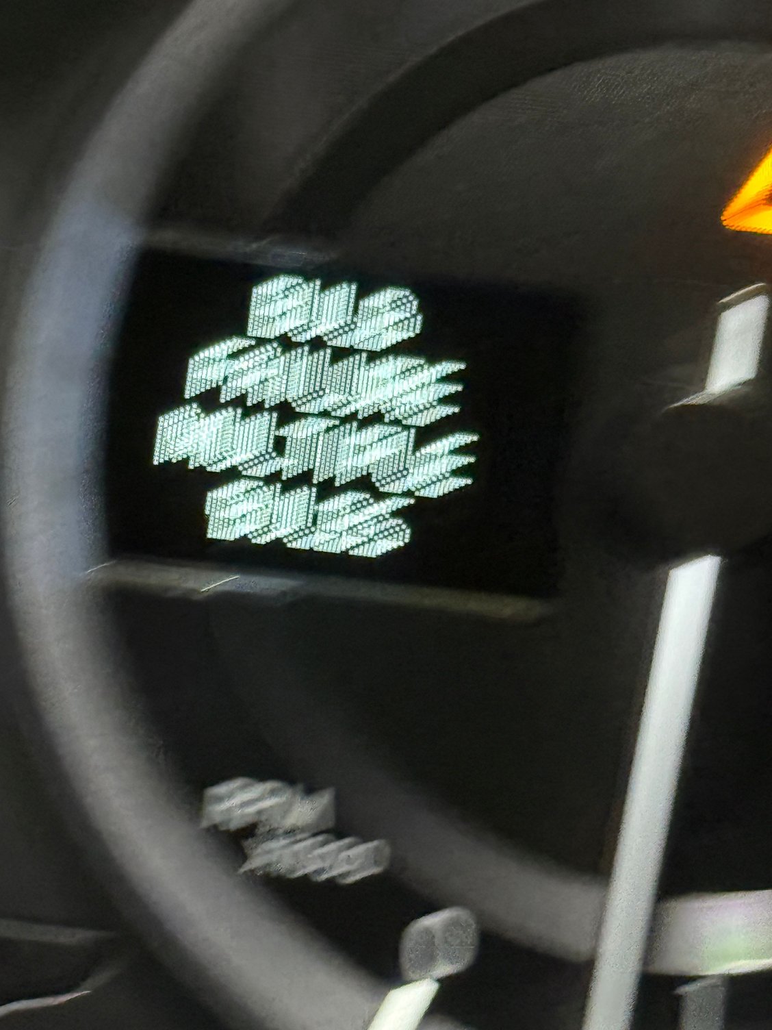

2. Bulb failure multiple bulbs. Turn signal front and back don’t work. All other lights work including the turn signal lights by the door panels on the side.

1) Most likely need to replace the security alarm module, you need to know if it's a High or low spec. To work correctly.
2) front is a automotive bulb that can be changed, tail lamp is sealed LED which would require replacement of entire lamp.
