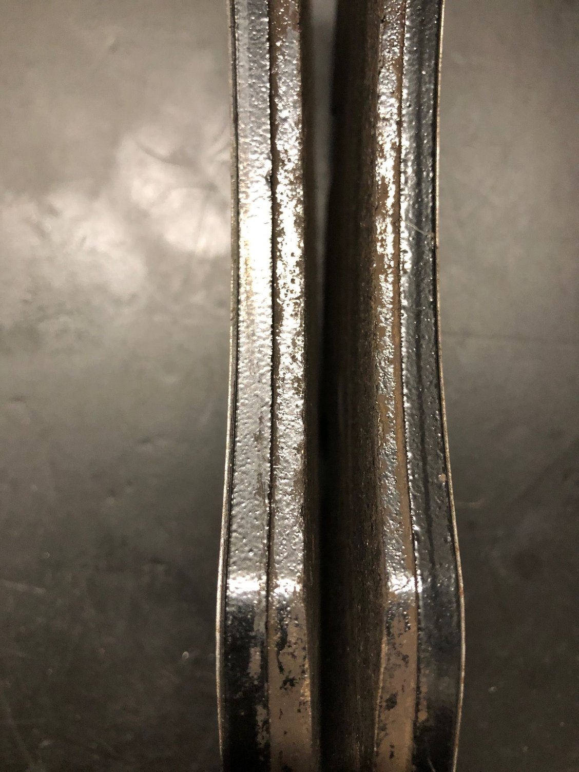

Here is a visual on pad wear.
These are the left front, outer and inner pads that came off my DB11 @ 30,000 miles and my car has never been tracked, just street driven. The worn pad thicknesses are:
Outer - 3.3MM
Inner - 3.0MM
The difference in outer to inner - 0.011"
Whether an inner pad wears at a faster rate than the outer pad can vary based on a few different reasons, one of which, again, is driving style. Cars that are seriously tracked that go through a set of pads in very short order on the track, most of the track wear is occurring in turns where the vehicle mass is shifting during braking which can cause more uneven wear (inner to outer, and left side to right side) than a car that is driven on the street where the majority of the braking occurs in a straight line.
New pads are usually in the range of 12mm to 14mm depending on the brand. For all the brake jobs I've done on cars in the last 35 years, on my own cars, I don't wear down a pad to the point of triggering the sensor; instead, I watch the outer pad and change about in the range where I see the outer pad at about 3mm. If you're not into metric, that's about 1/8th of an inch.
I could had gotten more mileage from these pads, maybe another 5K miles or less, but not worth it to me, especially since a brake job on my own cars cost practically nothing compared to shop or dealer prices.
