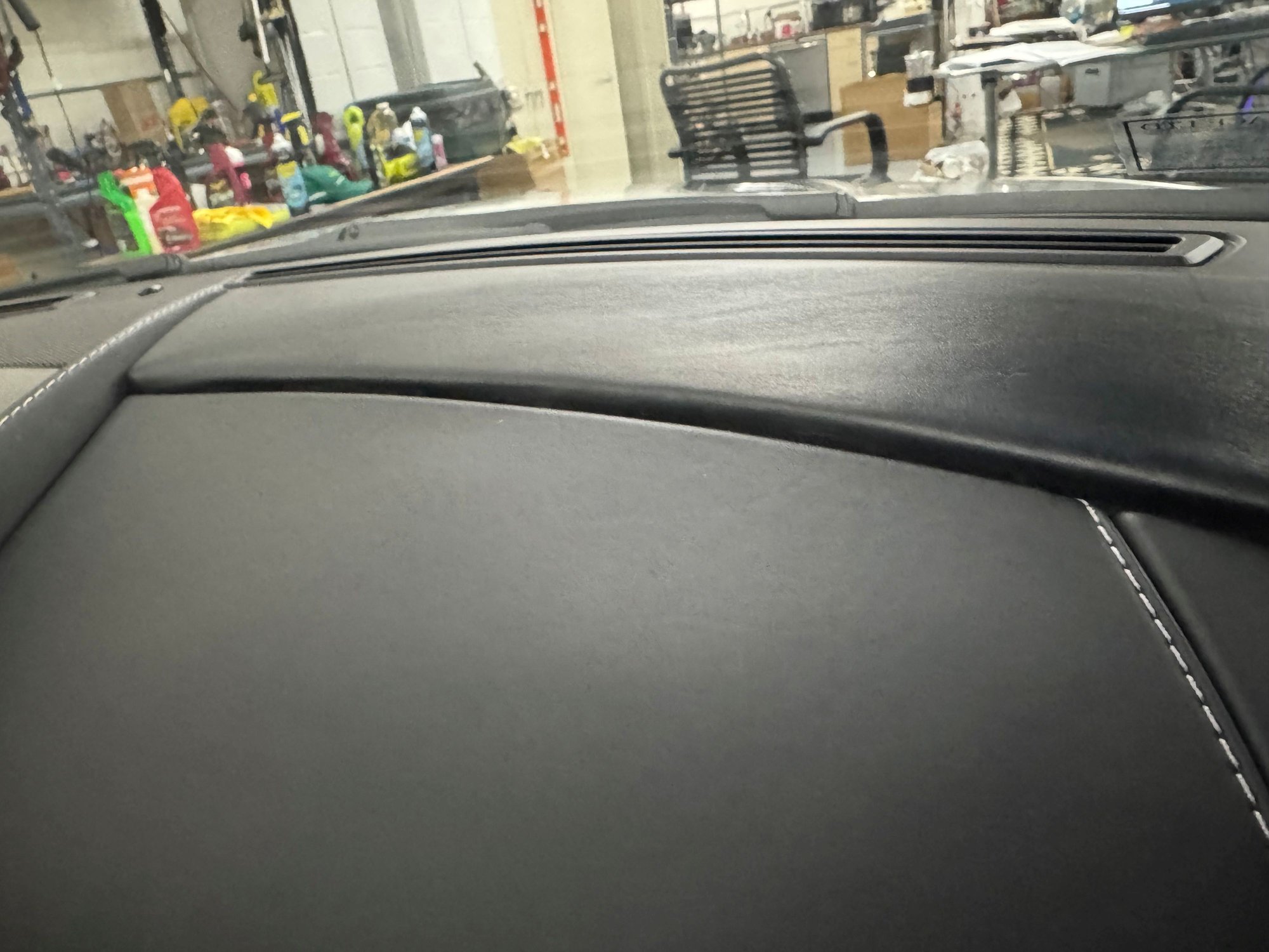

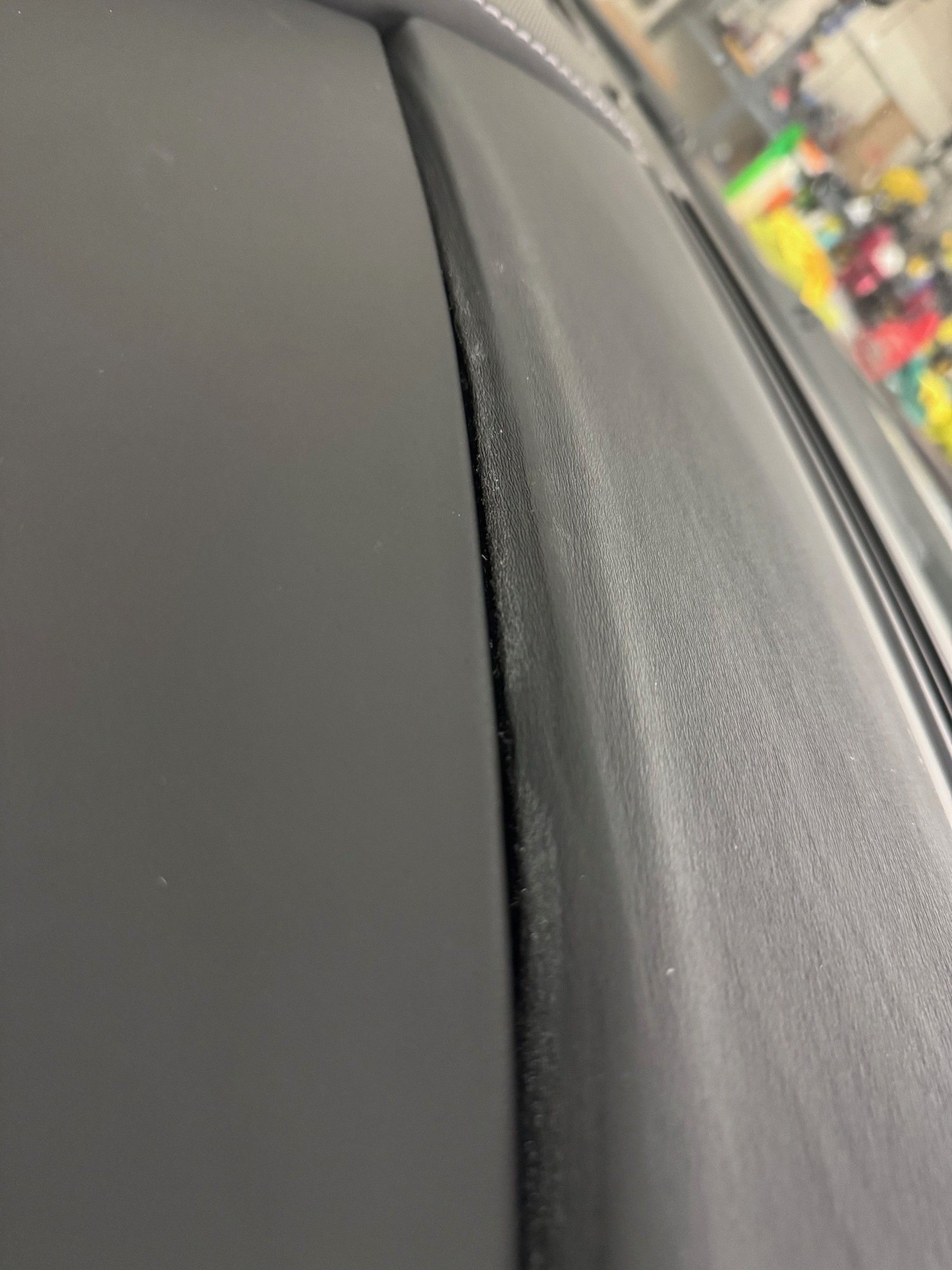

Fixed the leather shrinkage on my dash $150
I had the leather shrinkage and unglue issue on the 2016 V12S I recently purchased. This is my 8th Vantage since 2007, and the first with any shrinkage issues, so it was pretty bothersome to look at. I thought I'd just buy some superglue and a precision applicator to do the work myself. After about 2 seconds I figured I'd need a plan "b" and taking the dash apart was not an option (that's plan 'c'). I hired CCI in Minneapolis on the refinishing of the interior on my 2002 SLK32, and on most of my Astons to fix the wear points on the seat bolsters. They came out this morning and carefully reglued the top area, smoothing it down by hand then regluing the edge. Total $150.00 - amazing. Below is the drying of the glue, the before and the after.

Well that turned out well….congrats…
