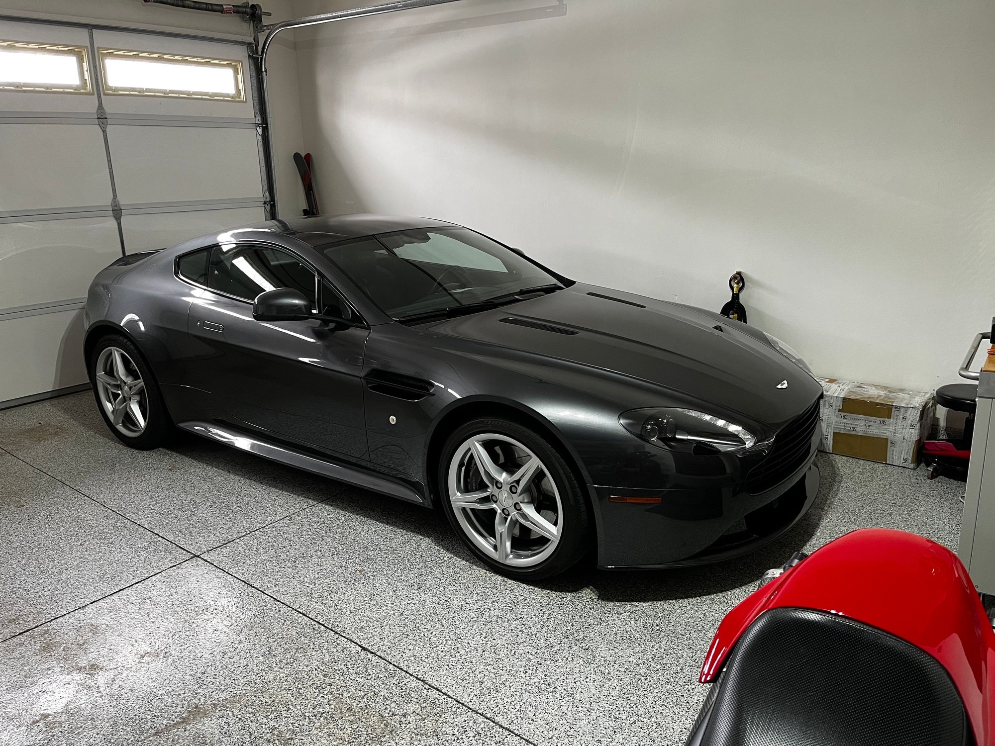

Hi all, hoping I'm not unnecessarily starting thread looking for information that's easily found, but a few searches both here and outside of the forum haven't turned up anything for me yet. Looking for the dimensions (widths specifically) and offsets for these style wheels -
Does anyone have this information on hand or recommendations on where I can find this?

It's usually stamped on the back side of the spokes (width, diameter, and offset). If you can't remove the wheels at home, maybe you can get a small mirror in behind the spokes?

Thanks, yeah ideally wouldn't be pulling off the wheels just to get that info but I'm stumped on where to find it online so that might be my only option. Some of my usual sources of information haven't turned up anything for me. The mirror idea is a good one, there is enough room between the spokes that might work.

Don't know if they are the same offsets, but the original factory wheels on my 2015 are 19 x 8.5 x 49mm front, and 19 x 10 x 59.3mm rear. I would assume they would be similar if not the same. On mine they are on the inside of one of the spokes. You can feel, if that's where your are. What I did is press a small piece of tinfoil against it to make an imprint when they were still on the car.

GG33-1007-A 8.5JX19 ET49
GG33-9965G-A 10JX19 ET59.3

Front: 19 x 8.5, offset + 50.3
Tyre: 235/40ZR19
Rear: 19 x 9.5, offset + 62.5
Tyre: 275/35ZR19
later v8 (sport pack, v spoke, light weight but not including the "specials" like amr or gt8):
Front: 19 x 8.5, offset +49
Tyre: 245/40ZR19
Rear: 19 x 10, offset +59.3
Tyre: 285/35ZR19

I was able to confirm this as well from LuvBurninFuel's tin foil trick but didn't come back here to post it. Actually these wheel sizes/offsets would work for the AMR (unless you mean the AMR Pro), I know the non-Pro AMR editions had the same five spoke wheels I have as their standard equipment. I was actually using this information to compare my stock wheel widths/offsets to the AMR basket weave style wheels for the VH Vantage, I just picked up a set of those and can confirm they are also the same size as the later V8 wheels as you've listed.

Yep, AMR are the same. Lovely looking wheel.
