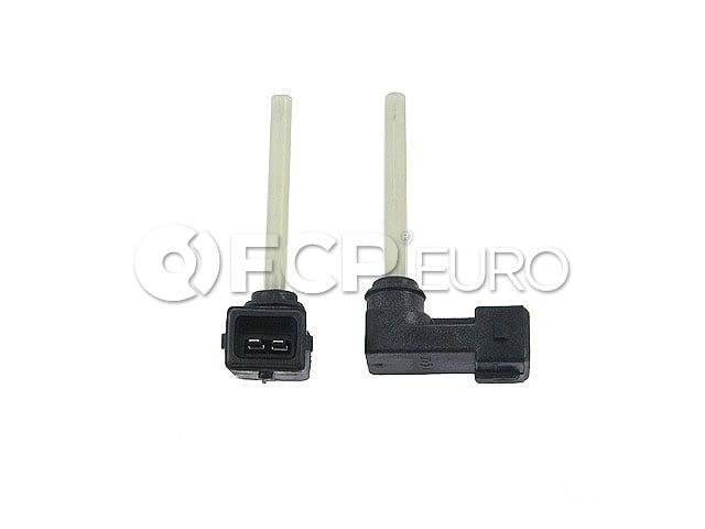

Hey guys does anyone know an alternative part for the Coolant Level Sensor? AM part 1R12-37-10166.
Jaguar Part LNA5740AB looks identical. Can anyone confirm this??
https://www.fcpeuro.com/products/jag...hoCCUQQAvD_BwE

Usual fault is in the reservoir itself. For that price it's worth trying. Have you checked the wiring and connection? I would try disconnecting it first and see if the warning changes.

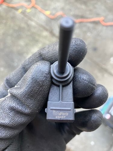

Old Apr 5, 2025 | 03:06 PM
EJ_Rapide's Avatar
Joined: Apr 2023
Posts: 624
From: Santa Rosa, CA
Rep Power: 52
EJ_Rapide has a reputation beyond reputeEJ_Rapide has a reputation beyond reputeEJ_Rapide has a reputation beyond reputeEJ_Rapide has a reputation beyond reputeEJ_Rapide has a reputation beyond reputeEJ_Rapide has a reputation beyond reputeEJ_Rapide has a reputation beyond reputeEJ_Rapide has a reputation beyond reputeEJ_Rapide has a reputation beyond reputeEJ_Rapide has a reputation beyond reputeEJ_Rapide has a reputation beyond repute
Just completed the job this morning, pretty straightforward.
Now going to take the car for a spin and see if I still get that low coolant level message...
Thanks!
