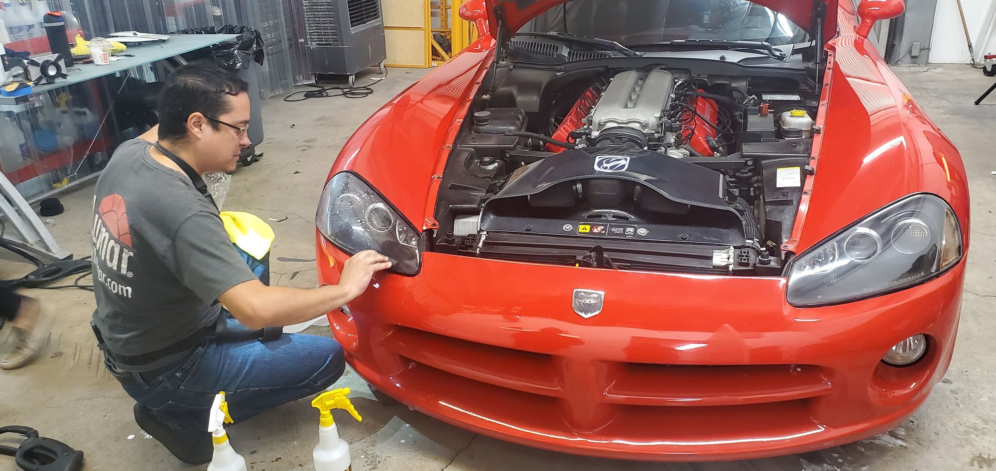

Headlight film removed, polished, automotive clear coat and then ceramic coated. Only do this if it's bad because it does take alot of work.
Old Apr 4, 2025 | 12:21 PM
EJ_Rapide's Avatar
Joined: Apr 2023
Posts: 601
From: Santa Rosa, CA
Rep Power: 52
EJ_Rapide has a reputation beyond reputeEJ_Rapide has a reputation beyond reputeEJ_Rapide has a reputation beyond reputeEJ_Rapide has a reputation beyond reputeEJ_Rapide has a reputation beyond reputeEJ_Rapide has a reputation beyond reputeEJ_Rapide has a reputation beyond reputeEJ_Rapide has a reputation beyond reputeEJ_Rapide has a reputation beyond reputeEJ_Rapide has a reputation beyond reputeEJ_Rapide has a reputation beyond repute
Looking nice!
How bad was it to remove the film?
Did you remove the headlight off the car?

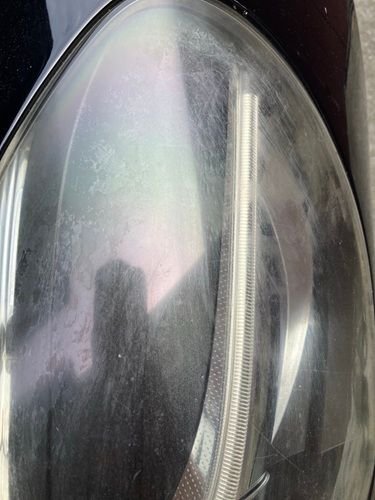

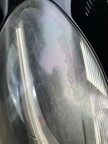

This is what my headlights look like
So yeah, any advice is appreciated

headlight restore can do it on the car. All depends on who is doing it.
The Vantage is a bit overboard. Sand, polish, clear, PPF, and finally ceramic coating
The Viper did not get clear coat. PPF then ceramic coating

I would just have a body shot sand it down and clear it, if there is a coating or something over it, its already done for anyways. basically your just removing all the failed film, smoothing it out and putting a clear coat over it.
If you want to do it youtself, buy a kit that attaches to your grill and sand away. I would buy a precut PPF after your done polishing and ceramic coat it after and you should be good for a long time.
