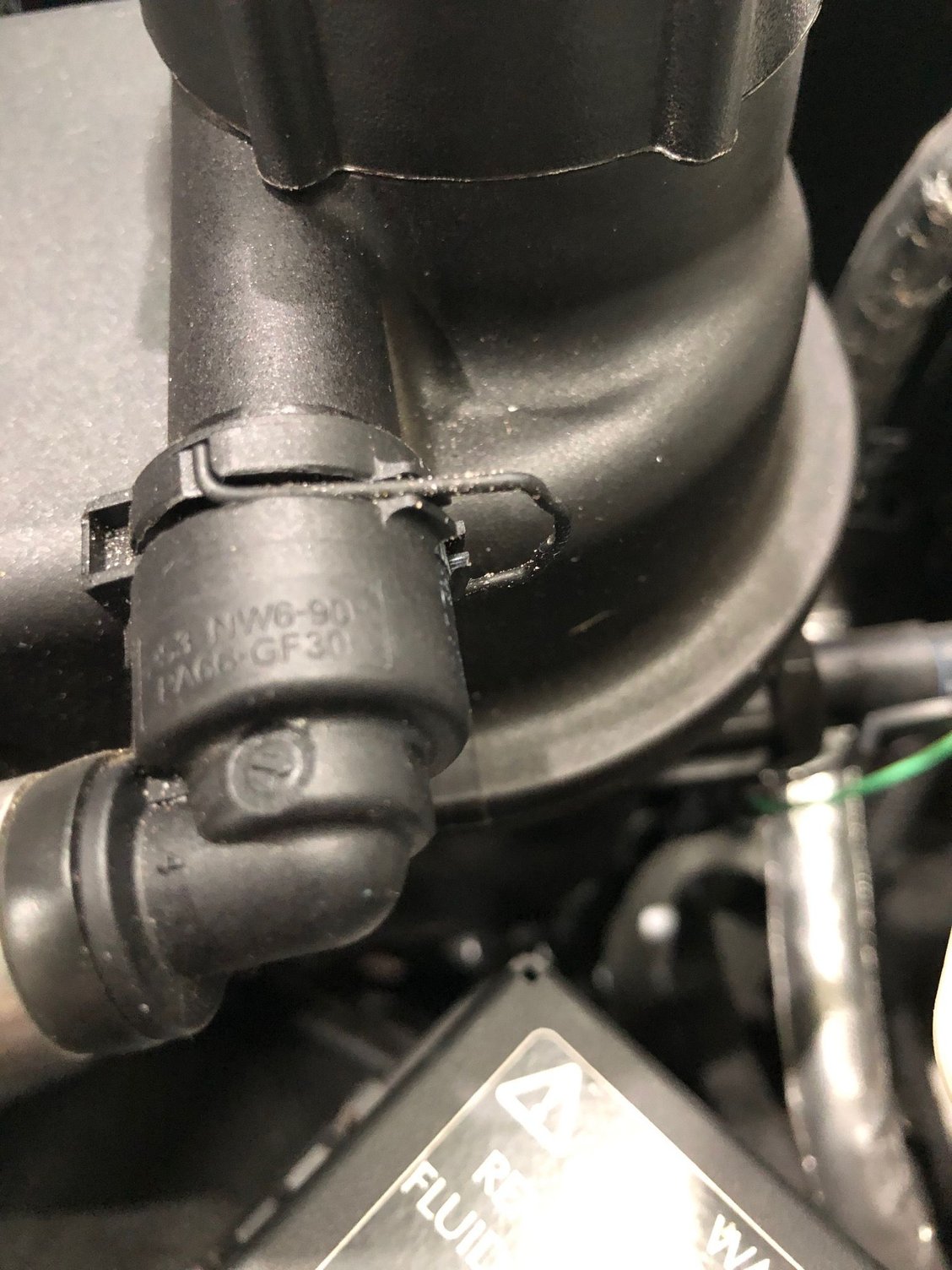

somebody knows how to remove this hose/clip? to change the coolant on a rapide? thank you

Yes, that appears to be a typical spring clip hose connector (it is only a drawing and not a real pic, but pretty sure).

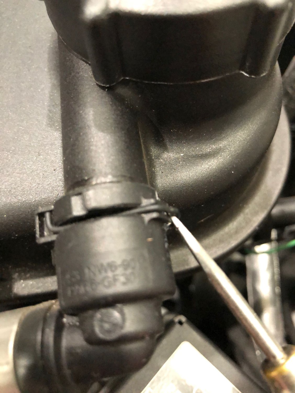

Place a small screw driver behind the wire,
Pry the wire out a small amount until it locks open:
Now you can pull off the connector. To reconnect, make sure the o-ring is in good shape, clean, and coat with an o-ring lube. Reconnect, then push the wire lock back in place.

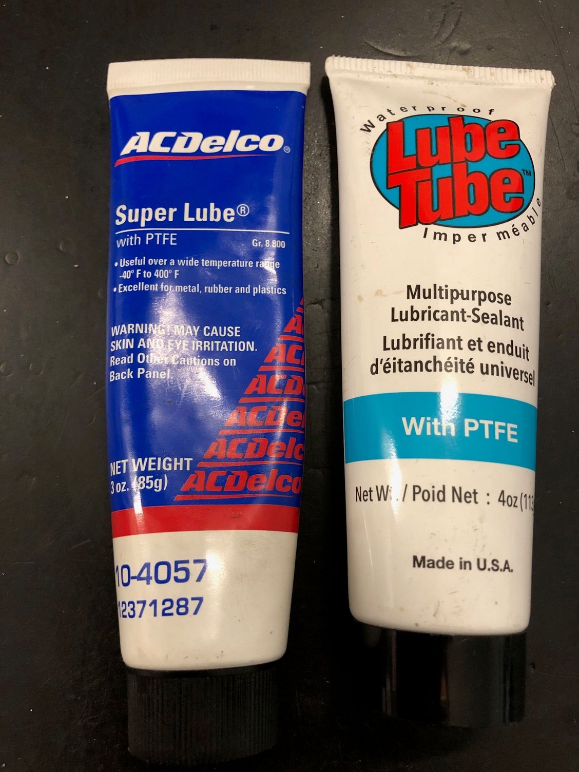

Should be something like this to lube o-rings. The one on the right side is the lube I use for the o-rings on my pool equipment.

Yes, it is important (to me) to use the correct lubricant on any rubber compound seal and not just any grease or oil. When an o-ring lube is used it causes a slight swelling to occur which helps the o-ring to seal better than dry. It is also IMPORTANT to NOT overdo it. You do not want gobs of lube like this especially in a coolant system where antifreeze might not be compatible. Just a very modest coating.
You can also go into any hardware store in the plumbing section and find 0-ring lube. Note in both of the products I pictured above has the active ingredient PTFE which is key to the correct lube.
