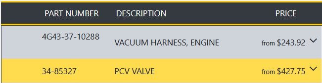

Some of the parts pricing are just plain crazy!
For example, the PCV parts on the V12
$427 for one PCV valve - a Motorcraft EV-152 that goes for $35-55
The Vacuum harness assembly (which includes two of the PCV valves) goes for $244
go figure
