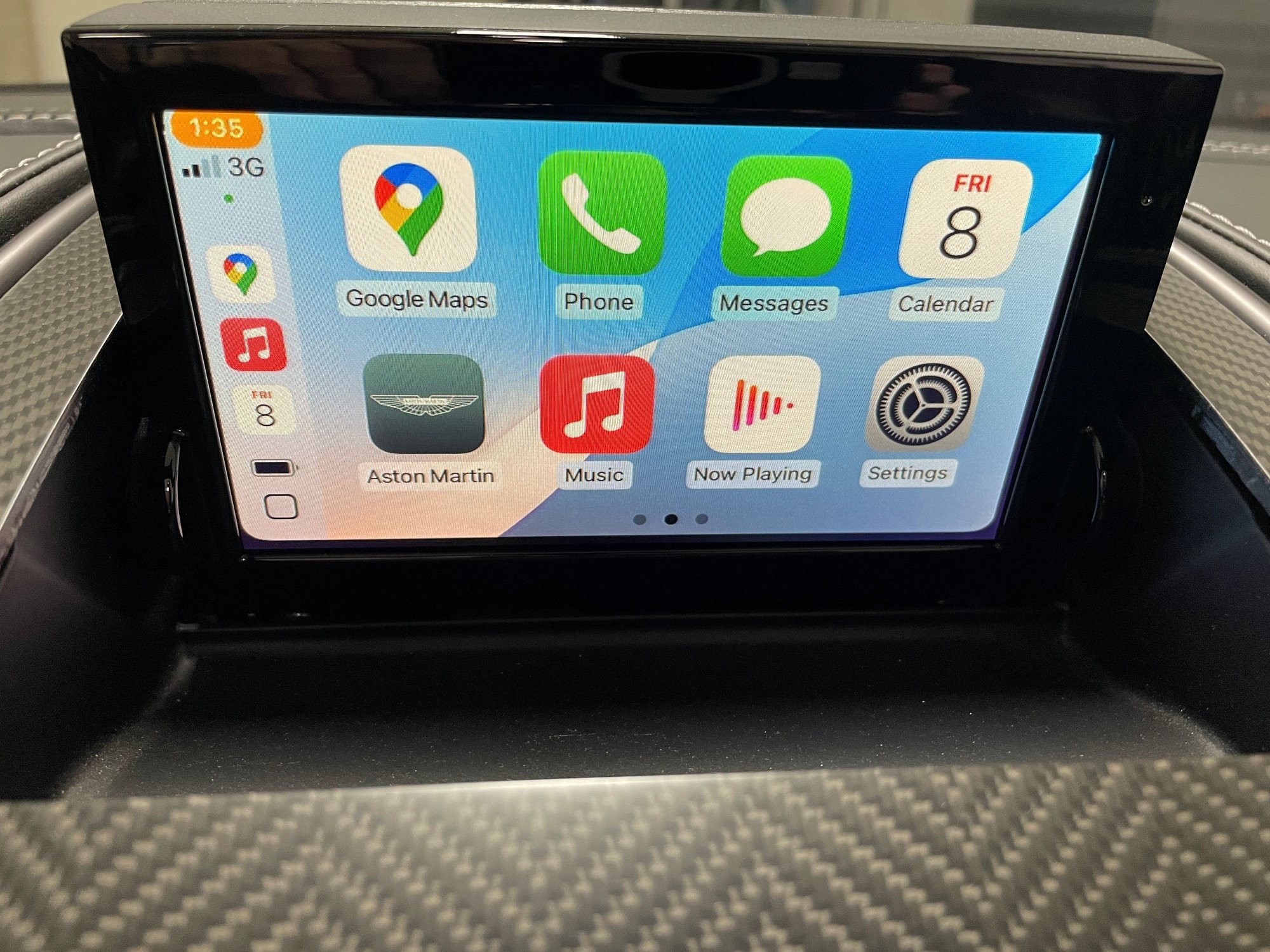

After a couple of multi-day road trips in the Vanquish this year I decided I really wanted a proper navigation system. The maps installed in the Garmin unit at the factory were dated 2013 (even though my car is a 2016, built in late 2015. The updated "North America" SD card I got from Garmin worked great, but only in the USA -- not much help when almost all of my driving is in Canada. I guess the AML SD maps include a firmware update to deal with larger map files or something. I downloaded some "Open Street Maps" onto an SD card; they were okay, but for some reason could never give me directions home.

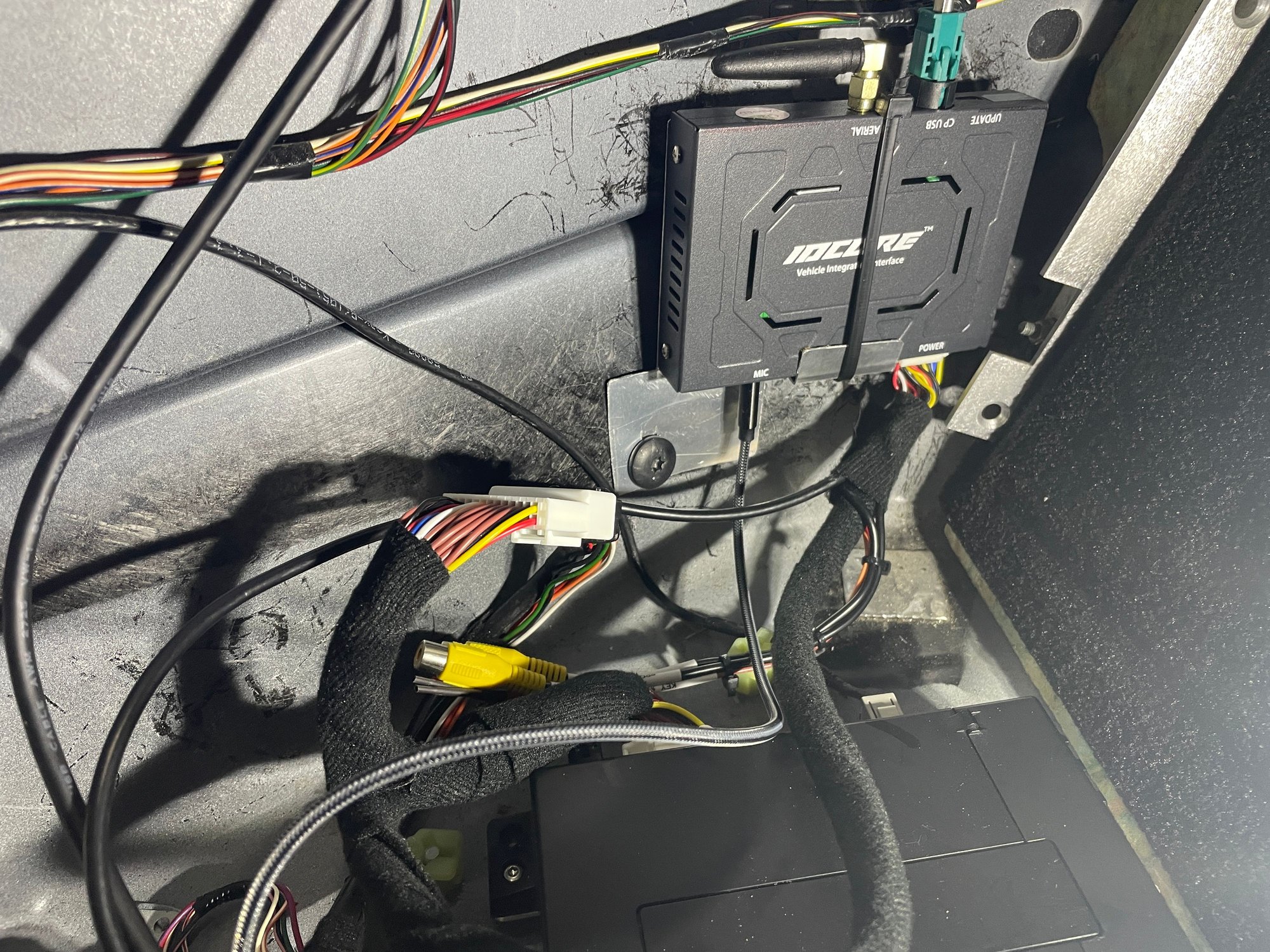

Everything was well packaged and in addition to the electronics module, cables and a microphone were also in the box. Instructions were very basic, outlining how to install it in a coupe. I have a Volante, and it's not at all like the coupe in terms of finding a path for the wiring from the trunk into the cabin. In fact, the Garmin unit is in a completely different location in the trunk.
In the Volante, the Garmin unit sits in a well on the left hand side of the trunk, covered by a rigid carpeted piece. I was able to trace the Garmin harness that passes through a rubber grommet in the bottom of that well, through the wheel well behind the arch liner, and into another rubber grommet that enters the roof stowage compartment, not far from the top left corner of the left rear seat. It continues down behind the left rear seat.
Entering the roof storage compartment
Before running the wires I connected everything and tried it out. All plug and play, no splicing wires or pinning connectors. It worked as described and Car Play showed up on the standard screen. The resolution is fine -- it looked pretty good. Both wired and wireless worked as claimed. Onward ho.
I committed to the install and started measuring things. The first issue is that the supplied cables weren't going to be long enough. There are 3 cables: USB (for a wired/charging connection), an AUX cable for sound output, and a microphone cable. Both the AUX and microphone cables were too short for the path that I was planning to take, so I got extensions for both of them. Next step was dismantling the trunk. It's like a puzzle, removing one piece so you can remove the next, and so on. After that, pulling the wires through the grommets was pretty easy (silicone grease helped). I wrapped and zip-tied the 3 cables to the Garmin harness.
Because the carpeted panel that covers the Garmin is fitted with foam spacers, I couldn't just lay the IDCORE unit on top or beside it. There was a convenient bolt on the inside of the rear fender, and I used it to attach a bracket I fashioned from some sheet aluminum I had on hand. That all gets hidden behind the side carpet piece when it goes back together.
Improvised bracket using existing bolt to secure unit behind carpet.
Before putting everything back together, I tried the wireless Car Play again. It didn't work. Unique Auto Developments warns that the carbon fiber construction of the Vanquish can interfere with wireless signals. If I opened the trunk lid, the wireless worked great, but no dice with the trunk closed. I solved this by running out to Best Buy and picking up a generic wireless Car Play dongle to attach to the IDCORE USB cable inside the car. Now the wireless was working again. That is, until I decided it could live out of sight under the back seat cushion. Nope, that didn't work either. The Vanquish is like some kind of Faraday cage. At the moment, I've got the wireless dongle sitting on the floor behind the driver's seat. I haven't done anything special about routing the wiring inside the cabin yet -- that's a winter project.
The first time I used Google Maps while driving I was shocked by the poor quality of the guidance voice. It was "fuzzy" and hard to understand. I tried both wired and wireless with the same result -- really poor audio. Apple Maps was much clearer, and even Waze had better sound quality than Google. If the built-in Garmin voice is 10/10, Google is a 5 at best, Apple Maps is a 9, and Waze is 7.5 or 8. Might be different in your part of the world.
All in all I'm happy with the outcome. It wasn't especially difficult, but there is a fair bit of disassembly. The product is pretty easy to use and I like using the car controls to operate it. Unique Auto Developments delivered promptly and has been pretty responsive to my questions. It really does help bring the in-car technology up to date.

That looks cool, congrats!
What happens when you click on the "Aston Martin" icon?

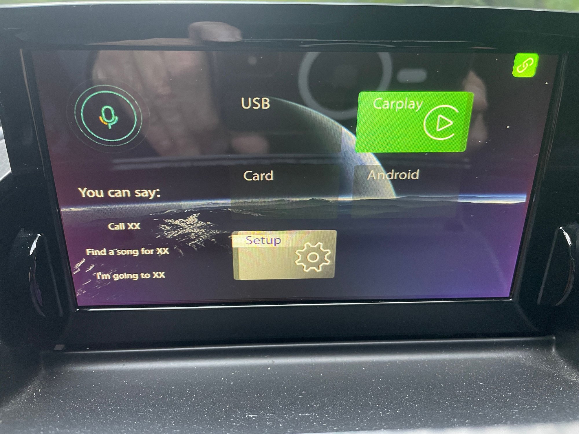

The "Aston Martin" icon takes you into an app that lets you choose a couple of things:
And the "Setup" option lets you configure the device:

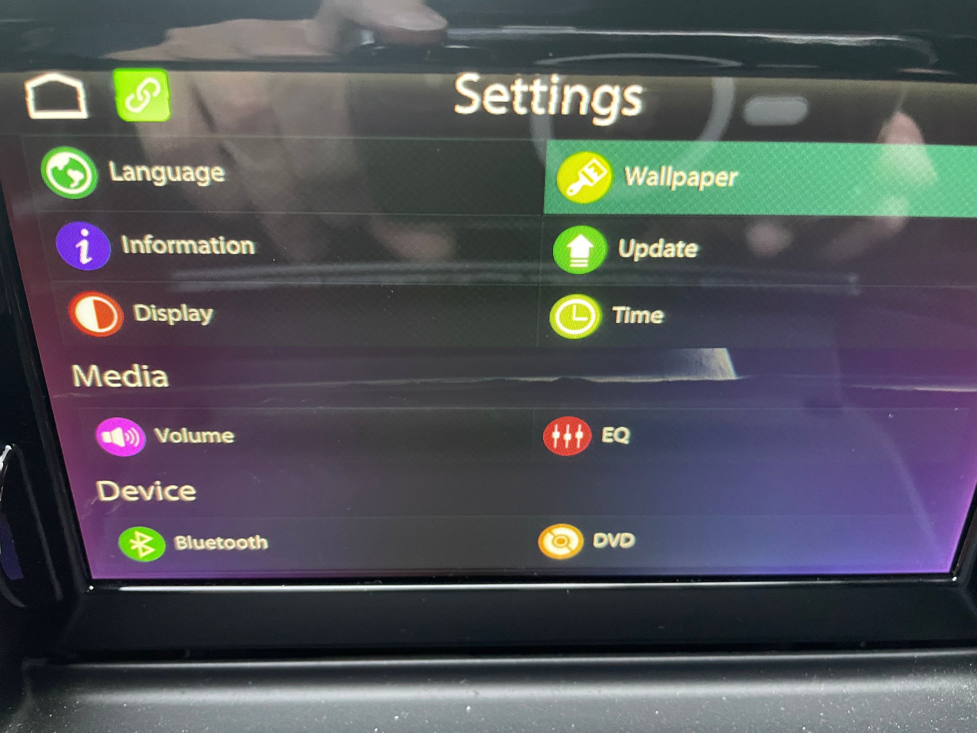

In case you haven’t figured it out yet, adjusting the Volume and EQ settings can have major improvements to the sound quality.
Thanks. I did fool around with those, as well as AUX gain. My old ears didn't detect much of an improvement, if any.
The fact that Apple Maps sounds very good, Waze sounds okay, but Google Maps sounds fuzzy suggests to me that it's related to the app. I could be wrong, and I do need to spend more time fiddling with it.

I’ve found that my unit sounds better by reducing the IDcore’s initial Volume level from 40 to 25 and reducing the Aux gain from 2 to 0 on the car. Also, Unique Auto recommends that the ID Core’s Loudness setting should be OFF. Ironically, I have chosen to stream audio through my car’s Bluetooth connection (instead of Aux) since this sounds much better to me. I lose Navigation verbal prompts but the steering wheel track buttons now work for CarPlay/Android Auto music streaming.
