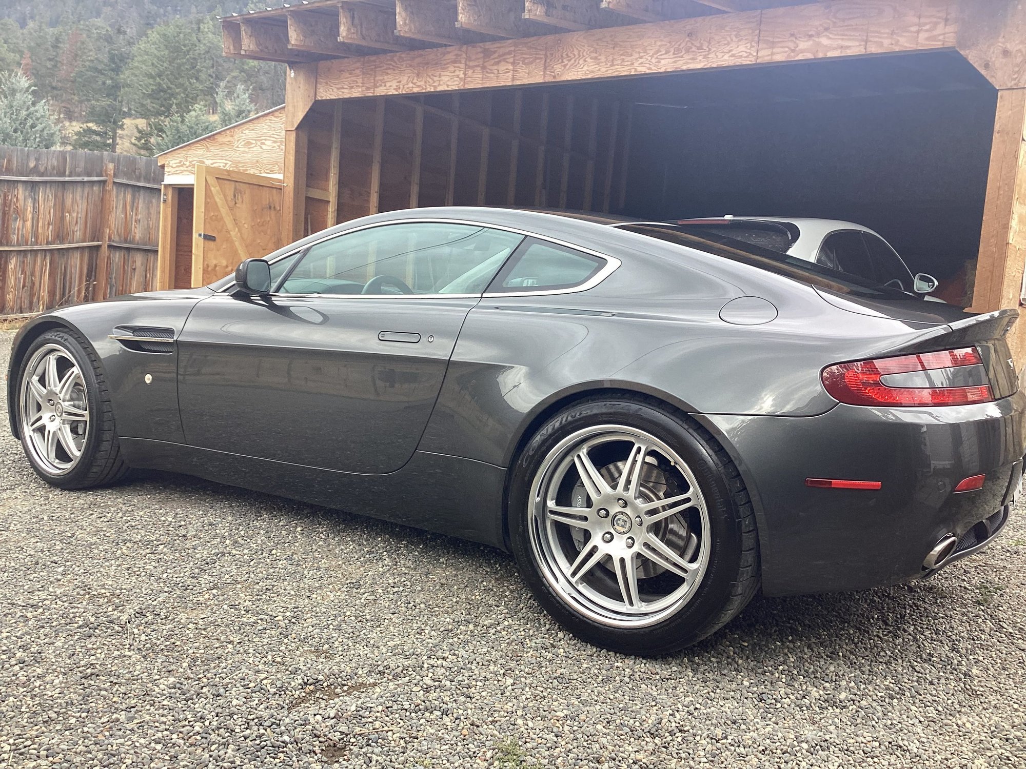

Maybe an update pn those OZ's would get this thread back on track. @sirhodjibob , what tires and sizes are you planning on?

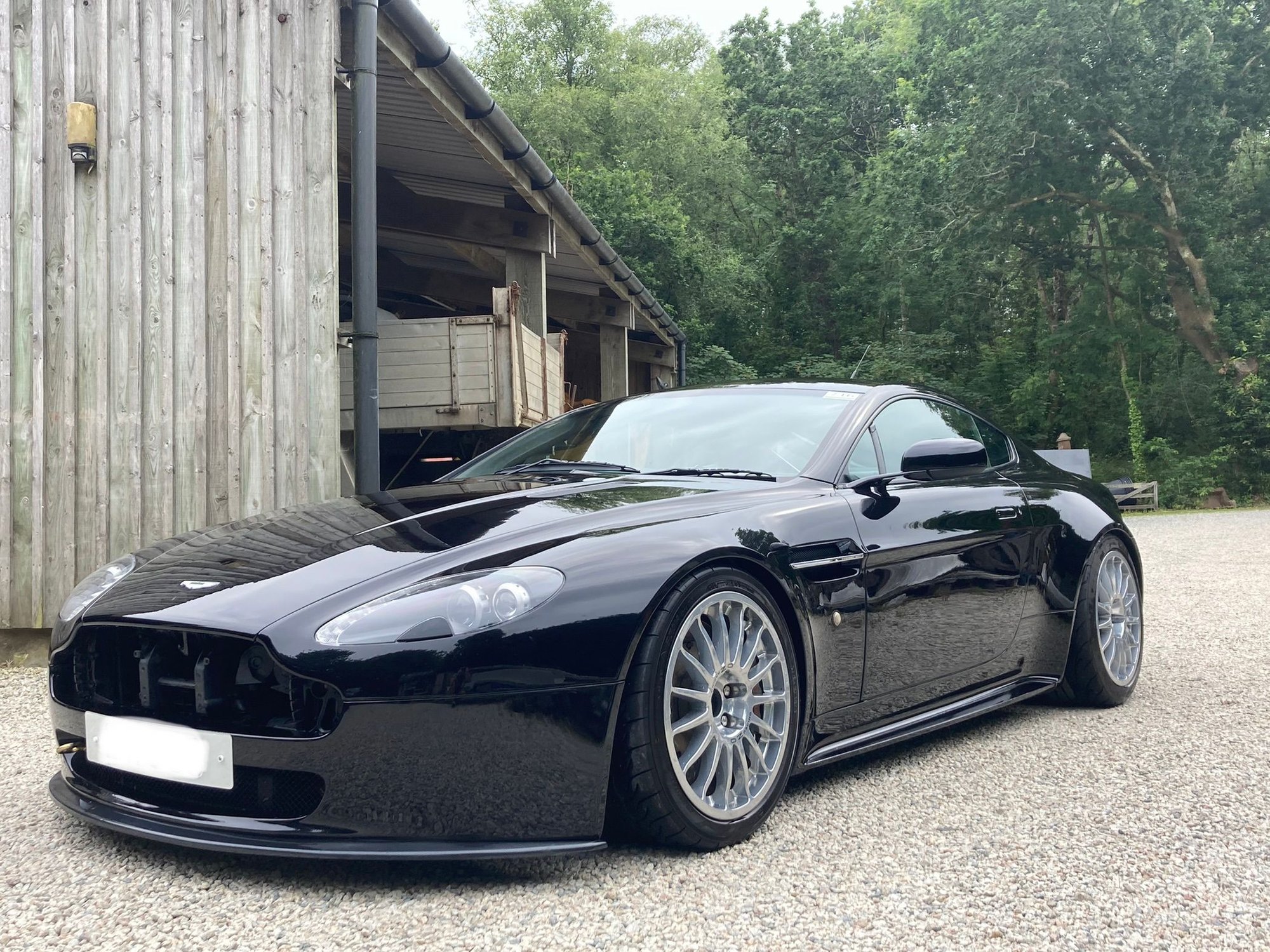

The 18s are proving to be a bit tricky to get tires for and has turned into a deep rabbit hole. You don't want the tires to make the wheels look goofy- too small a sidewall they don't fill out the wheel wheels, too big and it looks like a van. To me the benefit of these wheels is I can gain sidewall for ride quality/stability for bumpy California mountain roads and they still look great.
Plugging my favorite wheel/tire calculator here.
In theory, a 265/40R18 F and 305/35R18 R would maintain factory rolling diameter and stagger (and crucially for my OCD, nearly identical diameter front and rear). Except no one makes a tire in both sizes, and I suspect a 305 rear would be rubbing the fender anyways.
Right now leaning towards a 265/40R18F and 285/40R18 R- matches closely a GT4 I saw on BaT which I thought looked good, and I can get the Michelin PS4S in this size. Other choice is a 295/35R18 rear, but no PS4S available and gives it a slighlty smaller rear diameter. I looked at probably a dozen N24/GT4 cars running these wheels, and there was quite a variation in tire size (of course these are R comps).
This is a 265/35R18 F 285/35R18 R on Pistonheads- owner posted wishing he had a taller tire upfront- and I agree- but otherwise I think it looks quite good.

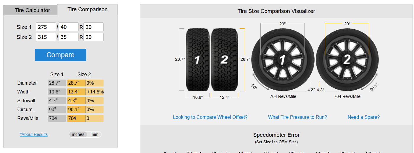

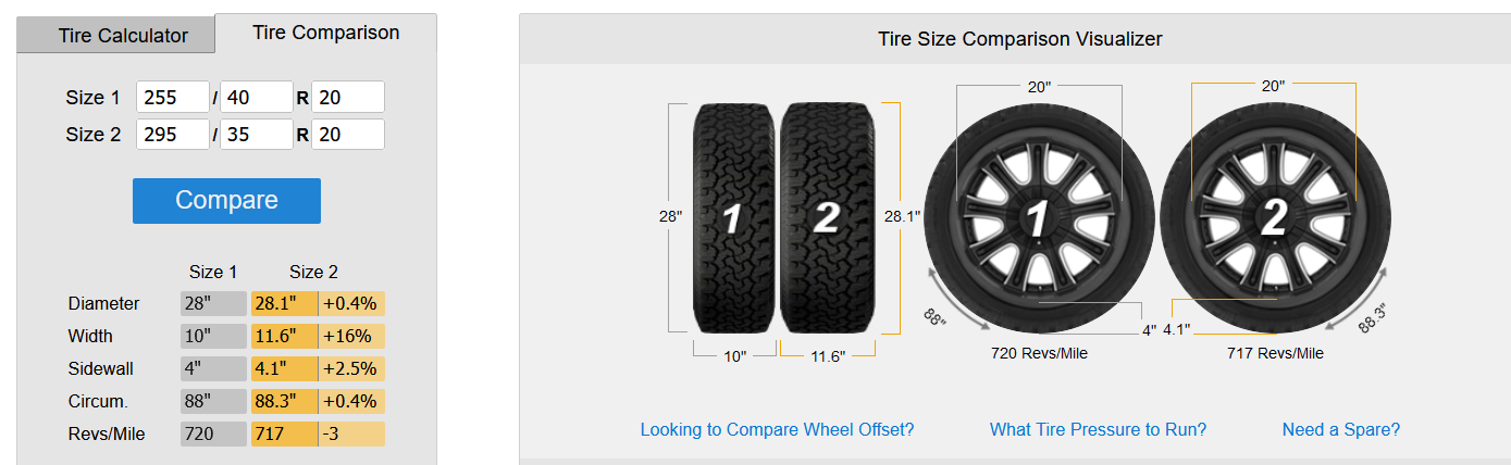

On tires - I'm on a different platform with a DB11. Like other models, the list of performance tires available and given the odd sizes make choices limited. I wanted to change two factors with my tires - I wanted larger sizes front/back, and I wanted an all season tire instead of a performance tire. The reasoning - I wanted a more comfortable ride, better look and since I live in Florida and do NOT track my car, I am more likely to get caught in a raining downpour where the all season tire makes more sense than any chance I track this car.
Faced with this and a tire calculator. I found an all season tire that coincidentally I really like. They are the Continental DWS. I've had DWS tires on other performance cars. They are remarkably quiet, hold up well and although not a performance tire, do come close.
These are the factory stock tire sizes. From the factory these are pretty close with a circumference difference of 0.4%
The DWS tires are both wider with the same % sidewall so come out physically taller than stock. In this setup, the circumference % difference is 0.
These changes gave me everything I sought and the tires fill a little better than stock tires on a completely stock suspension.
