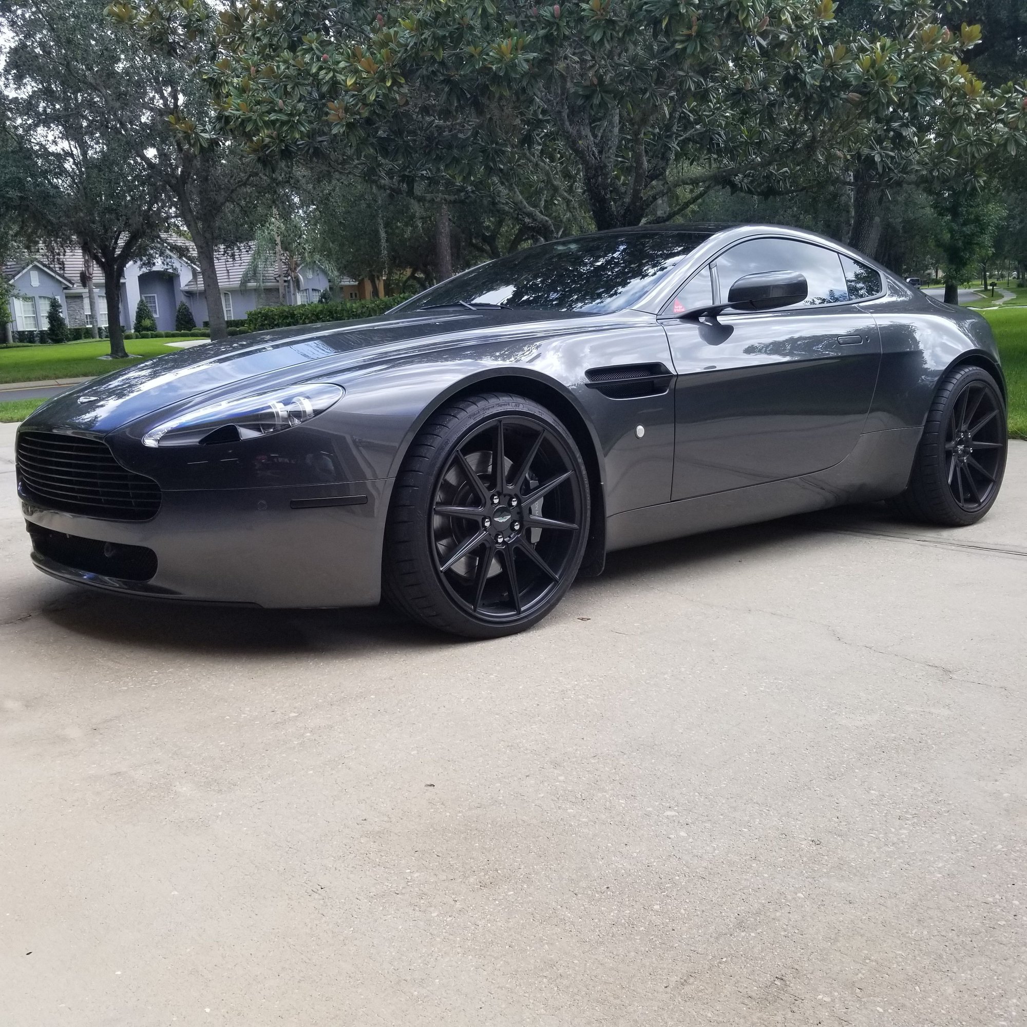

I also opted for Continental AS tires... although mine are 20"... had the U H P Michelin but very harsh with 20's and the Sport Pack set up on my Vantage.
