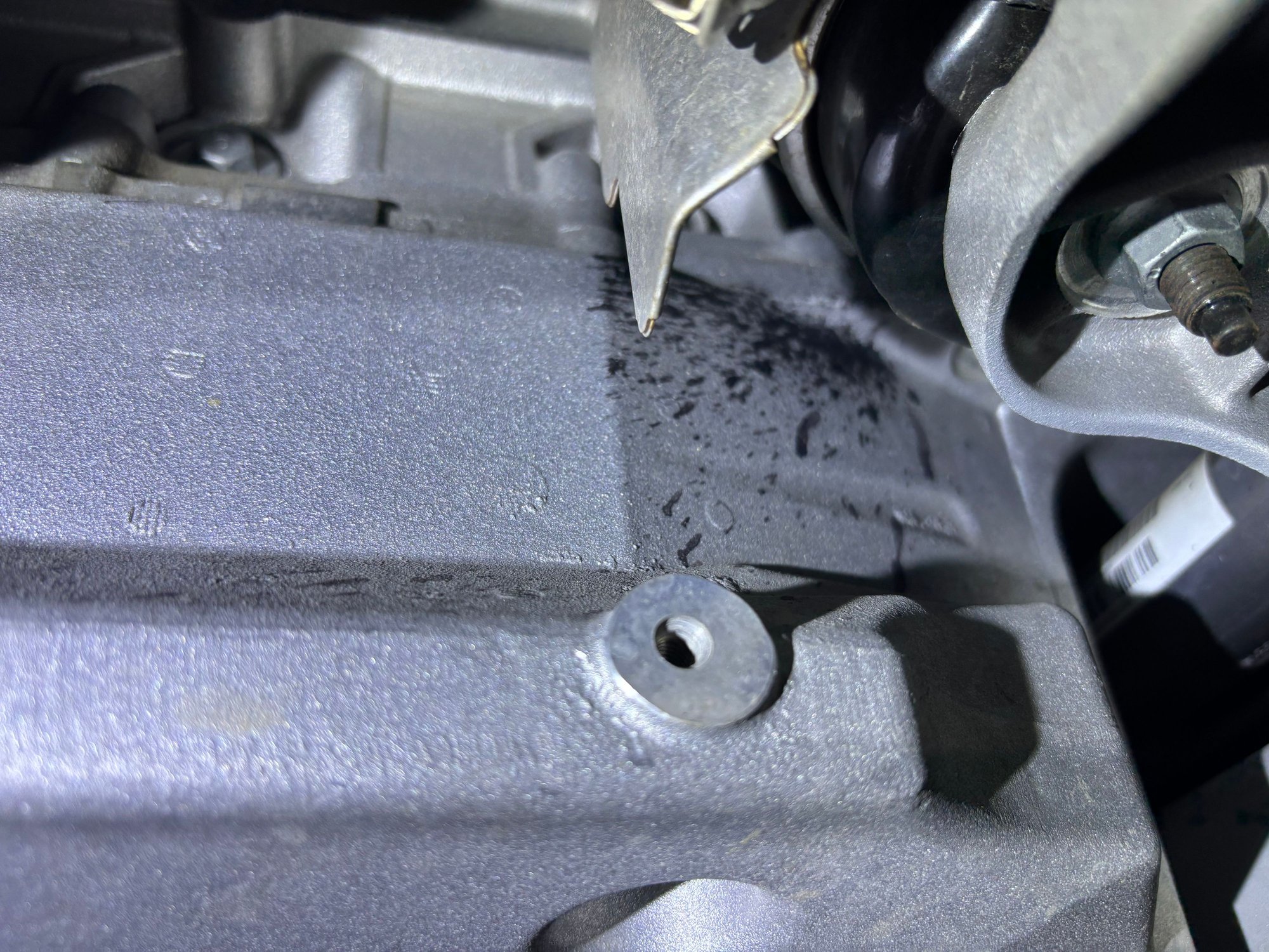

My engine mounts have started leaking on my 2015 V12 Vantage and will require replacement soon. The transaxle mounts aren’t currently showing any signs of leaking, is it normal to replace the engine and gearbox mounts together, or just the engine mounts.
I understand that the Aston mounts are expensive and it’s quite a labor intensive job. What price would be reasonable for the replacement at an independent?
Thanks

It currently has 19,500 miles. It had 18,500 when I bought it in December. During the PPI we noticed that the mounts had burped fluid at some point, see attached picture, but the mounts and rubber were dry and showed no sign of ongoing leaks. So I budgeted to have them replaced at some point.
I’m guessing that the mounts burped some fluid a number of years ago, but as the car was hardly driven by the previous owned over the last 4-5 years, there wasn’t any sign of ongoing leaks. The 1,000 miles I’ve added has caused the mounts to start weeping fluid.
Yes probably a bad set of engine mounts, fortunately the transaxle look OK
