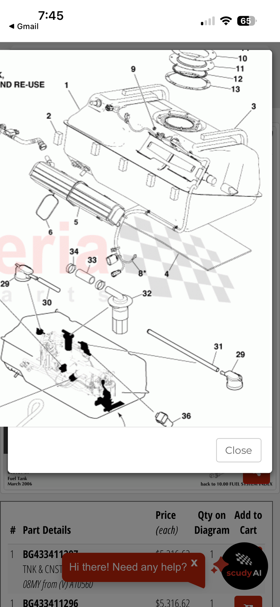

Fuel Tank parts for Aston Martin DB9 (2004-2012)
#31 inside the fuel tank is a common issue for the exact same symptoms and conditions you are describing. I'd put money on this being your issue.

For some reason I can't seem to get that to open properly to see it. What is the process for replacement, if you have done it? Thank you!
@Marmot see pics below

Thank you! How...obnoxious....is that to replace? It will be blind...and fume filled, I'm sure...

It's a really straight-forward repair. I usually just cut the end of the hose and reattach it. As someone mentioned, best to do when you have little fuel in the tank. I'm going to eventually replace the hose with a braided line or something, but for now I'm lazy.
