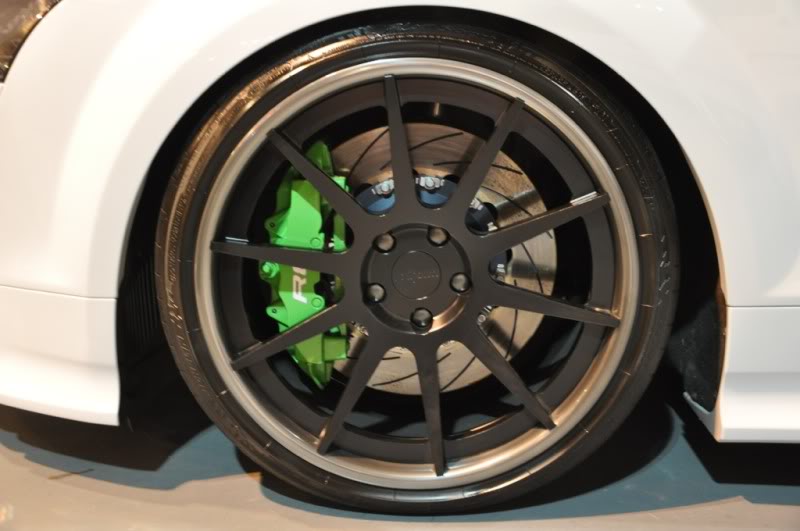

AP discs and r8 caliper

discs are about 1200 pounds sterling.
calipers can be had for 800 pounds sterling with the right contacts.
good pads are between 200-500 pounds sterling.
then factor in fluid, lines and installation costs
