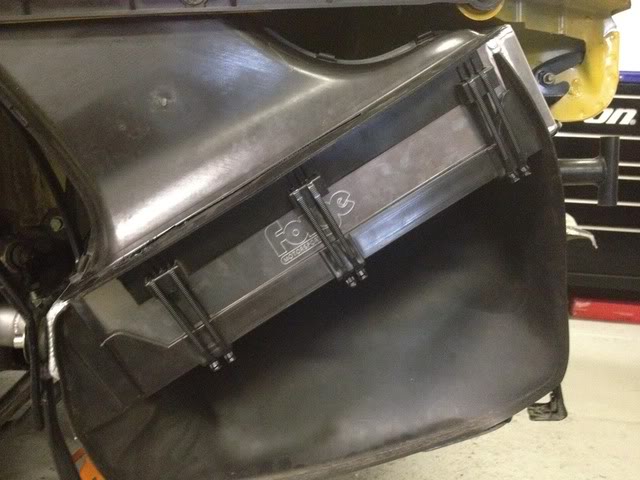

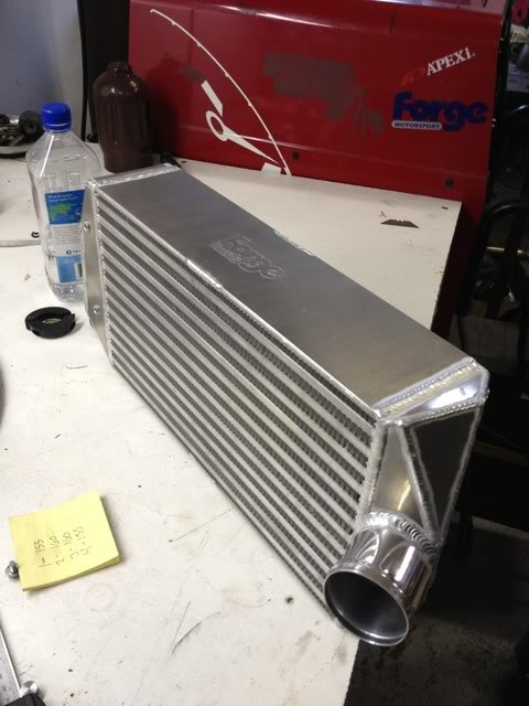

Over the winter I have been working on a few little things here and there. One of them was going to a full line of Forge Motorsport products for the 996tt. I started with just the silicone hoses and was very happy with quality and fittment so I got their latest and greatest 008 Recirculation valves with 23psi springs in them along with their brand new 996tt intercoolers. These are made in the U.K and my set is the first set in the U.S and the 2nd set produced. I saw really impressive results from the U.K test car, hopefully I will be able to gain from these as well on a higher powered car.
15.2 x 8.6 x 3.6 inches Bar & Plate Core.
Took a few weeks to get from U.K. They came in and we had them installed in a matter of an hour since my plastic shrouds were already trimmed for the 997.2 GT2RS units. Fittment was spot on and Forge hoses must be used since the end tanks get rid of the pesky C spring clamps.
I know first question will be why I decided to step up from 997 ICs and it really came down to larger free-er flowing/less restrictive cores, metal end tanks and no spring clamps. I was constantly paranoid that I was going to explode the plastic end tanks at my power level .

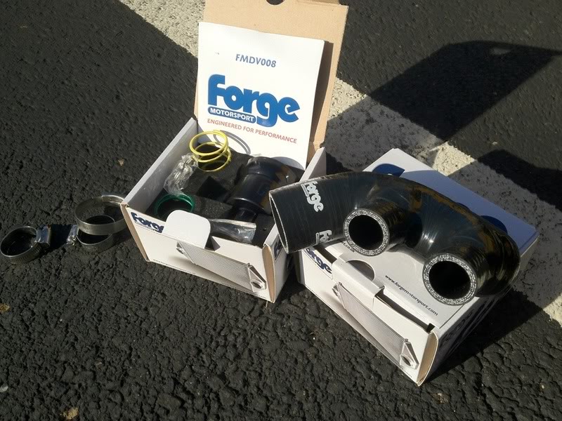

Forge 008 DVs and new F-Hose as well

I see the Apexi sign on the box, are they Apexi core? If so, these are nice, they were the best thing you could get for the rx-7 platform.
Thats a tig welding machine...

HAHA! i looked quickly at the first picture, i thought it was the box the intercoolers came in... Man i got owned!
thats a tig welder and he just stole my Forge sticker hehe jk
i'm not sure what cores these are. given that they are made in the U.K I would expect a eurpean brand though.
