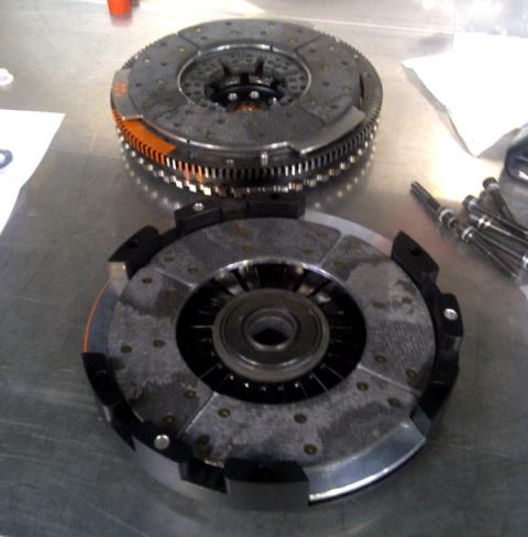

In April I got word that RPS has been producing private label clutch designed by ERP. Instnatly got my attention because few ex-vette owners sware by RPS triple and twin carbon clutches. Driveablity and power handling was suppsoed to be amazing.

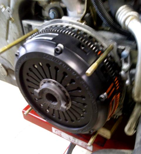

I have the new Version 4 in my car with the light weight flywheel and I will say it is fabulous. The light weight FW does not hinder the useability at all, actually it increases it due to quick rev matches for down shift throttle blips.
Like others have mentioned; the quality is there and the clutch is very user friendly. It is easy to modulate, it is smooth and it takes power really well. It is more cluch then my car needed but the overkill does not come at the expense of driveability like many clutches do.
Pic attached of actual Porsche unit on an engine and a bench.
Fabulous clutch, the ACT unit that was in my car before was so disgustingly hair trigger like it made for way to many rookie moments if one was not paying complete attention. Cary built himself a very decent part with this Gen 4 unit.

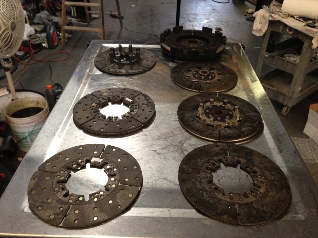

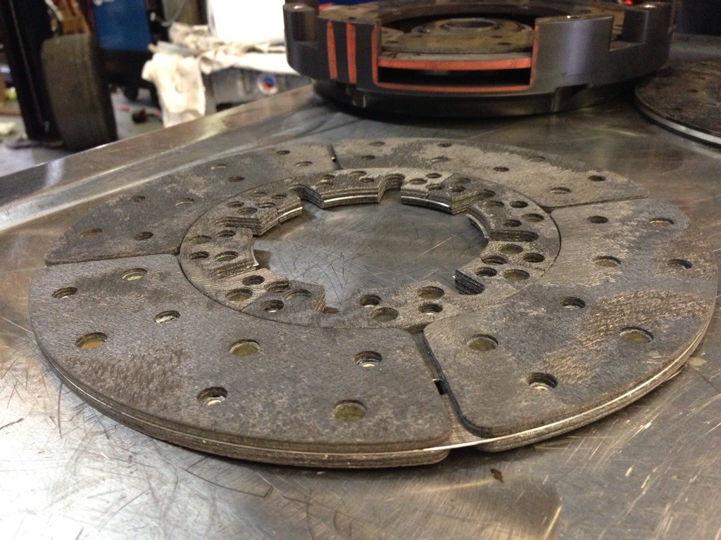

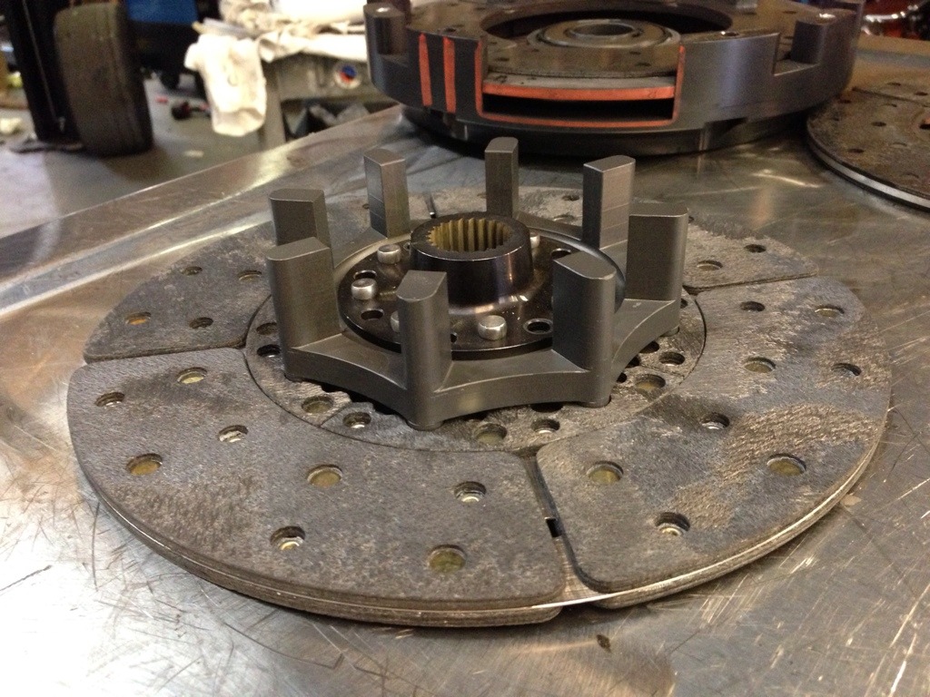

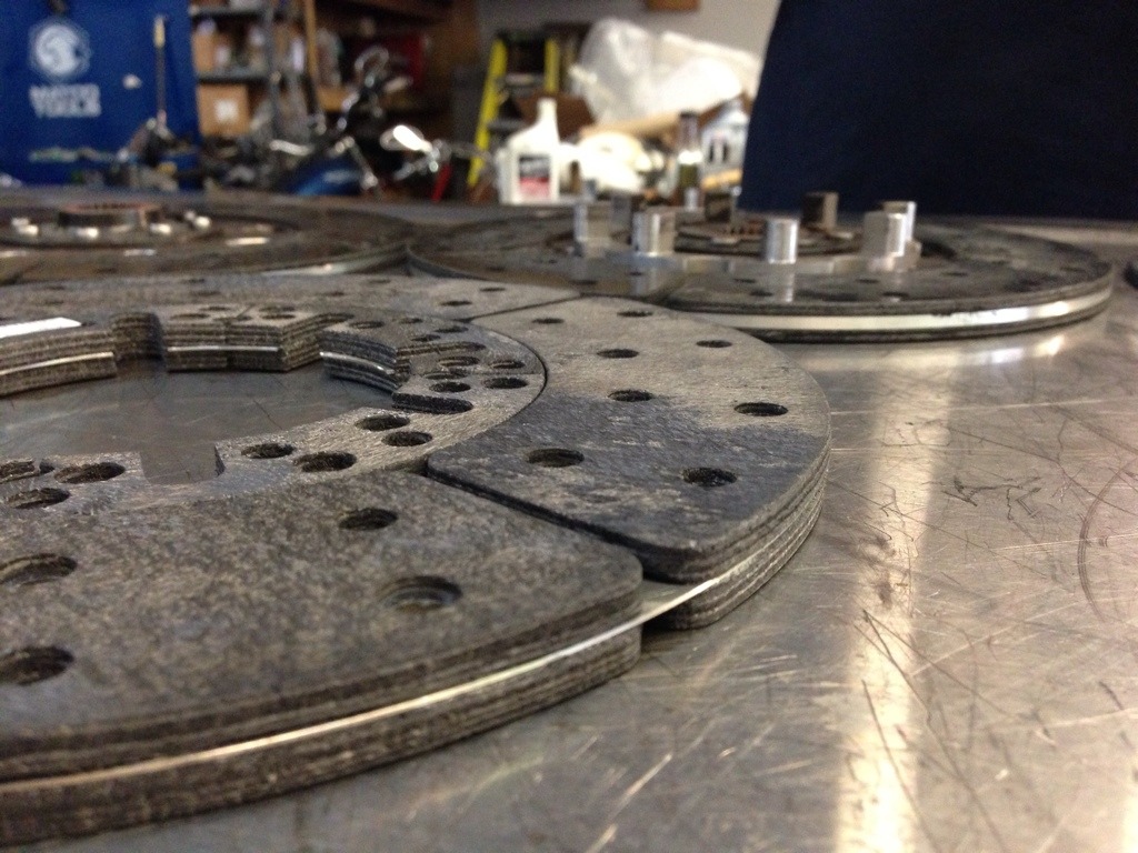

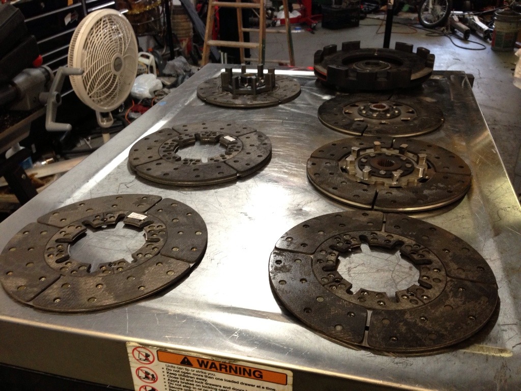

There has veen some revisions to the ERP clutch and Cary was nice enough to send me the latest and greatest v4 clutches and hub design which is the same setup as in Tims car. My car was one of teh early adopters of this setup so i had a slightly different setup. The hub is larger and centers the clutches better. I never had issues with my prior setup, but its nice to get the latest and greatest. you can also see the metal center plates in the clutch are full circle and not 4 petals, tehy are also thinner now leaving more room for carbon friction area. Tim and I were happy with the condition of the old discs after 4k miles of HARD driving or so there was zero clutch slip. Old discs are darker from all the burnt carbon dust, we didnt clean them.
left - new , right - old. notice the longer hub design on teh left...
more carbon, less metal
with the updated hub ..
notice the center metal disc. less metal, more carbon. we like ....
