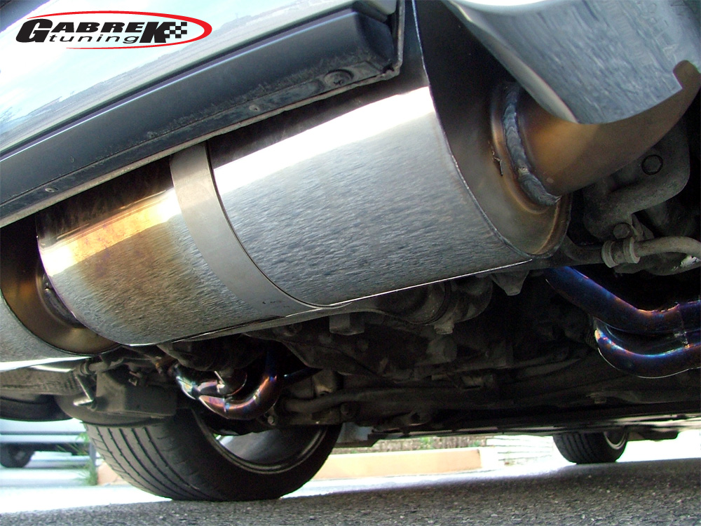

On my inner side muffler body cases,in that chamber part where the inlet piping empties into the outlet piping the stainless steel turns that color..
Yes from heat but I have seen that color on countless mufflers also,,as has been posted on other threads here also..
My stainless steel motorcycle race pipes they turn that color also..
I know and believe that I dont have a problem.
Any typical collector has a common merge point of high velocity hot gases which do discolor stainless steel or burn paint off..

Originally Posted by UrbanHotrod
Bad tune?
Clogged Cats?
are you suggesting a crappy 45$ catalytic converter can go bad that quick?
http://www.performanceexhaustplus.co...ml?mfg_id=1015
Very lean
if you look on any used exhaust system you can see color changes at where the "restrictions" are, its somewhat normal, i never saw purple on mine. in my case i was seeing darker gold shading at the X and I run E85 which produces lower EGTs then regular gas they were using on that 997tt.
#TeamAIM
This is a Picture from Milltek with there exhaust on a 996 turbo,as we know..
I can see different color shades on here in alot of areas..I believe this muffler system was not even on long..
