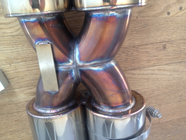

So several months ago Tim and I were working on my car and at about 1am he said lets get rid of your X-flow exhaust. I said no it sounds great . He said - "how about this: we put a boost tap before the X and take the car out on low boost 22psi. if the car has more then 1psi backpressure we are cutting it off". I said OK. Half hour later we had the boost bong welded up and ran a metal tube and then vacuum line to the boost gauge inside the car, we had another boost gauge showing actual boost.
Results: at 22psi of boost there was 6psi of backpressure before the X section. we cut the exhaust off.

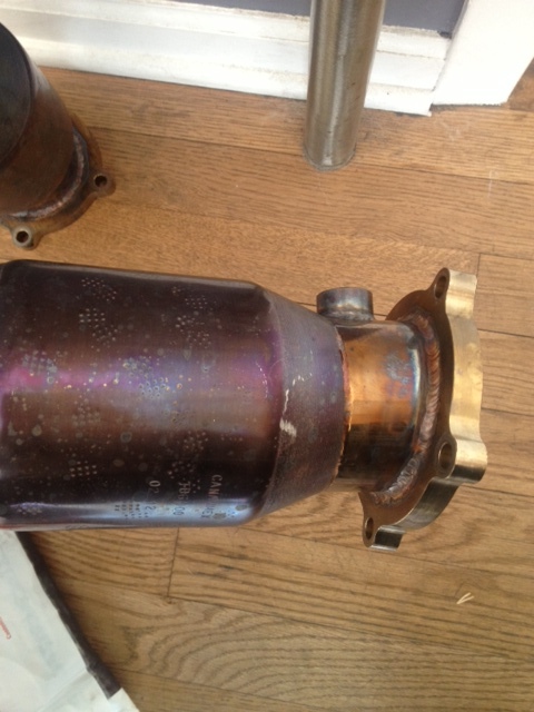

The client wanted a quiet 2.5" exhaust including all the piping from the cats and to the tips... also 2.5" ID of mufflers... not to mention with 100 cell cats.... thats probably good for upper 500s to the wheels...
With that said, AMS put on A28s and turned up the car to as you say 22 PSI... Had I known that I would never sell that exhaust to the client.... Not to mention the cat cores got dislodged from the inside probably due to HIGH heat caused by un burt fuel from tuning the car ....( verified with the cat manufacturer). Now , the car was just dynoed from my understanding... and this is what I got back- Yet I gave a full refund... you tell me if a handful of pulls will do that any exhaust? including yours ?
Had I known I would tell him he needs a full 3" catless... but the client didn't want it... wrong exhaust for the application was the case...

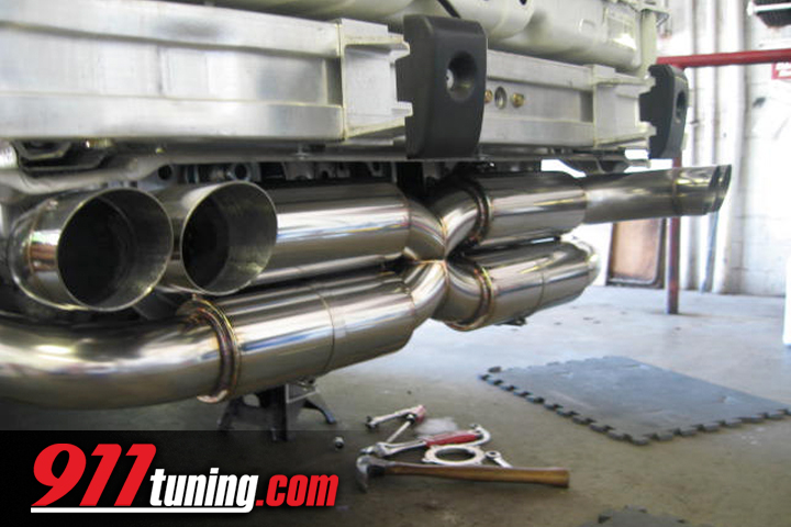

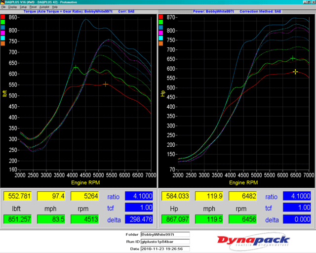

AS far as making power... the X we make does make 900 whp incl. our own 997.. no gimmicks no magic... sure a straight pipe will do better but thats not what we are saying nor comparing too... The AWE exhaust is all piping with one small muffler in middle.. The owner did not want a loud version which is why he opted for a quiet one with small ID piping and ID mufflers... I could have made a free flowing one no problem.
There are a few members making 700whp at 1.5 bar catless 3"... and this is our 997 with TIAL 30rs NOT 28s making power... 870 and look at the TQ

I would imagine that the x-flow design would be contributing to the backpressure along the same lines as an external wastegate dump being recirculated into the exhayst. The competing air flow it seems, would add to the backpressure and be robbing of some HP for sure. I'm curious to see however, if it is possible to fab a system that is as quiet as some of the x-flow designs, without using the x.

i believe you. the X I had made over 900whp on a dynojet as well and not a hub dyno. however we found that it was creating 6psi of back pressure in the exhaust before the X at 22 psi of manifold pressure (boost). very simple test. so we cut it off because it was holding me back from making more power

I believe that the way that an X-pipe merge would be the best,at least in theory, would be to have the both sides do a complete 180 bend and then have a common window/chamber connection between the two..
Matter a fact I might be getting a 2.75 X- pipe like that to compare on the dyno against my Milltek in which I modified it to be a 2.75 system also?
