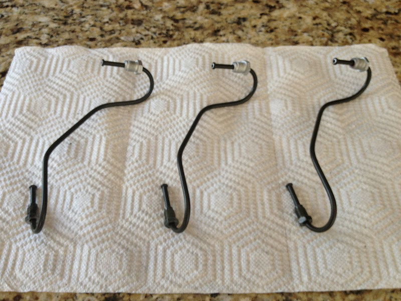

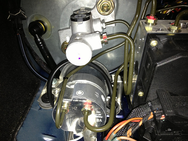

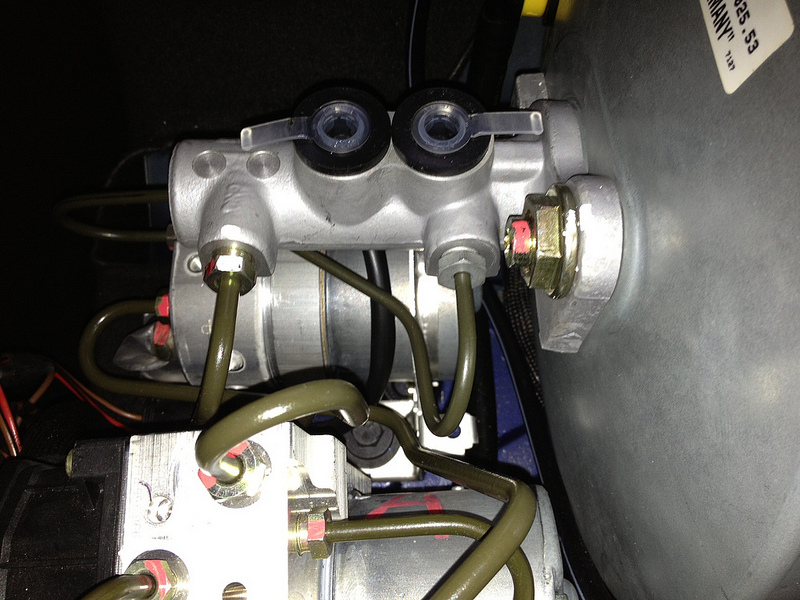

This custom brake line will allow you to retrofit your 996TT with the larger 997GT3 brake master cylinder which has a larger piston thus moving more fluid and providing a much stiffer brake pedal compared to stock.
The stock 996TT brake master cylinder has both front and rear 10mm ports while the larger 997GT3 MC has a front 10mm port but a larger 12mm rear port. As a result, a custom brake line with a 12mm(MC side)/10mm(PSM side) must be used.
**(997GT3 master cylinder NOT included)**
The custom lines are built with the required 12mm and 10mm nuts and an OEM quality ISO bubble flare on both ends. The lines are pre bent making install very easy and only needing "fine tuning" of some of the bends during install to get everything to line up perfectly. This is very easy to do by hand as the tubing is very pliable.
Price is $130 per line plus $20 shipping CONUS. I have 3 lines available.
