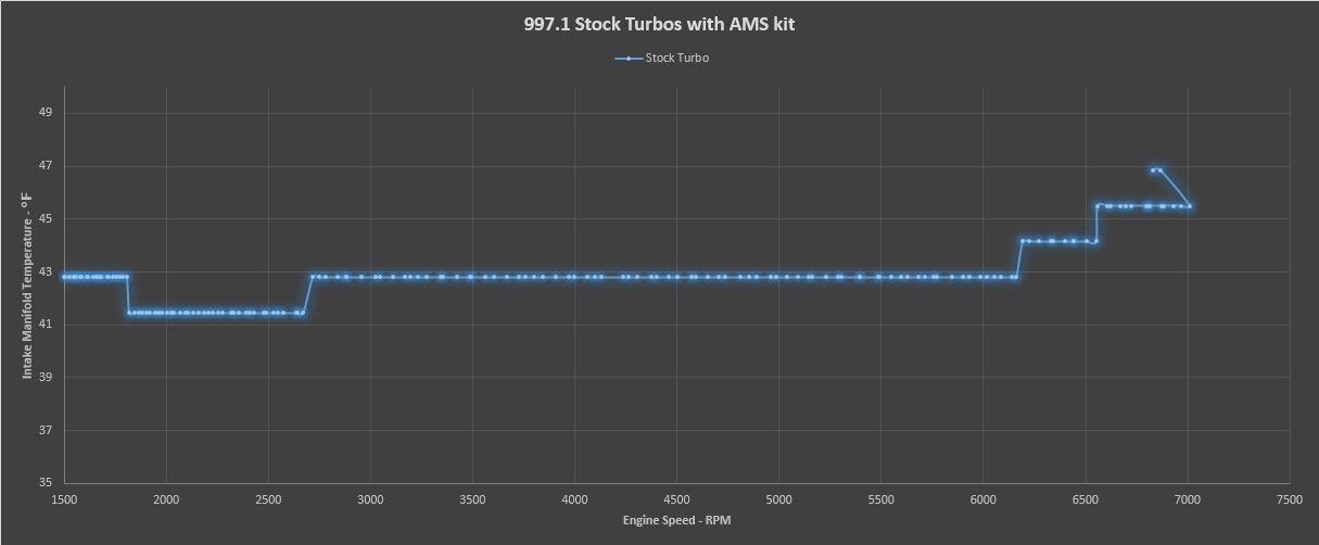

I can vouch for the AMS kit also, it has performed well on my car. For my purposes, a street car, they are awesome. I don't have data on a track so I cant debate on performance in that environment.
Below are plots of one of my logs in 3rd (both temp and press, same data set). Put the car in 3rd gear below 1500rpm and went WOT. Judge for yourselves on how laggy or not laggy it is.
On the Garrett kit, it will be a great set of intercoolers. I have used their cores on many projects with great results. Great to see we have more options.
