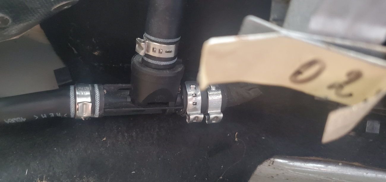

Hi All,
I'm considering bypassing the entire system behind the rack and rebuilding it above the engine.
I'm looking for these two parts:
Photo credit JohnnyHotspurGT
Another pic:
These aren't available separately from Bentley. I could order the whole line system but oof!
These little parts connect to the two intake manifold vacuum lines that drop down and back behind the steering rack. They are wrapped in a cloth foil heat shield normally.
Probably need someone who's bought a wreck to source other parts.
Thanks!

Hello,
Those items are barbed "T" s, auto parts store item. I don't recall the size that fit the id of the tubing.. maybe 8mm (5/16in.) or slightly more...cheap enough to trial and error.

Originally Posted by 1eapplebaum
Hello,
They actually have ventures molded into the body. I wish standard T fittings would work. The line off the vacuum pump has standard T fittings though.
