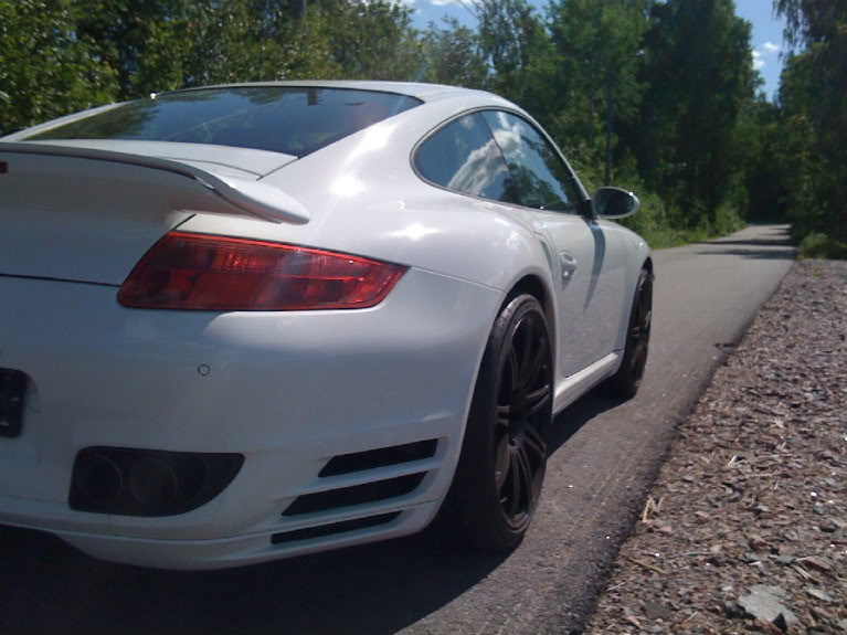

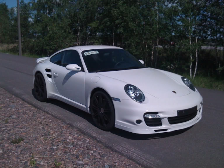

I have 911 turbo as well. I have TechArt performance package and I just love the exhaust. It's a world of difference compared with the stock. What side skirts do you have?

Nice 997TT...I have the techart aero kit on mine which includes the side skirts.
