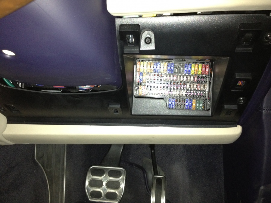

Hi
Its a 2007 private import from UK to HK.
I just called Bentley of Surrey and spoke a very nice service guy called Simon. Gave him my VIN and told him I couldnt find the lever as stated in service manual. He states the level was removed from 2007 onwards thus to remove the trim panel. One must insert finger into trim gap at bottom right and PULL TOWARDS yourself. If done correctly the complete panel should pop off as it is no longer hinged. The service manual I have isnt updated to reflect this change yet.
I also asked easiest way to insert cable through firewall which is via grommets on either side that run from engine into cabin. When time allows I will start to explore more for some DIY fun.
I will get pictures posted up once I pop the panel off.
J

Thanks everyone for the pointers as I've finally cracked it!
As informed by the Bentley service guy the panel just pops off so with good old tug off it came, pictures below.
Nice to meet another fellow DIYer ccwboy . I took off the roof module to splice into switched live for a car cam install but shorted out wires thus needed to remove fuse cover to replace the 5a fuse. Car came with USB/ipod cable already installed from factory inside glovebox. I still need to find a way to route cables into cabin. What color is yours CGT, mines dark sapphire blue.
J
J
Thanks JC...I had the same problem with my 2007...no handle anywhere....I thought I was losing my mind!
