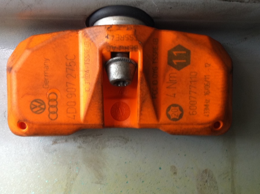

Here is the TPMS sensor on my CGT 05, You can go to every Audi, Volkswagen service to buy it (I bought a orange now, it will last longer and it is a new model) and with VAS or ROSS-TECH VCDS you only have to reset TPMS and it will work. For US model it have 433 MHz and the number of part is 4DO 907 275
and here is the new one on my car
