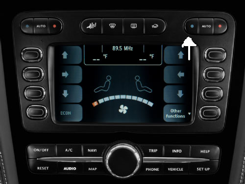

First check the blue/red 'toggle' black oblong button above the large central display unit and keep pressing the Blue side of said button. It also could be a control flap malfunction, which is a dealer diag and R/R.
EDITED: Also check the same type of button, yet it is more central and higher up (not seen within the photo below)
So I have to keep pressing the 'blue' button until what ??

The blue button should work an internal flap, so my guess if after pressing the blue a few times that flap should be set to all 'cold'. Then the problem should go away. If not, you may have a stuck flap and it could be a simple fix as have done this type of fix in other vehicles. It is a common problem per se with various manufacturers that happens from time to time due to debris or other factors.

sorry for bringing a dead thread back, but holding down the blue button does what?
resets the position?
also my problem is, if i press "auto" and hit "blue button" until it says "COLD",
the air does not blow towards my face / foot. seems like the actuator is stuck at some point. BUT, if i hit "manually" blow to face/foot, it blows cold air for a sec or two, and go back to where it does not blow anywhere, but I could hear the blower motor working.
it blows cold air to defrost windshield, but no face/foot.
any ideas???

Tried but I don't think it solved the problem. Only the dealer can fix the flap ?
