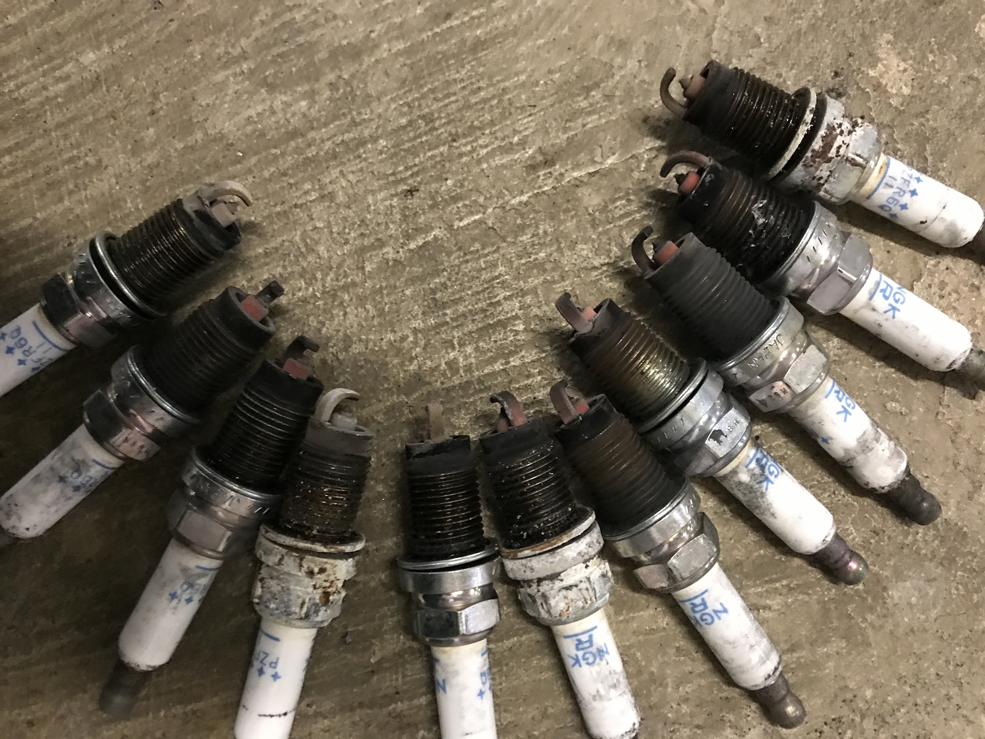

Finally did mine with new coils too. Some of my cable conduct was cracking so had to patch up with insulating tape.
Took me 5hrs but I was going real slow and that included a run to the shop for more supplies.
I used Bremi #20112 coils and OEM NGK R PZFR6Q-11 spark plugs.
Thanks to John V for the DIY.
J

Why only 11 of 12 spark plugs on a W12?
J
Was there a reason that you only replaced 11 of the 12 spark plugs on your W12?
