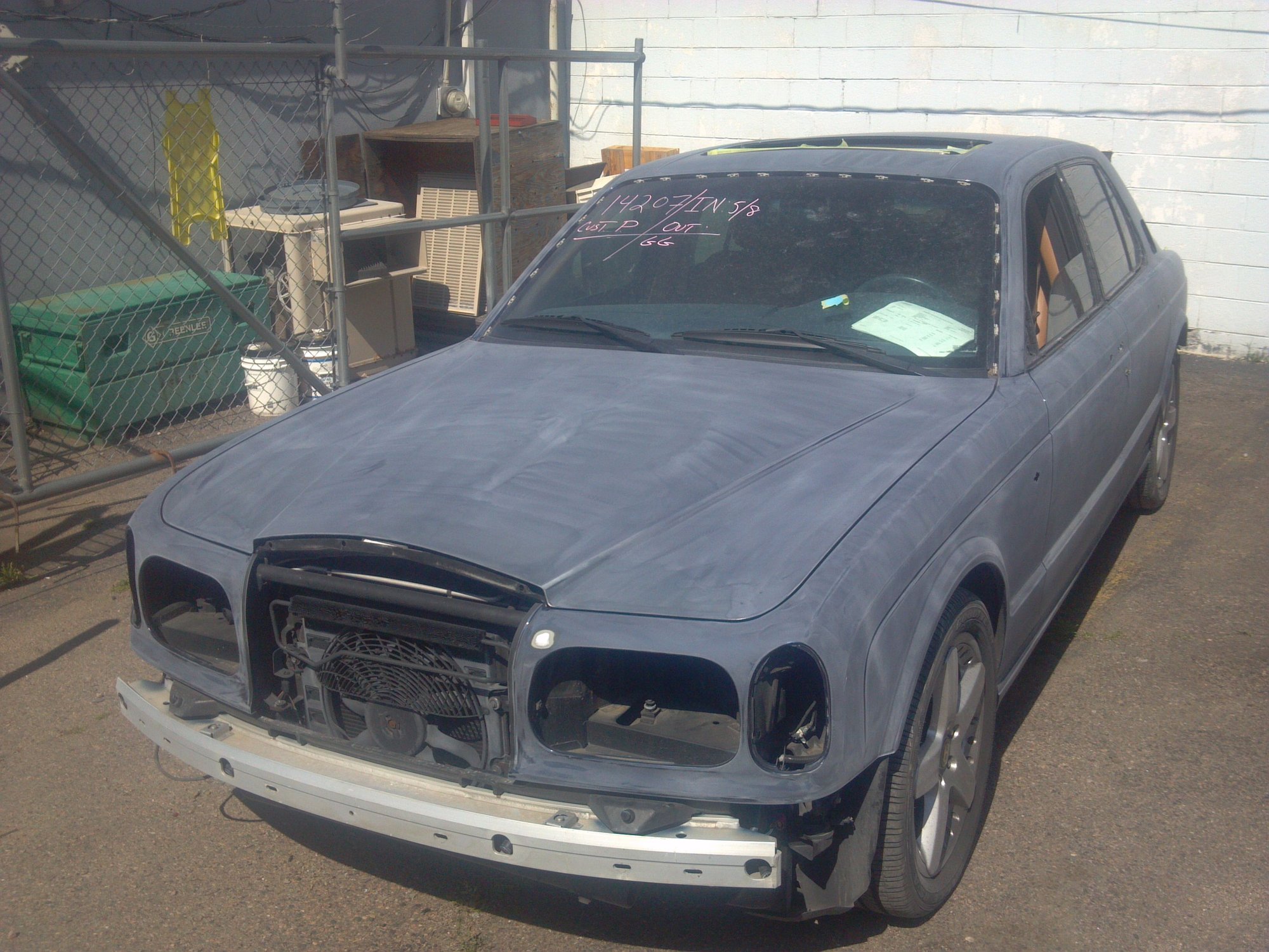

I have had my 2003 Arnage-T for 3 years and so and enjoying it immensely. I since also acquired a 2005 Continental GT. It is surprising how different the models are.
The BMW powered Arnage's are cheaper to maintain, but pretty gutless. Hence I purchased an Arnage-T. I really enjoy the power it has.
The most common issues are suspension related ones, like the gas spheres and shocks. Each shock costing $1-1.2K each and made by Sachs, so I cannot find a less expensive cross reference. The Spheres runs out of nitrogen gas and parts costs $400 to replace (easy to do). I hope and pray I am never going to have cam issues with my car. I have however seen many Arnage's over 100k miles with no engine issues. I am a firm believer, a driven car is more reliable than a garage queen.
When I purchased my car, my alarm/door/lights/remote key...etc ecu was bad and Bentley wanted something like $2400 to replace it. I instead rewired the car and installed an Easycar Alarm ECU . It now has 2 way remotes with 1 mile range, secure key, remote start, proximity door openers, knock sensor, folding mirrors and much more. This is much better than the legacy electronics the Arnage comes with and was only $400. What I am trying to say the car is not too bad to work on. I actually pretty much already took most of my car apart and reassembled and painted it (and it still runs).
From this to:

Wow, incredible blue color!
Old Dec 5, 2014 | 12:01 PM
Zaos's Avatar
Joined: Nov 2014
Posts: 192
From: Belford, NJ
Rep Power: 42
Zaos has a reputation beyond reputeZaos has a reputation beyond reputeZaos has a reputation beyond reputeZaos has a reputation beyond reputeZaos has a reputation beyond reputeZaos has a reputation beyond reputeZaos has a reputation beyond reputeZaos has a reputation beyond reputeZaos has a reputation beyond reputeZaos has a reputation beyond reputeZaos has a reputation beyond repute
Thanks,
I painted the base blue, clear, blue (like candy paint), then a glamor style clear which gives extra depth.
