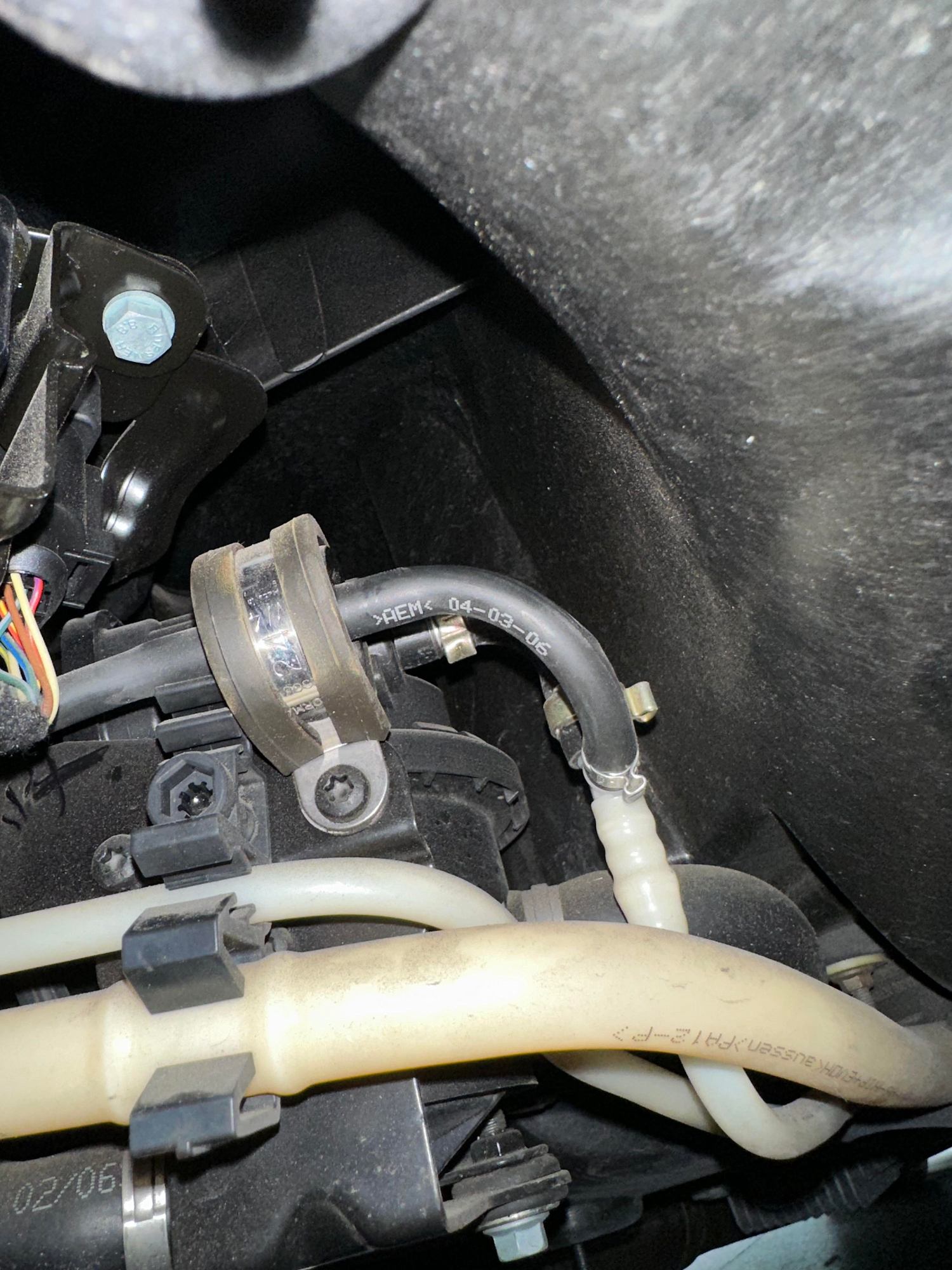

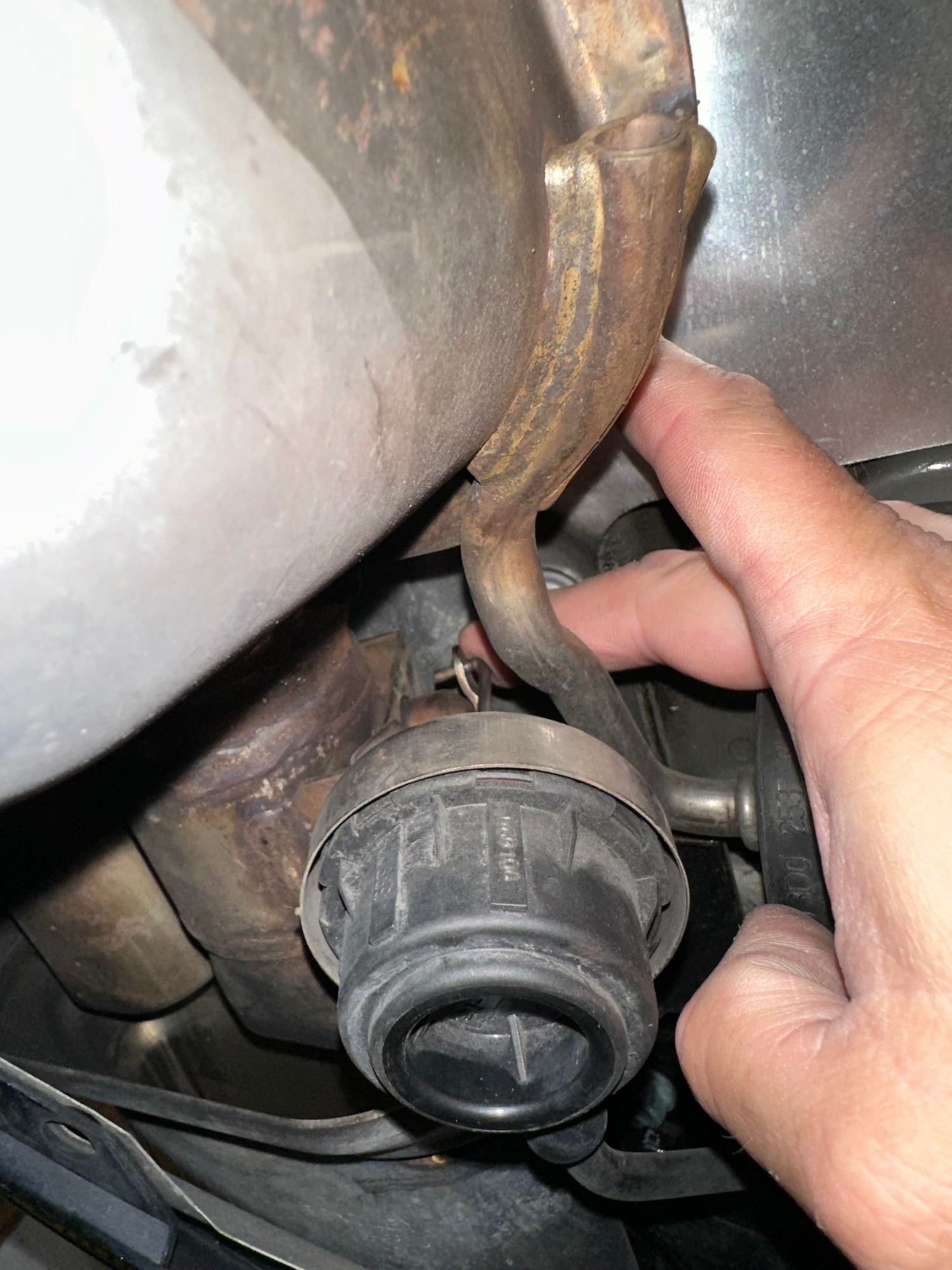

Well I was able to spend some time today under the Bentley. I did notice a few things. The actuator that moves the flaps was a little different than the ones in the other pictures. They had a black bottom not white. After investigating a little it appeared that the actuator was not pulling hard enough on the flapper to close it all the way and hold it closed. I was able to push on the flapper with a screwdriver and the rattling stopped. My thoughts are that there is not enough vacuum to hold the flapper shut tightly. It could be that there is a leak in the tubing before the actuator or the diaphram in the flapper actuator is getting weak and can't pull the flapper hard enough. It looks like the flapper actuator is part of the muffler as it was welded on. I decided to try plugging the vacuum line that feeds both mufflers and it worked like a charm. No more rattling and the sound is not that much louder. The check engine light did not come on.
I did notice a few things. All of the connections on the vacuum lines had flexible rubber lines connected to the part or tee the the smaller diameter hard plastic lines were inserted into the rubber lines. The date markings on the tubes were all from 2006 so I think they are original. I wonder if this was the fix Bentley came up with for the small hard vacuum hoses cracking at the barbs.
Actuator (black bottom) with my finger on the flapper shaft
Rubber line from the actuator to the small vacuum line.
Tee from main vacuum line to the muffler flappers. This is where I plugged the line.
Golf Tee in rubber hose and stainless cap screw in smaller vac line going to flappers
I clamped the golf tee in place with a worm clamp and wrapped it in electrical tape so it does not cause any issues. I also put the lines back in the holders so if I decide to revisit the issue later it will be easy to reverse what I did today.
