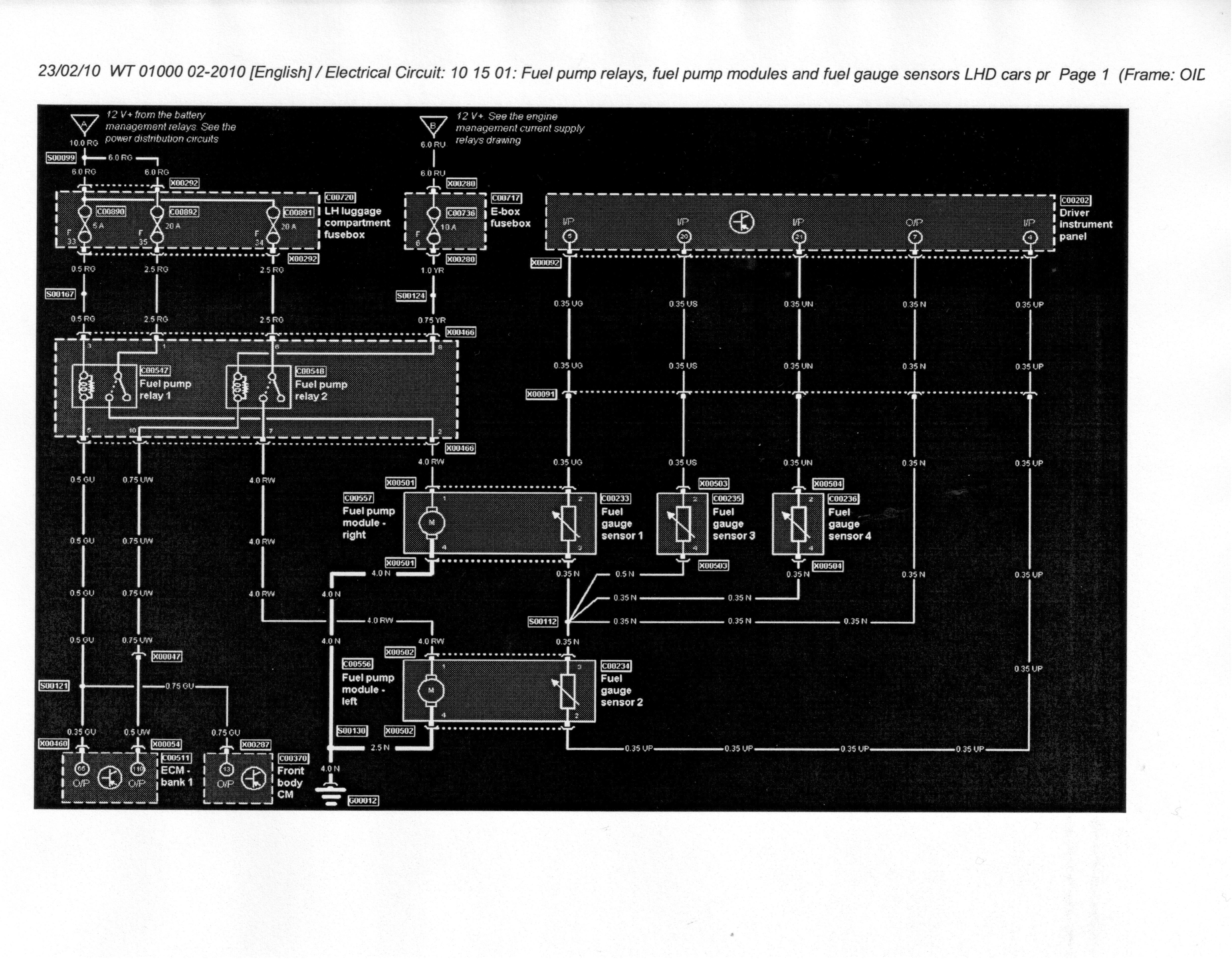

Originally Posted by PMS
here is the wiring diagram
Hi peter long time no chat.
Does anybody have a clear version of this diagram , I seem to have the same issue as listed here. I may try an overlay.
Hi Rob: Hopefully this hi-res pic is easier to read. double click on the pic to enlarge it. Let me know if you need anything else. Are you back in the GTA?

Originally Posted by bentleytech
yeah you can't do that,pump 1 comes on for 20 seconds and then pump 2 comes in which is controlled by ecm,you may well have fuel pressure issues with them both running constantly. i am pretty sure the overlay will fix it either from the fuse or ecm wire to relay is faulty, lets see if this fixes it and then we can go from there as to the repair.
Hi mate! Could you let me know where I should do the overlay, I am going to attempt to do it, I have this diagram scanned it, just not sure where to jump for the over lay

my car threw the p0203 malfunction in relay, but it ran did not stall out.
I ended up doing an overlaywire from the ecm to the relay,
pin number 65 X00460 on ecm-bank 1 .035 GU [green with blue strip] was bad, ran the new wire to the back of the relay, ran it thru the interior.
This is the 2nd time I had to do an over lay first time for the o2 sensor on the same ECM bank 1.
This over lay stuff is a pain in the ***.
