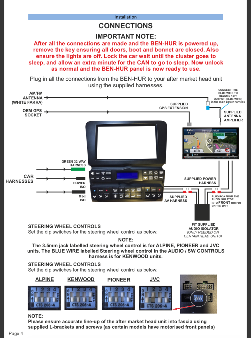

Audio compatibility with the BenHur ...
NOTE: only one set of RCA's are used when using the stock amp ...

Thanks ... Ok that makes sense using the sub out from the head unit, I have an extra **** to control the sub its easier than keep going to the settings on the head unit to turn it up or down, it runs straight off the 5 channel amp, Ive not used the sub out on my head unit.
So your using the Ben-Hur with the stock amp that means you only using from or rear outputs, thats ok but as I keep saying one is still loosing one set of channels.this means one cant control the Left/Right & Balance from the head unit all functions are done via the Ben-Hur. Personally I think at some point you will end up installing a 4 or 5 channel amp then your going to hear a totally different sound, even the sub will be more punchy.
As long as you're cool with that then all is well. Glad you got it sorted, boy you have had more than your share on that car, but you slowly getting it sorted, good man ...

Hello My Friend ... Nice to hear from you ... Sounds like your rocking with the system mate ... cool.
1 question when you say your balancing left & right or fading front & rear are you doing it through the Alpine or the Ben-Hur, you going to get fed up of me saying this but Ive got to make sure its right for you,
The Ben-Hur only uses 1 set of channels that means one cant use the fading & balancing on the head unit, this means when the head unit was connected with the Ben-Hur only the front RCA's or rear RCA's were used.
