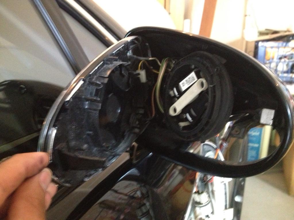

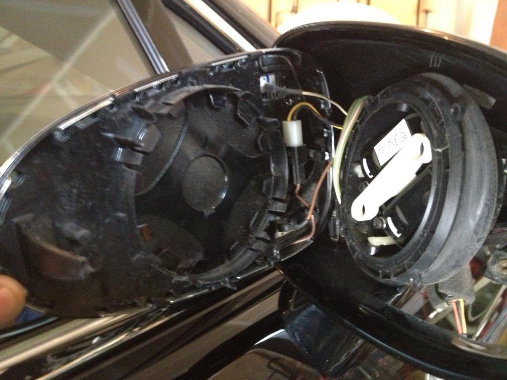

Hi folks! Thought I'd share pictures of my replacement process so it might help another user in the future. I personally did not find any visual material as reference before going into it. However, the overall process was very simple. Turn both of the mirrors all the way IN and UP. Then gently pry the right mirror glass with your hands (use thin latex gloves) from the bottom right side of the mirror. Do the same with the left mirror glass expect pry from the the bottom left corner. Hope this helps. Cheers!
I used 2 of these bulbs: http://store.ijdmtoy.com/Mercedes-C-...2q.htm&click=8

I got the same LEDs and followed the suggestions, it works like a charm!

Update: 1 year later, those bulbs still work like a charm!

I believe what everyone here is missing is the fact that PUPDOGG states that he is changing the "turn signal bulb" in the side mirror, when in-fact it is not the "turn signal bulb" at all, what he changed out was the puddle light from incandescent to LED.
The turn signal in the side mirror consist of 7 LED's as pictured.
EDIT:
I changed the description in the thread title from "Turn Signal Bulb" to "Puddle Lamp" to clear up any confusion as to which bulbs infact were changed out.
