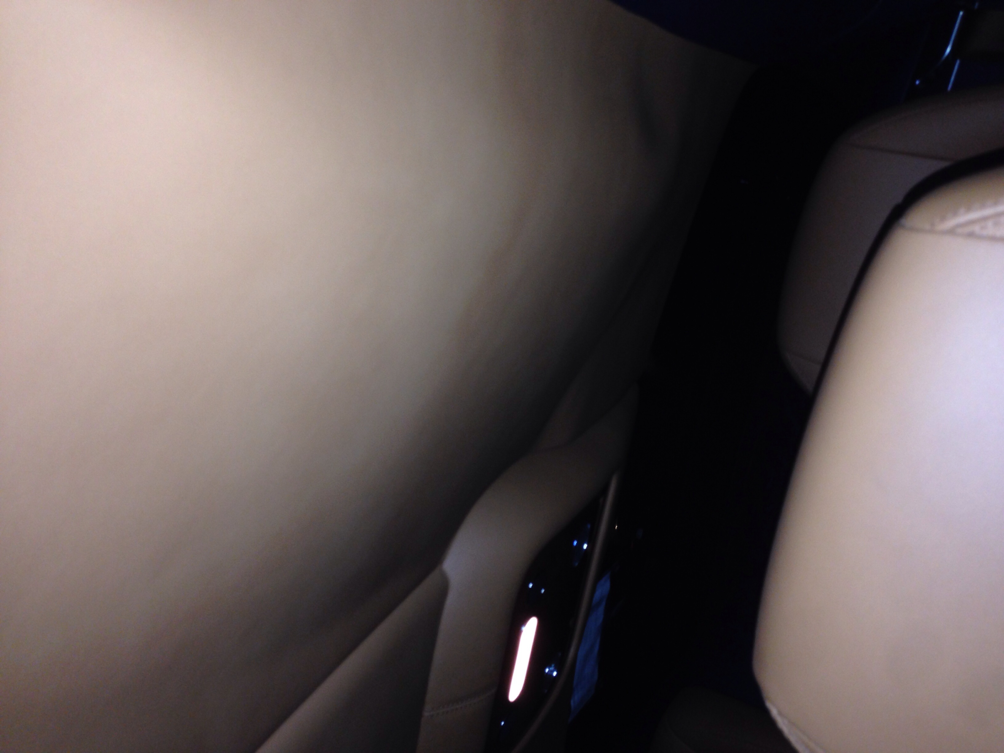

So I had a gt just like this one previously and found a good deal on another one for my wife. Having a few issues and need some direction.
Problem #1
Head liner sagging in both driver and pass side. My local interior shop wants little to do with it. I'm awaiting a quote for a new one from my closest dealer in Dallas. Has anyone dealt with this? Are there any suggestions for repair?

the headliner sagging is a common problem on the early cars,have a new one fitted or get it repaired ,TPMS is probably the ecu,if somebody just replaced the sensors it will not work correctly,can you see how much battery life is left in sensors (use vagcom,if you have one).the overheating message...are there any codes stored in memory,is left hand battery good and the service now lite has probably not been reset correctly,you can reset it through using the steering wheel but the correct way is by using a diagnostic tester plugged in and resetting that way.

Shop should get a vag tool, its a very cheap investment to scan all these cars. You can probably recode the tpms sensors with it and just shut them off, you can do it with the vag tool on the audi so i don't see why you couldn't on this.
Find another shop for the sagging headliner, the dealer will probably bend you over. My best advice is to find an independent shop that works on these because these cars can be very pricey to repair when broken.

If the leather headliner is in good, soft condition, it needs to be completely removed and re glued. It cost me $600.00 to have it re glued since my headliner was in good shape.
