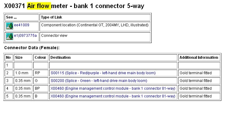

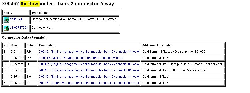

Glad to see you seem to have solved the problem. For your reference, what we (on this side of the pond) call Mass Airflow Sensors, the manual refers to them as Air Flow Meters. You mentioned that one connector has five wires and one has four. When I chased a problem somewhat similar to yours, I was concerned about the different wire count. The difference is correct. Here are the two wiring references for the Airflow Sensors. If you want the schematics, please PM me.
For what it is worth, the mistake I made was to replace both MAFs before I discovered my problem was only with the connectors. Anybody need two used (but fully functional) MAFs?
