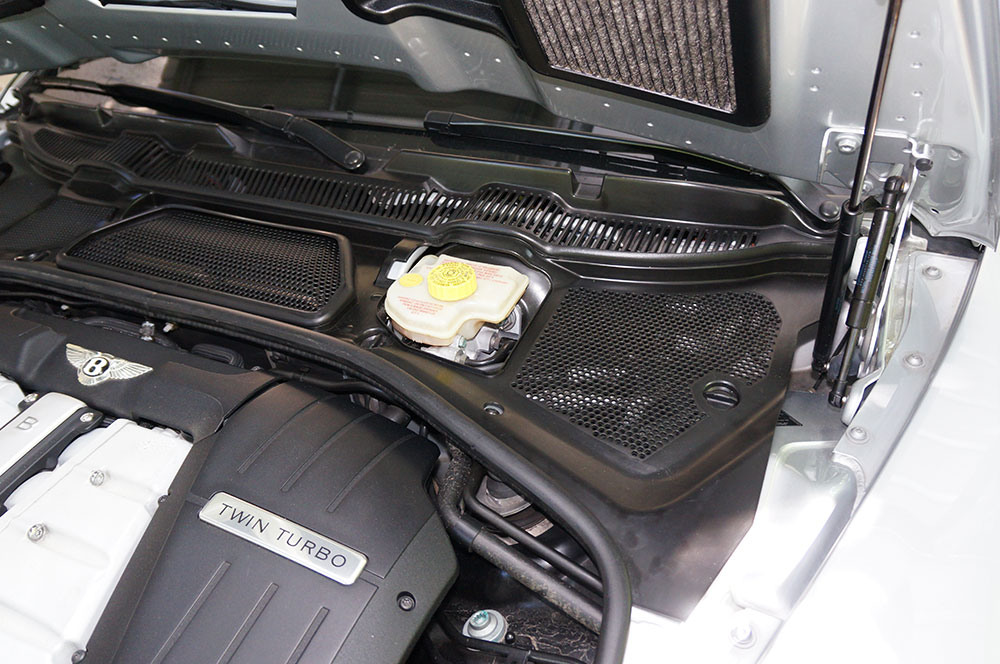

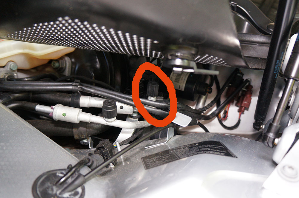

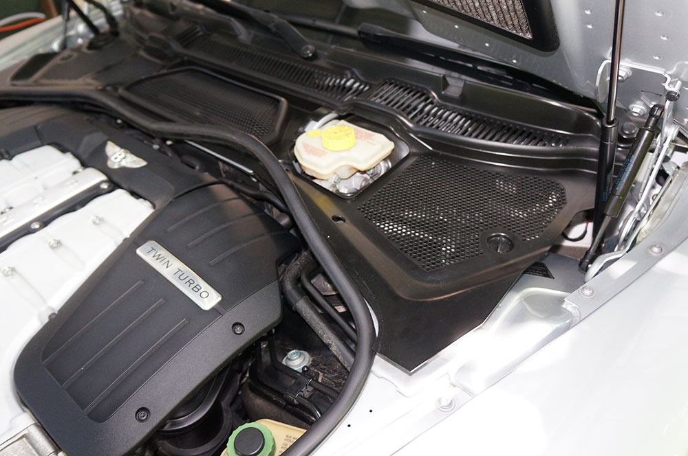

No need to remove wipers at all. Just remove the long, rear plastic cover in the engine bay and you're there. Takes about 40 seconds max to remove. You will need to push away a bit of the rear engine bay plastic seal to remove the long plastic bit. It is VERY easy and intuitive. Common sense and a gauge/R134a is all you'll need if it is a simple refill job. Just remember to not overfill and the opening in the rearmost (towards trunk) black plastic cover. Oh hell, it'll take me 5 minutes to take photos, so will post pics below in a second or three. Need to go out there and remove things. Ok, 5 minutes and i'll be back with pics.
$600?!? Really? After looking back at my engine-out invoice and the reaming job on parts costs, seems to me Bentley Service is getting too high $$ for the 'value' so am going to seek elsewhere for servicing the B quite frankly unless it MUST be something only they can do (read: reprogramming things).
PS: Before R134a filling, start car and run the AC as cold as she can. The R134a has instructions on the bottle, simply read and follow them and look at gauge on the refill hose
$600? Really?!?! For a 10 minute job?

CORRECTION: You do not need to remove the ENTIRE plastic cover, just the rear right side. See pics below. And notice the time stamps on my posts, THAT is how fast and easy it is including taking pics and Photoshopping them
Just DO NOT overfill. A little less is better than a bit more. You can always refill in 10 minutes around 4 years or so depending on your AC use
