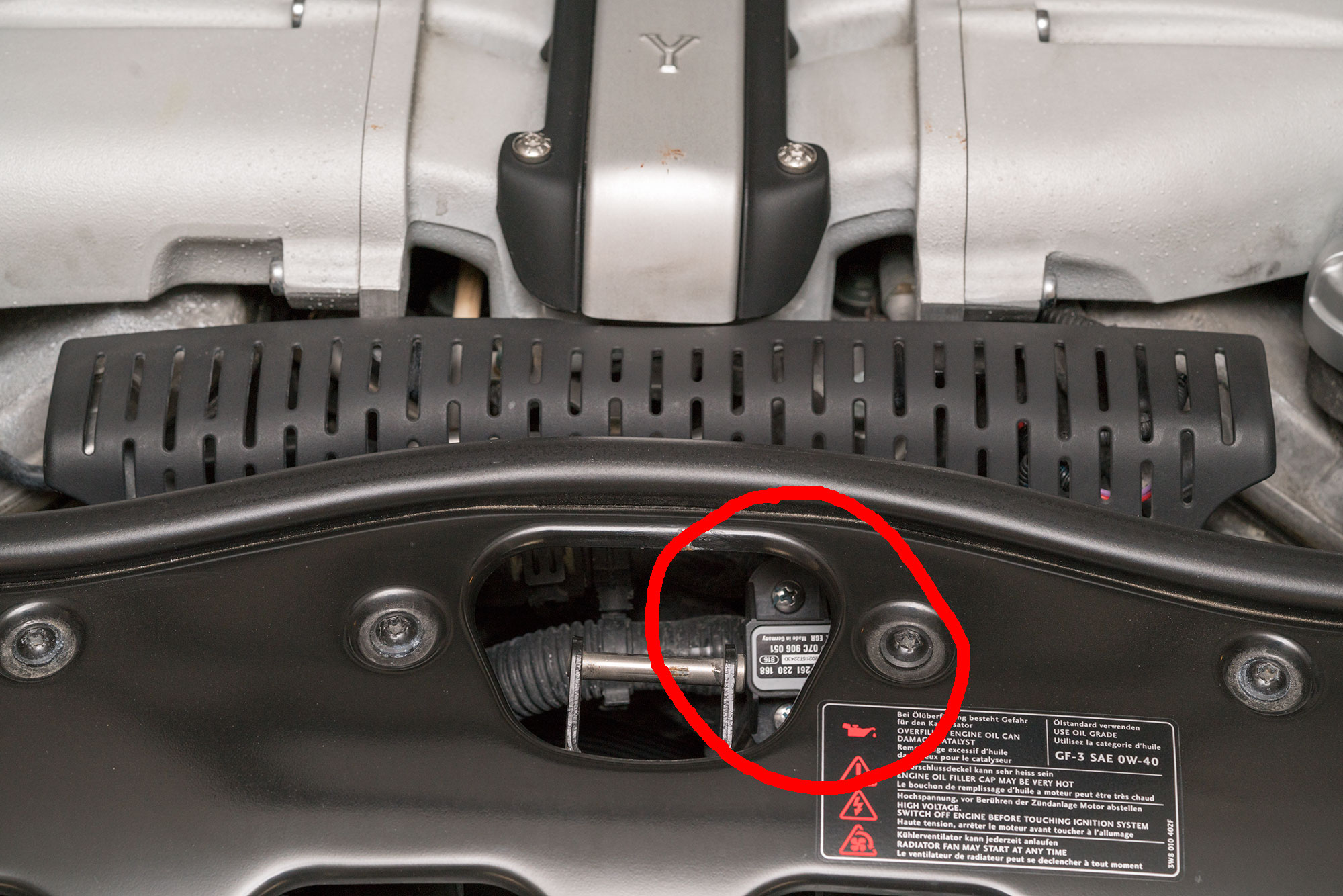

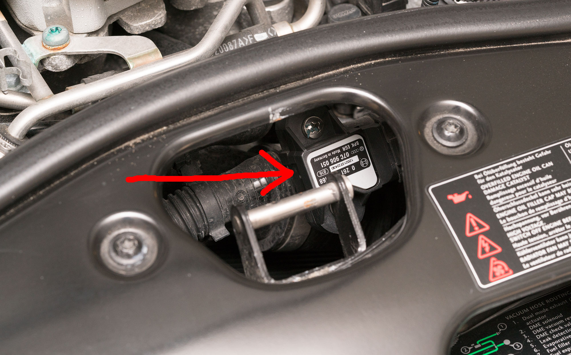

Bentley GT / GTC Error Code P2438 Fix
ERROR CODE: p2438 air injection system air flow pressure
Part needed: 07C906051 ($60 or less)
The procedure is as follows.
Open hood
Remove the plastic small black cover by pulling it towards the front of the car. This gives you working room.
Remove the two stock black ALLEN bolts (one top, one bottom). FYI: Stupid me dropped one during reinstallation so I used Phillips when reinstalling. It is a bit tight to get access to the lower bolt yet very doable and not really that hard.
Swap defective old for new part.
Reinstall screws HOPING to not have one drop onto the black hole of the car's lower aero (I used Blu-Tack as you can see on the bolt head).
Reinstall small black plastic grill bit
Clear error code.
You're done.
BTW this circuit is only used during startup so no damage or symptom during normal operation is what I've been told.
