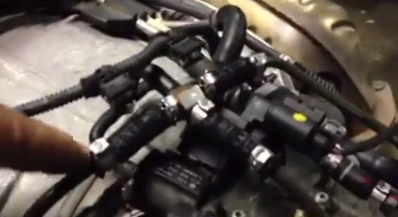

Found this excellent video of the GT clearing showing the hissing from a smoke test and after video with replacement metal vac lines.
Indy in this video commented vac lines are a common problem from 2004 to early 2006 but some of our 2007 members also have this problem. Did Bentley ever resolve this problem before the new model came out?

Interesting videos...
After viewing both, I found the Part 1 video segment, which shows the vacuum pump location.

Indication(s) of problem
As I own an '07 GTC - this plastic vac line issue concerns me. Would you please state your initial observation(s) that a problem existed which would
require a repair. Thank you.

Loss of power... Engine stumbles... engine light turns on. I noticed a loss in power when first getting the GTC and seems it took a bit longer for the light/problem to truly rear their ugly head. If I had not had a previous GT, one would probably not notice the loss of power before things get too bad and thus stumble/engine light.
Have a smoke test done on the car.

Hello People,
I am glad that the videos I posted have helped people see the issues these cars have had.
The vacuum line configuration has changed in mid 2006 and up. There are other areas on newer models that have leaked from the plastic connectors cracking, I will post pictures soon. A good way to perform a quick check is to start the engine and open the drivers door,( so you can hear the vacuum pump ) count how many times you pump the brake pedal until the pump kicks on. It should be at least 3-5 pumps to kick the pump on. If you can hear the pump run all the time and never kick off, you might have a vacuum leak.

And for us Brits, it's the passenger door. The pump is behind the left front wing/fender.
I only became aware of the problem when the Indy doing the service found it.
I'm glad Bentley seem to have addressed the problem on later cars.
