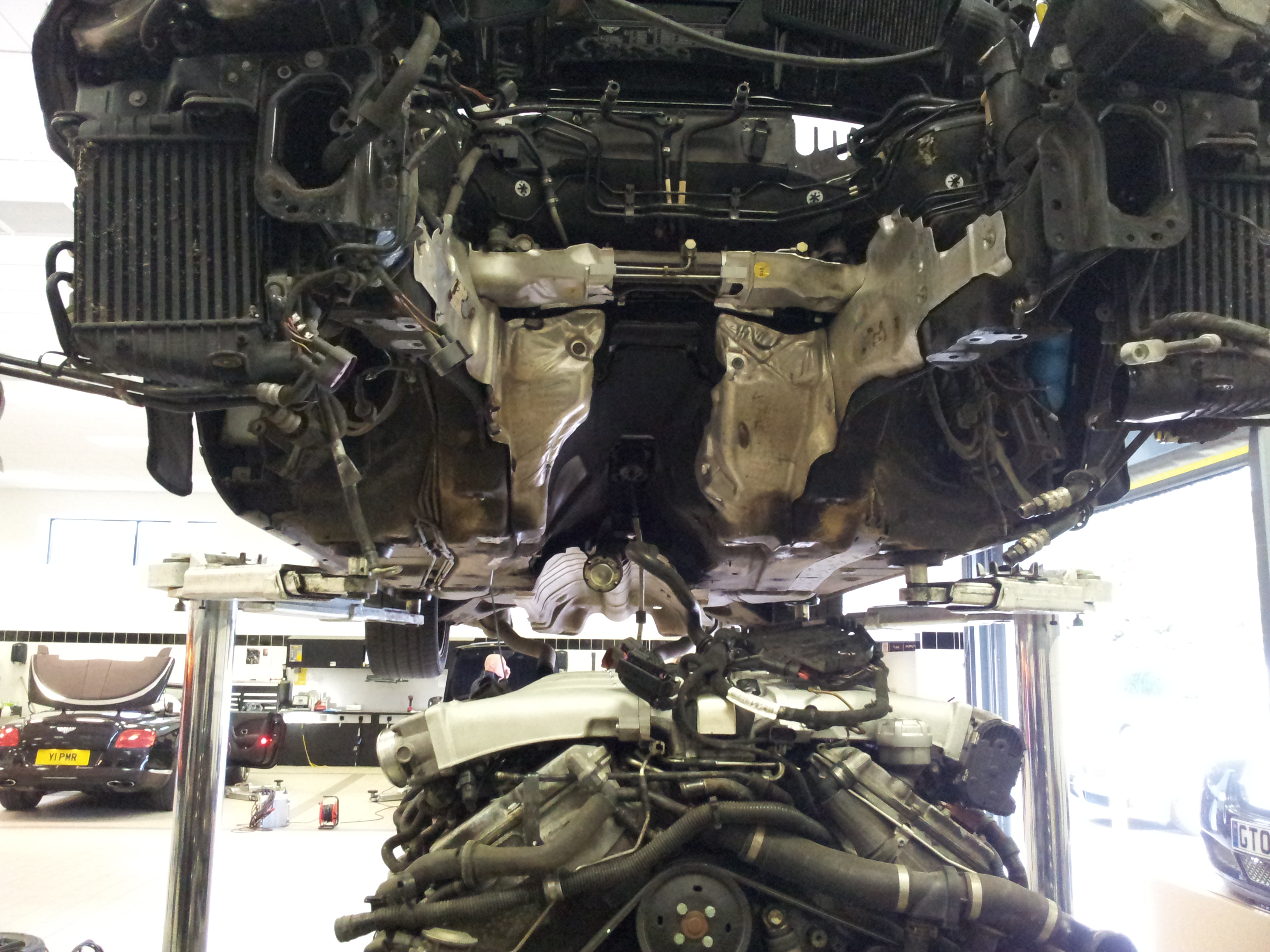

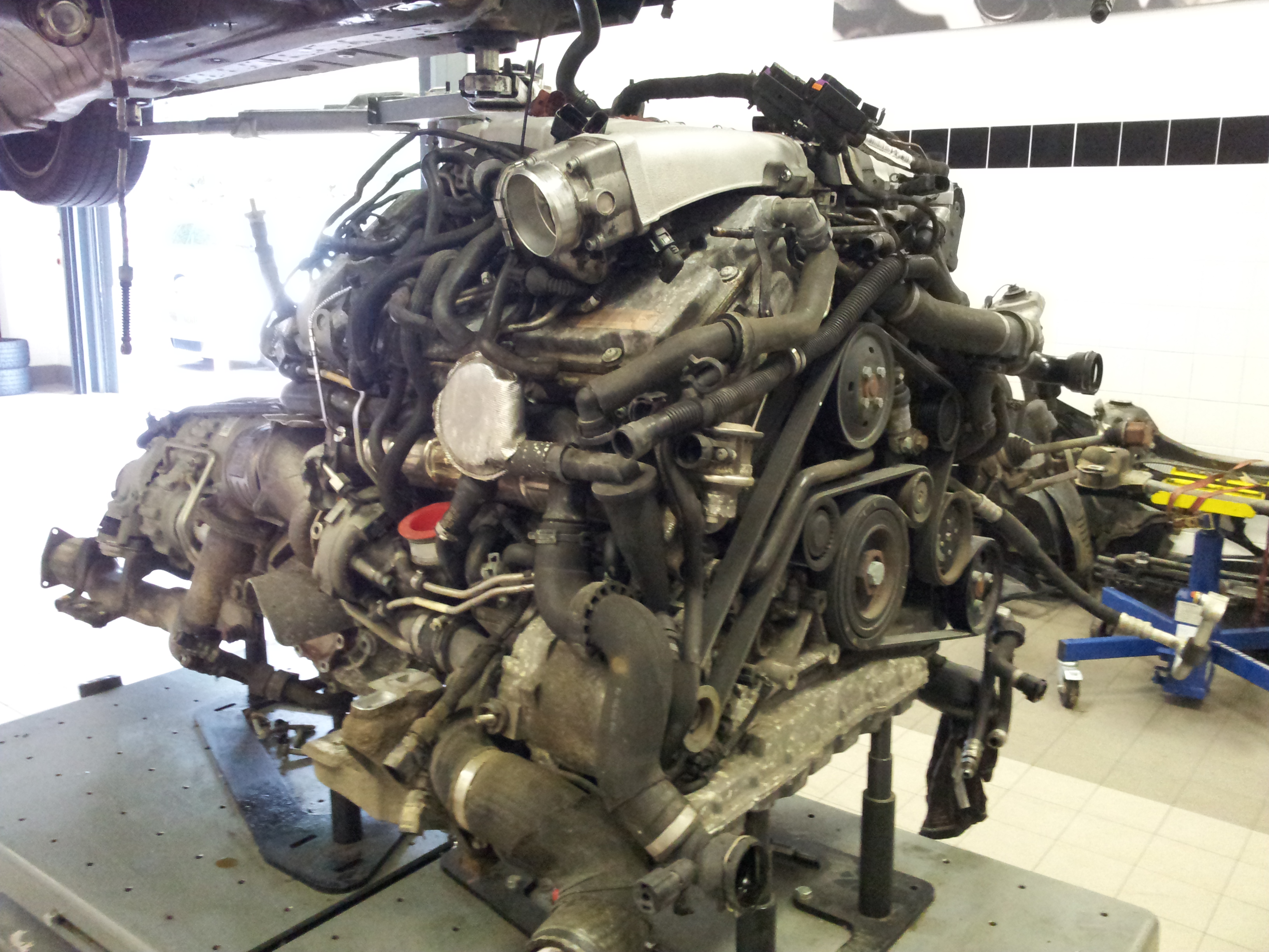

I thought I would post a couple of pics of my car whilst it's at the local main dealer workshop here in Cheshire.
It had a big service at an Indy last week and whilst there a leaking vacuum pipe was found. Unfortunately the Indy needed the car for a week to do an engine out job. There is no courtesy car there and for the life of me I couldn't source a hire car.
So, on the insistence of my other half, I booked it into the main dealer who wants it for 3 days.
The engine/trans are out and the front of the car is off, along with the front suspension.
Surprisingly, the usual vac pipe to fail was ok but brittle, that was changed as a precaution. The pipe causing the problem was just on top of the gearbox casing and had a 1" split. Another adjacent vac pipe had completely come off the metal tube it was supposed to be attached to.
Whilst it is out, the engine has also had one new exhaust gas sensor and a new auxiliary pulley belt.
It will be an expensive few days but at least my car should run a bit stronger and hopefully last another 10 years or more.

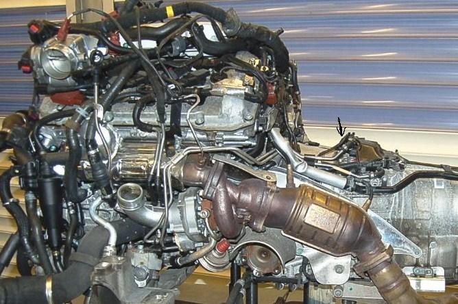

Here is another picture. The Vac' pipes are the ones on top of the gearbox with the black arrow.
Les.

Thanks for the pic, I was hoping to see the pipe itself. Still blown away by that!
